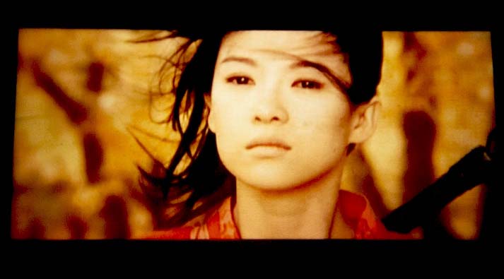

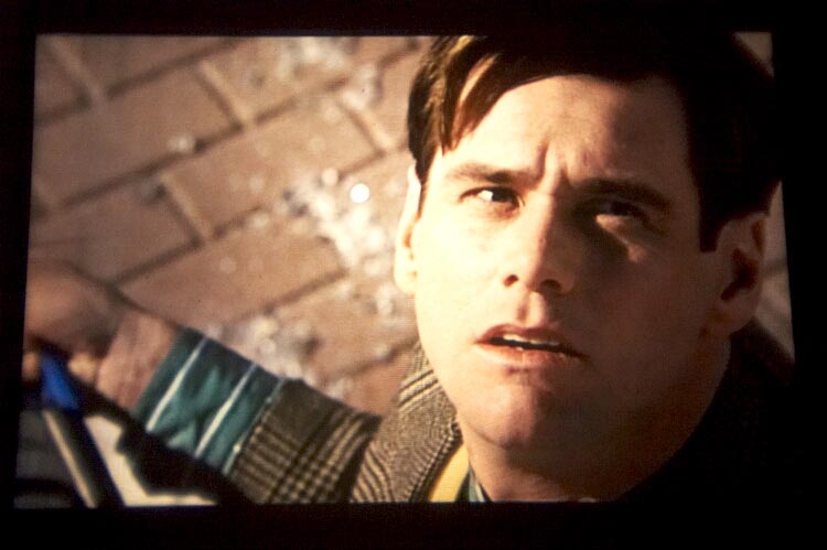

Today I will do the first run of my projector after installing the LCD screen. I believe it will require lots of tweaking to get good image. I'll post some pics once I have achieved a watachble image.
