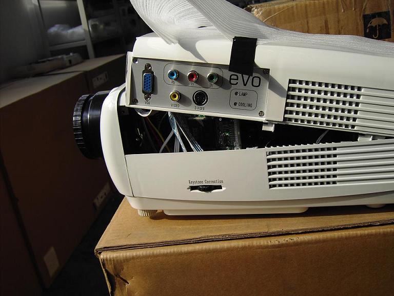

Re: More pic of one projector
Hello.... go thru the forums over the net, and U'll know how worthless is the eVo. Needless to say, only a DIYer can know the satisfaction one feels on building his own projector.
vodkajin said:now, such diy projector can be easily found in US and China.
THis is waht I find from Lumenlab. This premade projector has a perfect image, and I got it at a not-too-expensive cost.
