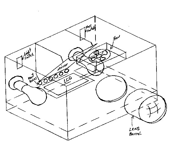

that projector sounds REALLY powerful...if only there was a way to harnest all that power.im sure with the proper bulbs and a bit of creativity,you can make a portable and BETTER lighted projector than with OHPs.(im not sure if LIGHTED is a word...lol) do u know the retail for your projector? thanx.

very doubtfull..
negative ,
i saw that picture one of the first when i was planning to make the DIY-projector. And had doubts then, especialy with the light, how it's build up.
What i think: ..if you will mirror the laydowned lcd trough the proj.lens and two bulbs shining in the box, there will be no contrast of the lcd left and it wil be a very vague picture (if it's not just only a lightbeam), couse of a not-purposal lightning.

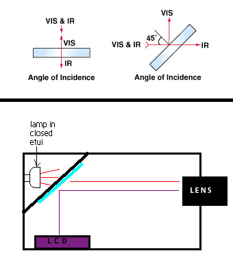

I was trying to figure out how this setup maybe could be possible and thought about cold mirrors. The light(in a closed box) behind the under 45° placed mirror on the same hight as the projectionlens is positioned.

LaserLine said:I acutally had a beseler opaque projector and see how well it projected my LCD screen on my Sharp Zaurus SL-5500 and the result was pretty bad. I'm not sure if the LCD was reflective or transmisive, but you could barely see the image on my wall.
I dont know but maybe your projector needed more light.
Dirkje, i think you have a point..but im still optimistic. do u think that maybe this wouild be possible if the design was changed, or if the bulbs we strategicly placed?
Crash, thats a good idea, i dont knwo if my LCD is transflective or reflective,i got it from partsexpress. its a TFT ...maybe thats transflective....i dont know.
but im VERY anxious to recieve my opaque projector. it STILL hasnt come in 🙁 its been 2 weeks now...do u guys think i can cancel the order? if i cancel it i will definitely go the OHP route and make a custom installation. ThanX.

sorry, i left the pic behind..
this tell maybe more than my words but even in this setup i think the pic on the wall isn't that what you'll expect, a bit disapointing i mean=>contrast will be the most problem i guess.
btw.the IR is 90% of the total lumen that comes trough the cold mirror & sorry for the louzy draft

I read that anti glare can cost more than the whole project. I dont know any reflective LCDs ....maybe you can put a mirror behind the LCD...i would like to know how your project goes, me im no longer working on opaque projectors......
