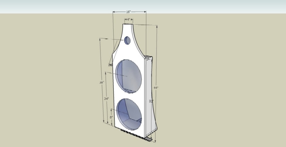

Yes, a very odd combination of quality and quantity with Fostex and Pyle Pro. As many of you know, the Pyle Pro PPA15 has become very popular as an open baffle sub driver. Decided to give it a shot, but crossed over higher. I chose two pairs instead of the goldwood 18 because of increased surface area, reduced footprint, and higher excursion capability. All for roughly the same price (Paid 130 for both pairs, check amazon for great price!).
The full range driver will be a Fostex FF85KeN, from Dave of course. He was gracious enough to sell me a cosmetically challenged pair to fit my budget as a college student. I was originally going to run them passive, but plans have changed and it will be active instead.

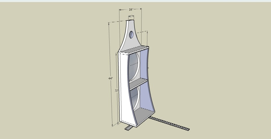

Read over MJK's open baffle papers (thank you!) and decided on a U-Baffle with short wings (4-5 inches) to push the ripple well above the crossover point. The FF85K will be crossed over at 250hz-300hz and the PPA15s will be crossed over at around 150hz to combat rising response. Both Linkwitz-Riley 12db/octave.
The top of the front baffle roughly follows the 2.2* Driver diameter rule that has been floating around here. Its about 6.75 inches wide at the centerline of the driver. The FR will be mounted higher than normal of 32 inches to 38 inches (preference). Here are my preliminary drawings. I don't think I will be changing them much. I apologize for the dimension clutter.
Any thoughts or suggestions would be appreciated. I will update this thread once the units have been built!

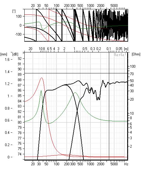

Quick simulation of this baffle (approximating the U-baffle as a larger, but similarly shaped--flat baffle) in basta using the fostex specs and some PPA15 specs on the web (FWIW) suggests:
--This design will have a 2db hole centered on ~3K and a 3dB peak centered on ~1.5K.
--Extension--without EQ--will be to about 65hz at 3db down.
--Should be Smooth through crossover region (1db dip) --> though this does not include any floor bounce issues in the fostexes output just above XO
--About 6W power handling before the FF85 runs out of excursion at 200hz (PPA15 are only pushing 2.5mm at 20hz)
IMHO, The ripple at 1.5K, if not eq'ed, will be even worse if the rear reflection off the back wall is undamped.
The crossover point appears poorly chosen regarding maximum volume output, a single PPA15 per side would suffice, distortion at in the midrange 300hz-1K will be bad at volumes where the woofers are limping along.
325hz on the fostex and 200 on the woofers doubles the power-handling of the Fostex, but changes un-equed extension to ~75hz. Should be able to eq, reasonably flat to about 30hz if you use a 150w amp on the bottom and 15w on the top.

seanzozo said:using the fostex specs and some PPA15 specs on the web (FWIW) suggests:
... About 6W power handling before the FF85 runs out of excursion at 200hz (PPA15 are only pushing 2.5mm at 20hz)
An interesting intellectual excercise, but the fostex data isn't that useful ... even for stock drivers -- these FF85KeN aren't stock. My sims show the uFonken show it xMax limited to 1w at 100 Hz... but playing unaided in my big room, i'm pretty sure it has a bit more than that in it. Early measures while i was developing Tysen showed no major dips (in room flat from 25 to 16k +/- 2 dB -- the simplier XO we ended up using is not as flat, but sounds better)
Personally, i think i'd be looking to have a bit more baffle to support the FF85keN as well as some assymmetry.

Wow great response! Though I agree with planet10 in that the Fostex should have more headroom when playing music.
Reason I am doing two PPA15s per side is because, frankly I am a bit of a bass head and want to have the headroom.
Regarding te peak at 1.5K, what would you suggest I do? Add damping directly behind the baffle or a diffuser of some sort behind the driver on the back wall?
I will follow your advice on the crossover point though. I have the option to adjust the crossover point all the way up to 400hz for both the woofer and FR, so I can play around with it a lot.
As far as EQ, I will probably only use minimal EQ at the very lowest octaves.
To Dave, what do you suggest on baffle width? I don't want to go too wide, so I am thinking 8 inches wide and change the baffle geometry.

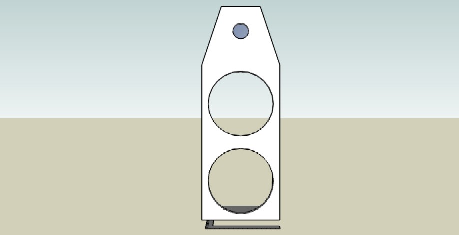

Ill get a modified baffle design done sometime tonight. Yes, I love headroom in the bass region. My pet peeves with loudspeakers is running out of headroom in the bass region when I try to crank it up 🙂 Granted, these ill not be played very loud. Been there done that with line arrays
I changed the dimensions a bit. I played with edge, roughly replicating the listening distance and width to get a ball park figure.
I increased the top edge to 8 inches from 4, and I removed the extreme curvature. I also moved the driver 1 inch up to be slightly offset from the center. The result is a response that closely resembles a rectangular baffle 8 inches with the same height. See attached image.
I still may add some curvature, but it will be very minimal compared to the original rendition. Again, I will raise the crossover point to 300hz+ for the FR.
Any more thoughts? I am usually not the one to spend too much time in the developing stages. I like to build 🙂 So unless there is something vital I am missing other than the above mentioned, looks like the design is mostly finalized.

Ok 🙂 I can definitely go wider on the baffle. I guess up to 24 inches at the widest point (currently its 16 as shown for the woofers)seanzozo said:I still think you need to offset the driver to the left or right and the baffle may not be wide enough, I'll sim it tonight with daves new numbers (they don't change much, when there are no XO components).

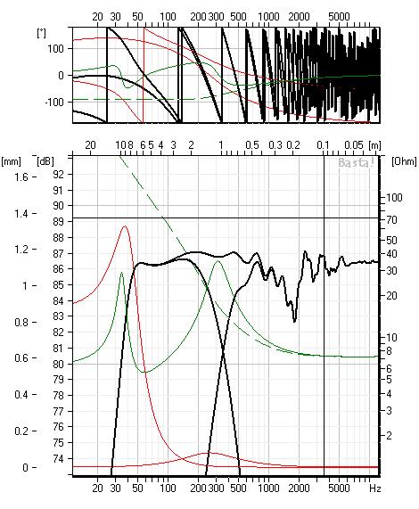

With regard to fast-ones baffle. I suggest this as a starting point: a 20 inch x 42 inch baffle with 4 inch wings on the back.
The fostex sims best about 4 inches from the top and about 8 inches from the side
-- there is a very hi-Q 2db notch in the sim at 3K but otherwise it is +/- 1db from 100hz to 20K (with perfect drivers)
-- the bass rolls off at -3db at ~75hz
Why did I choose this size? In part it is working off of a known good, the MJKOB baffle. Basically the 1.5K peak in your original design has been pushed down (by widening the baffle) and spread out (by offsetting the driver) to the 400-800hz area so that it can be EQed-out by choosing an electronic XO point that is slightly higher than the intended acoustical XO.
Suggested starting points for the XO are 200hz and 425hz - acoustic XO should be around 320hz.
Caveats -
1) This sim does not include the floor or back wall. This means that real-world extension may be different (one kludge I used, mirroring the baffle suggests 3db extension might be up to 15hz lower than the basic sim, but in reality this will tend to be offset in part by the lack of a back wall in the sim). It also means that any nulling due to floor reflections is not included.
2) The parameters for the woofers are unverified.
3) The sim also approximated the wings as flat baffle extensions for the woofer, this probably understates their effect somewhat.
In all likelihood this baffle will work, being square it should be pretty easy to throw together cheaply and quickly. Bass extension will be moderate.
With regard to an FF85K/Alpha15 passive OB based on the MJKOB 20 inch x 38 inch baffle with driver placement as per his PDF
A first pass of XO components:
24uF and 3mh on the FF85K
10mH and 100uF on the Alpha 15
Use of the original parts (24uF+4mh and 9mH+68uF) results in a simulated 2db shelf up in the XO region (200-5550hz) because in the sim the FF85K tracks tighter phase with the woofer than the FE and FX series drivers. Acoustic XO looks to be about 340hz, a slightly lower XO than in my own FX120/Alpha15 baffle.
