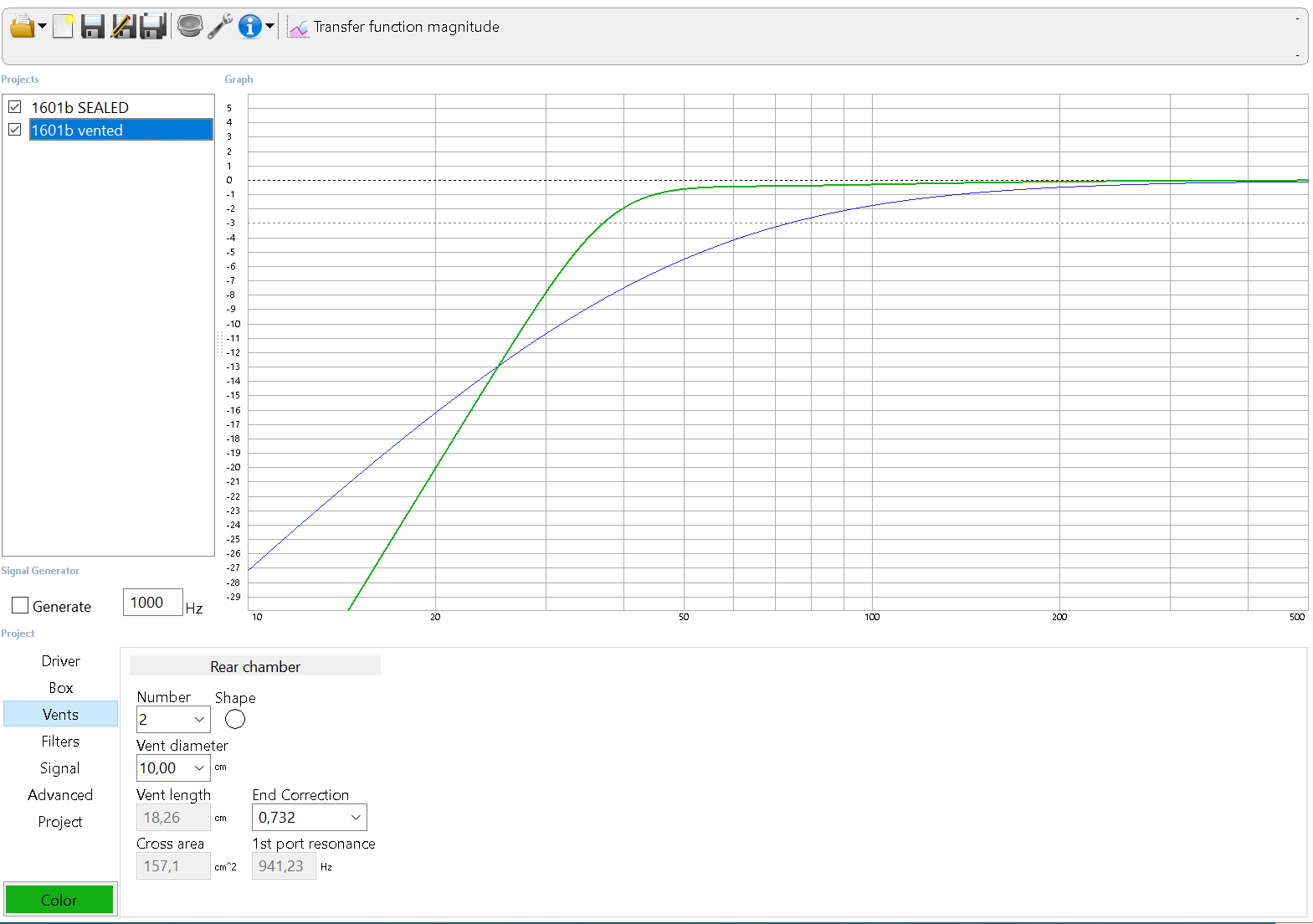

May I know why are you suggesting sealed?
This is my 1st time using WinISD, I watch youtube how to do it. Hopefully it is correct.
Green is vented 150L @ 35 freq, blue is sealed @ 211L.
So based on this, vented is much better. I want the most neutral freq response.

Amazing how people does not want to share here!!!
I found the answer anyway. 170L @ 35hz is good if u want to go low.
If you have a sub 125L @ 37hz is good, cut off at 60hz. All vented.
