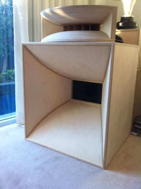

Hi there: Your project looks exceptional, any details about design and construction, drivers? How does it sound? Do you plan measurements? Sure that others will be interested too. ...regards, Michael

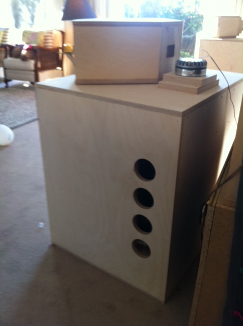

Hi, for those interested. No measurements needed. The cabinets are as original design, extra bracing and the corners are inlaid with solid walnut.

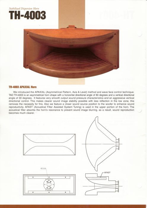

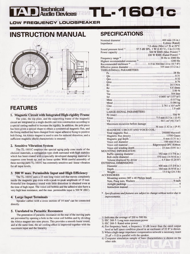

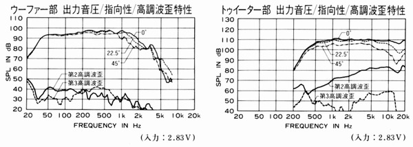

I studied this design in depth, and I'll share some details here for the benefit of whoever might be interested.

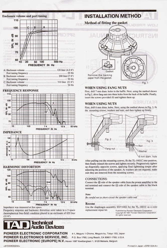

- the woofer updated to its latest incarnation (model TL-1601c), which sported a sinlge-piece frame and improved ventilation and power handling (see spec-sheet in attachment);

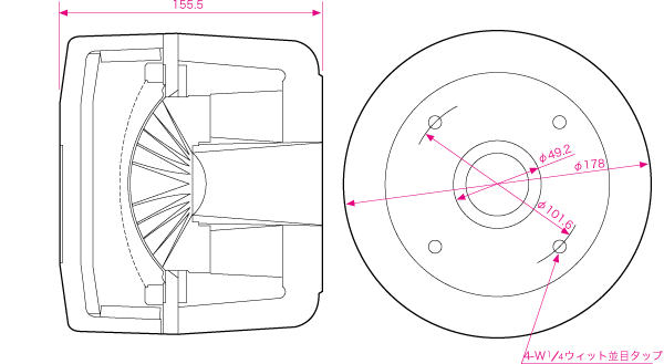

- the compression driver replaced by model TD-4003, which featured a redesigned phase plug for even better linearity in the top octaves, and a 1.5" (instead of 2") exit, in order to improve dispersion of those same highest frequencies, which enabled Pioneer to forego the use of vanes in the first section of the horn (see below). It is worth noting that the TD-4003, however, was not a rapid-flare "throatless" design like the contemporary JBLs, but retained an internal slow flare rate in order to still be able to be comfortably crossed over at the same low 650Hz frequency;
- the horn replaced by a completely new design (TH-4003, see attachment). This was still fundamentally a slow-flare radial hypex horn, carved out of a dense block of Itaya Maple, but it featured asymmetrical upper and lower "lips" (APAXIAL design), and a tuned duct (named "AFAST") in the upper lip acting as a Helmotz resonator and "trapping" the last tiny remains of unwanted resonances. Also, unlike the earlier TH-4001, it no longer needed internal vanes to achieve the target dispersion up to 10kHz.

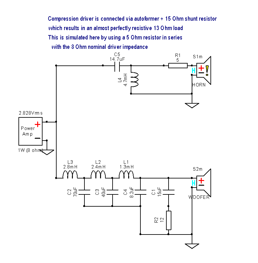

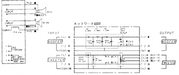

But the jewel in the crown of these loudspeaker systems was arguably their passive crossover (see attachment): this was a very clever asymmetrical design featuring:
- a 6th order Linkwitz-Riley low-pass filter on the woofer branch, and
- a 2nd order electrical high-pass filter on the compression driver branch.
When combined with the natural high-pass response of the driver+horn, and with the compression driver's acoustic centre set back from the woofer's as is the case when the horn is mounted to the loudspeaker enclosure, this crossover results in a flat frequency response AND a perfect overlap of the acoustic phase traces of the woofer and the driver+horn in a wide frequency range around the crossover frequency.
Also, the group delay induced by the steep low-pass filter on the woofer essentially re-aligned in time its emission with that of the compression driver, resulting in an overall flatter group delay curve.
And, finally, the same steep LP also did away with any residual "nasties" at the top of the woofer's operating range.
Several birds with one stone - very clever indeed.

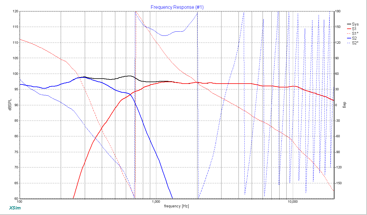

For kicks, I have simulated the crossover using X-Sim - see attachments.
(please note: in the real 2404 system, the compression driver is attenuated using an autoformer + shunt resistor, which results in an almost perfectly resistive 13 Ohm load; since X-Sim does not permit the simulation of autoformers, I simulated this using a 5 Ohm resistor in series with its "default" flat 8 Ohm impedance for the compression driver, which gives the exact same 13 Ohm load)

That looks fantastic . I’ve heard nothing but good things about the 950 with the 5 split phase plug . A design feature from the 4003.
... Yuichi 290 horn, and Radian beryllium 950 drivers...

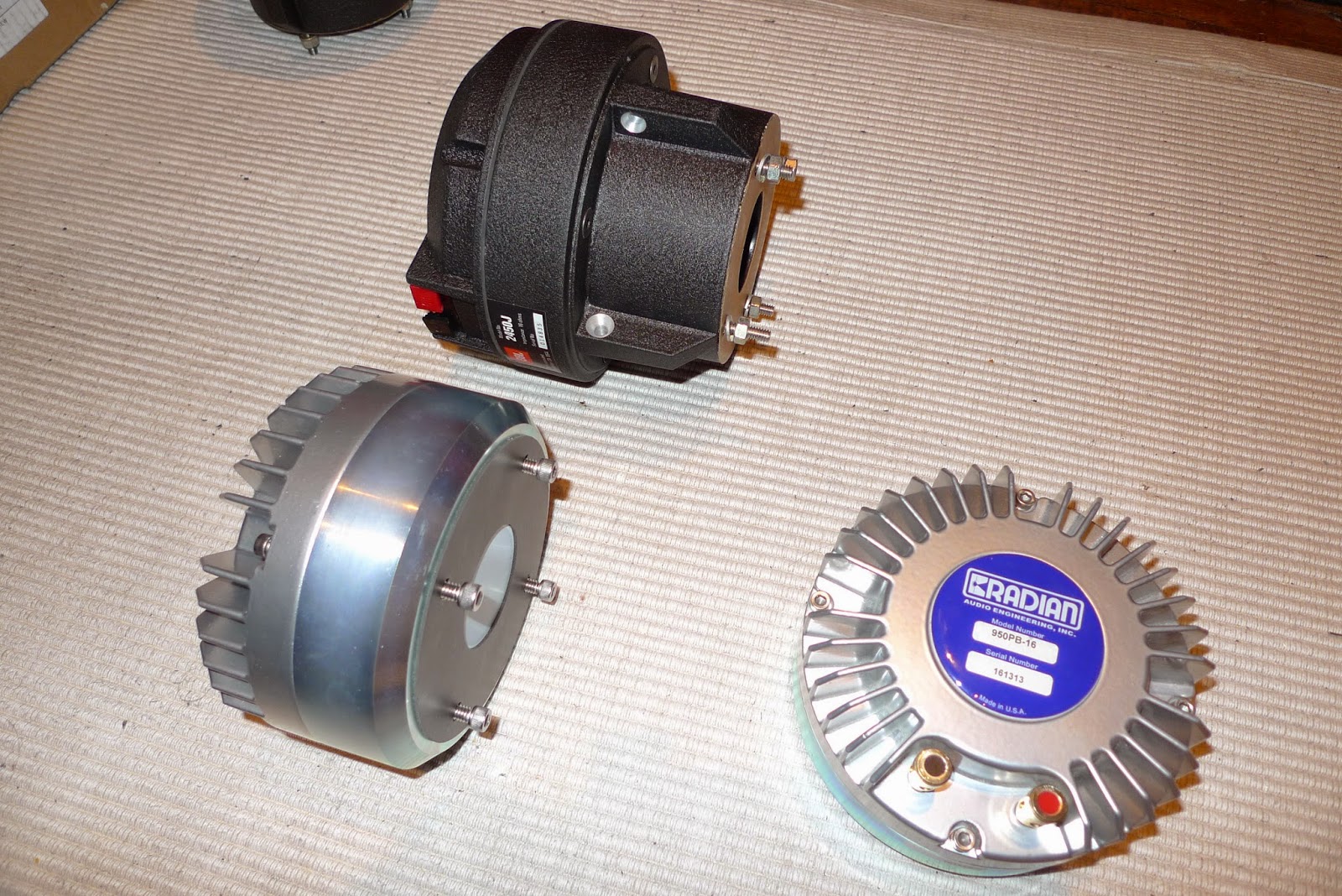

Great components per se, but possibly not an ideal match to one another. Let me elaborate a bit:
The Yuichi A290 horn is a Fc=290Hz, T=0.7 hypex, and its throat adapter is also designed to the same Fc & T parameters, and has a narrow initial expansion angle. It was designed this way to be a perfect match for the TAD TD-4001 compression driver, whose internal conical throat is characterised by a 10º exit angle, and its dimensions (depth, initial area and exit area) are a perfect fit to a Fc=290Hz, T=0.7 hypex expansion.
TAD TD-4001 internal structure:
Incidentally, the JBL 2450 is also 100% compatible, since it has the exact same throat geometry and exit angle (10º total).
The Radian 950PB driver, instead, is a more modern "rapid-flare" design, with all the pro's (wider dispersion > 7kHz, IF mated to an equally rapid-flare "waveguide") and con's (worse loading < 800Hz) that that entails. In particular, its very short internal throat has a much wider exit angle of approximately 20º total (10º per side), and its dimensions would lead to a much higher equivalent Fc.
Radian 950PB vs. JBL 2450: (notice the JBL's deeper "snout", which houses the longer and more narrow internal throat)
[see also: here]
So, bolting the Radian driver on to the Yuichi A290 horn will create a sharp mismatch at the delicate driver-to-throat adapter junction, which is not ideal.
I'm sure it will probably still sound (very) good overall... but my point is simply that one cannot just mix-'n'-match drivers and horns willy-nilly and expect the two to work seamlessly together.
