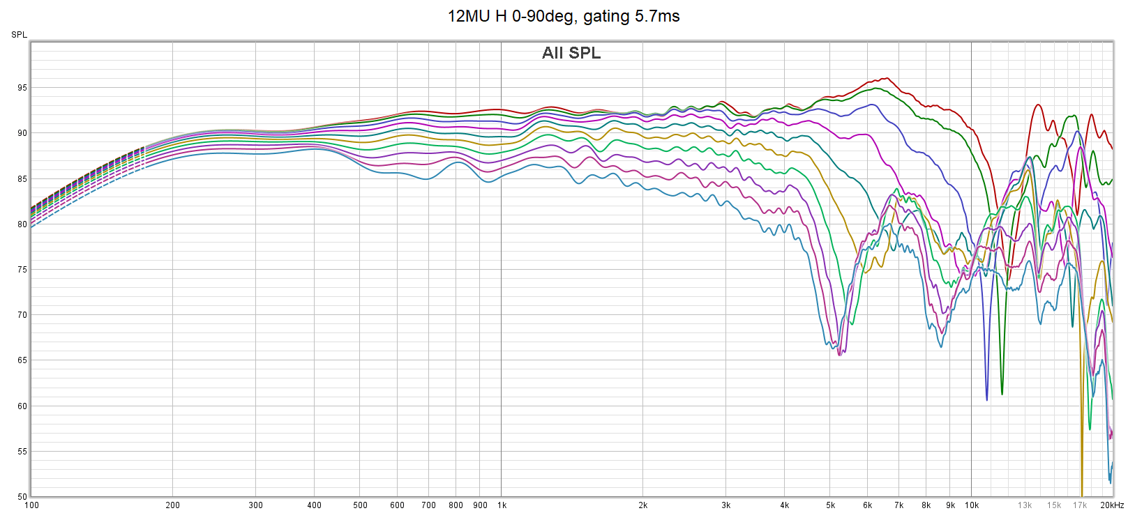

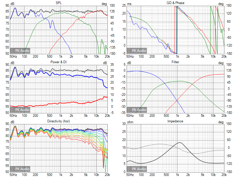

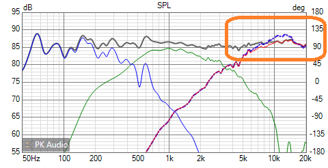

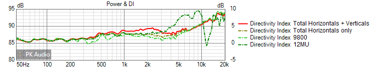

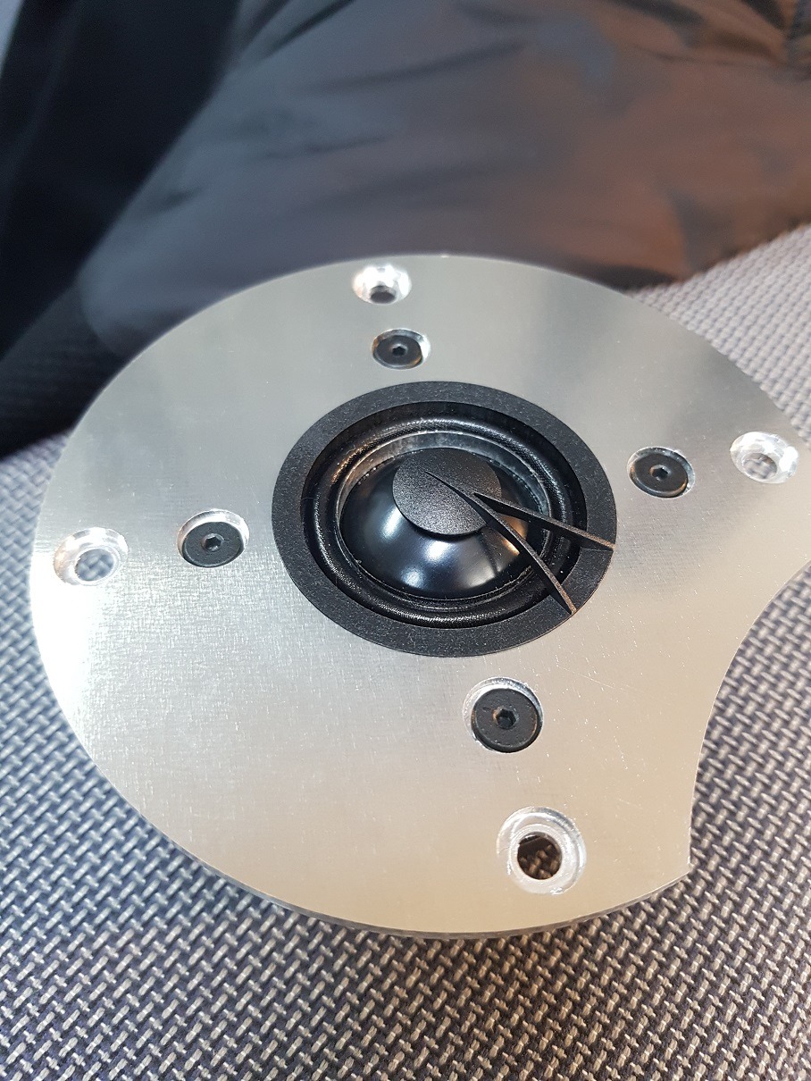

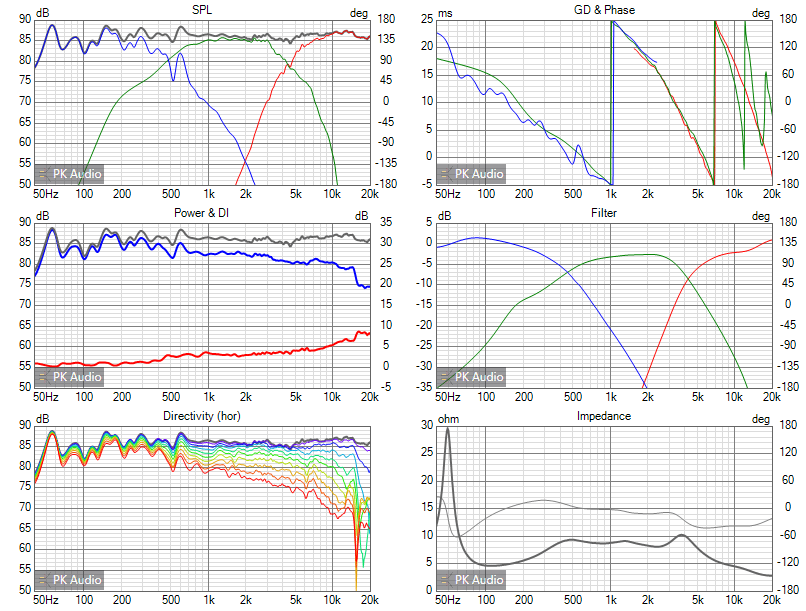

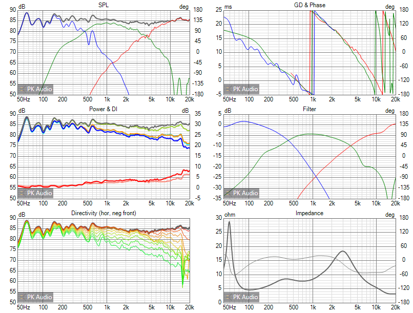

Following image shows DIs of midrange and tweeter individually, total DI of the speaker with the crossover when only Horizontal responses are factored in, and total DI of the speaker with the crossover when Horizontal and also Vertical responses are factored in. General consensus says DIs of both should match at crossover frequency, ideally (this is often the case of midrange and tweeter+WG). Well, yes.... but here we have tilted front baffle, well behaved drivers with extended responses below and above Fc, and there are no sudden directivity changes around Fc of both midrange and tweeter.
This is the case where crossover topologies with shallow slopes come into play and offer good solution. Considering crossover frequency ~3kHz, LR2 crossover helps to blend these two different directivity sources.

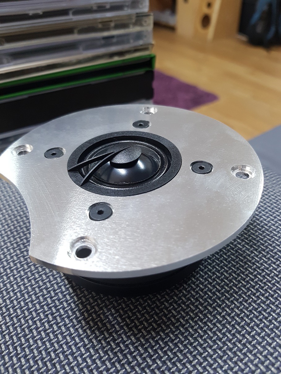

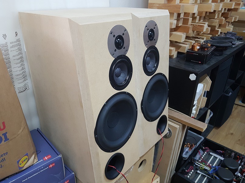

I am yet to assemble the crossover and start listening tests. With 21W+6600+WG 2way I spent quite some time, and also few hifi friends had a change to listen.
2way: 21W is excellent bass driver, midrange is warmer and somewhat laid back, which makes it easy to listen, it is relaxing, but also less articulate and clear or transparent. I attribute this to the cone material, as I heard the same same characteristics in 18W/8545K as well. I can imagine that versions with woven cone or poly sounded more transparent in the midrange but regretfully they are not available anymore. WG provided seamless matching of tweeter to woofer and in that regard I liked it a lot. So 8" + WG concept works great and I just wish to find 8" capable of good bass (going sufficiently low as I do not use subs) and transparent midrange. There were some threads dedicated to this....
3way: the main reason for this project was to find the application where 21W would be like fish in the water => woofer duty only. I had 12MU around and knowing this midrange I felt these two could work together well. 9800 got to my hands from hifi friend with the full recommendation, and as I started to like hard dome tweeters I wanted to find something between ultimate tweeters like bliesma/satori and so so sounding DXT etc. Allegedly 9800 sounds nothing like alu yet it has the qualities of good hard domes tweeters. Hmm I will hear soon.

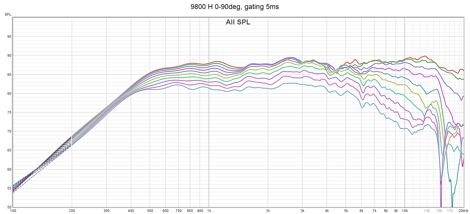

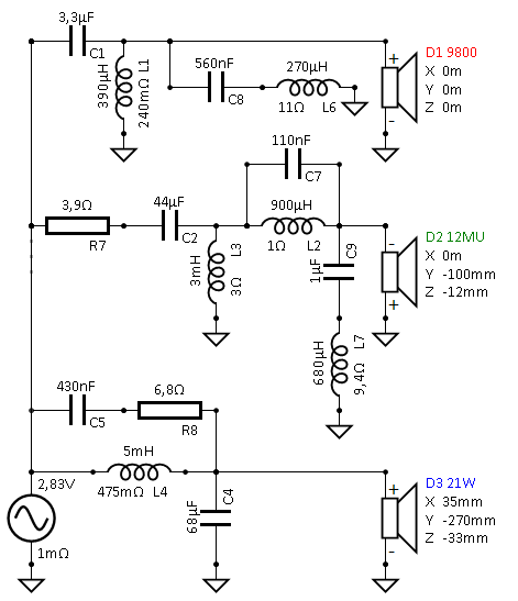

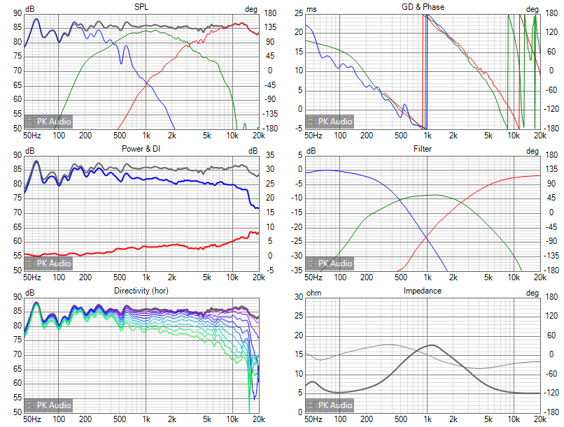

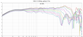

CAbinets are out for the veneering, so I have a time to play in Vituix, here is version with LR4 crossover for midrange-tweeter, it took just two additional crossover components to realize this.
Note excellent off axis responses, reminding solution with WG, and smoothly rising DI.

What happen with the impedance which decrease above 10kHz ? You add a parallel ultrasonic RLC ? In series you could have better results, but change in the phase, may be need to be recalculate the crossover. Perhaps -1dB on the tweeter could give you a more natural sound.Note excellent off axis responses, reminding solution with WG, and smoothly rising DI.
W22N003 looks definitely good and suitable for 2way. Sica as well, as budget alternative.
The impedance above 10k is the result of the series RLC in paralle to the tweeter. It makes the trebles nicely linear. I am going to experiemnt with the values again, when cabinets are veneered. Initial crossover version had trebles little bit lower in the level, all details were there, it jsut could have been more brighter at the top end, so I will try to increase it a bit. This is something that usually takes a time, few iterations, to find the optimum.

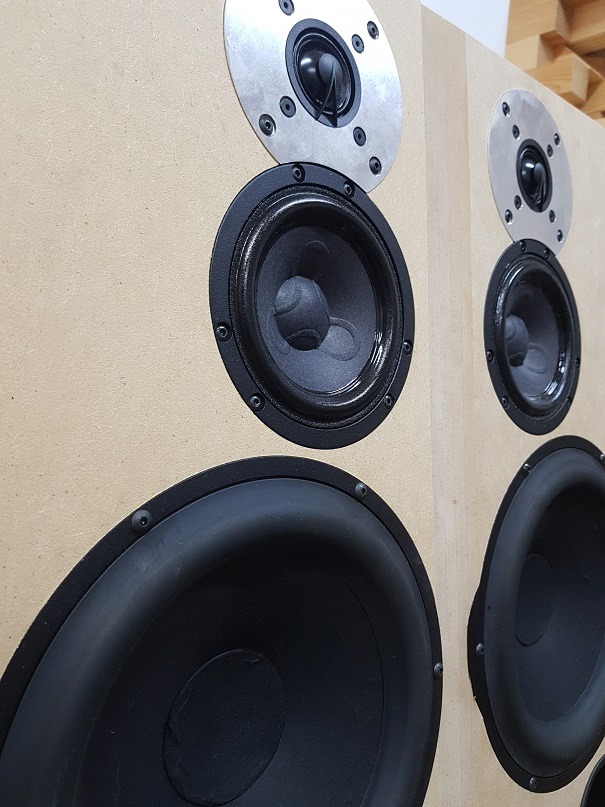

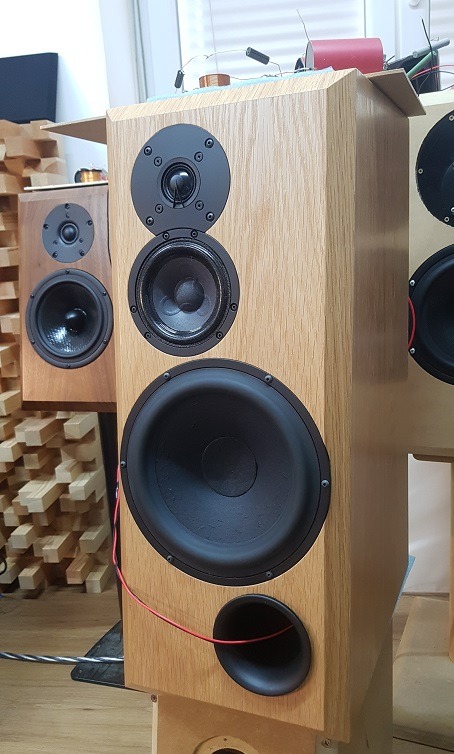

So the cabinets arrived back from the carpenter, this time with the final veneer. I installed the drivers and connected the drossover, which is still external to allow minor adjustments. The current version is in the attachment. With each listening session I like the sound more and more. 21W in 33l does very good job and stands the reputation of scan speak woofers, but 12MU and 9800 are what really shines and I like them a lot. All drivers are well merged and sound as one. I know 12MU from my previous projects yet I am still amazed by its sound. 9800 was new here for me, so it took me some time to find the right balance. It does not have the briliance of Bliesma Be but I cannot say I would miss anything, it just sounds right, it is the first alu tweeter I am happy with. I guess Bliesma alu would be good as well, and SB26ADC sounds good, hmm I need to spend some time fine tuning this one to see if I like it or not, definitely it is good tweeter for ~50eur.
Overall, it is very easy to listen speaker, it plays all genres well (of course there are limitations given only 8" woofer), it sounds smooth yet tarnsparent and detailed.
I start considering building floorstanding version, ~40l for 21W.

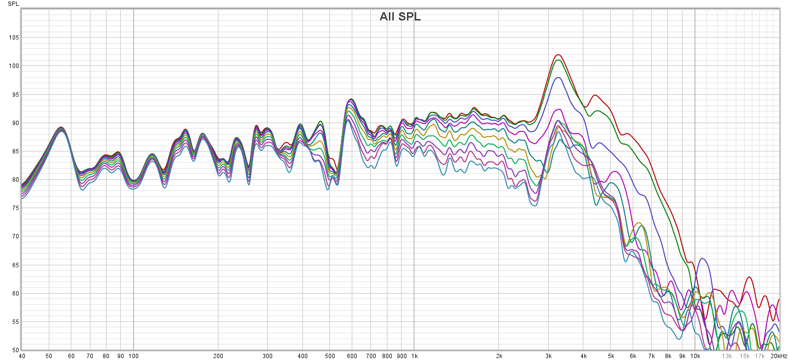

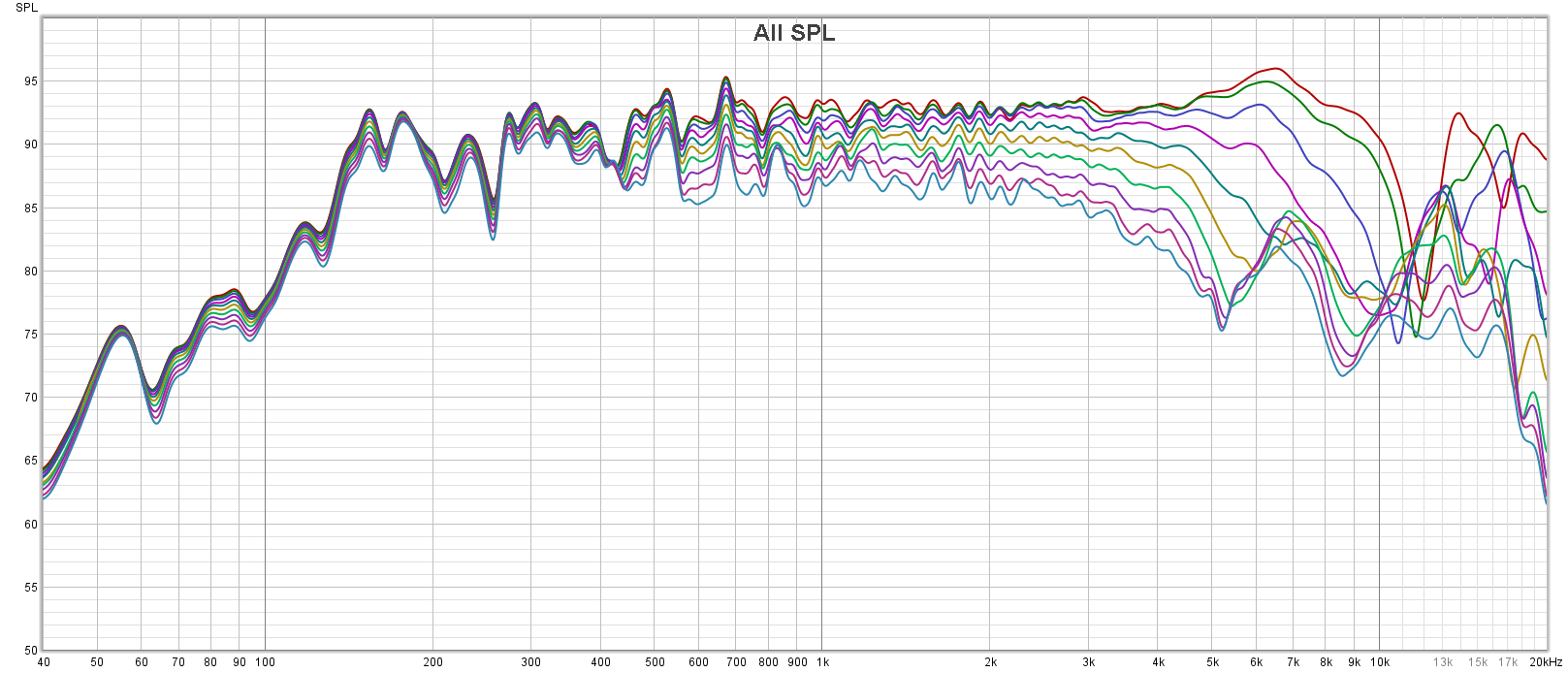

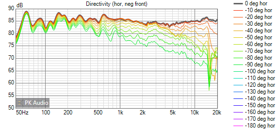

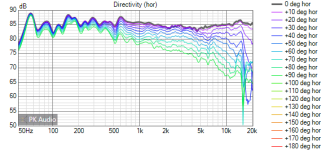

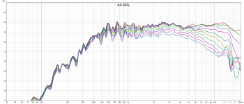

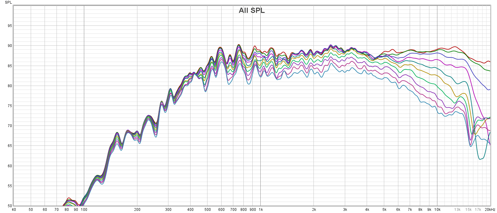

As MT are offset to the side, I measured horizontals on both, positive angles are with MT inside.
