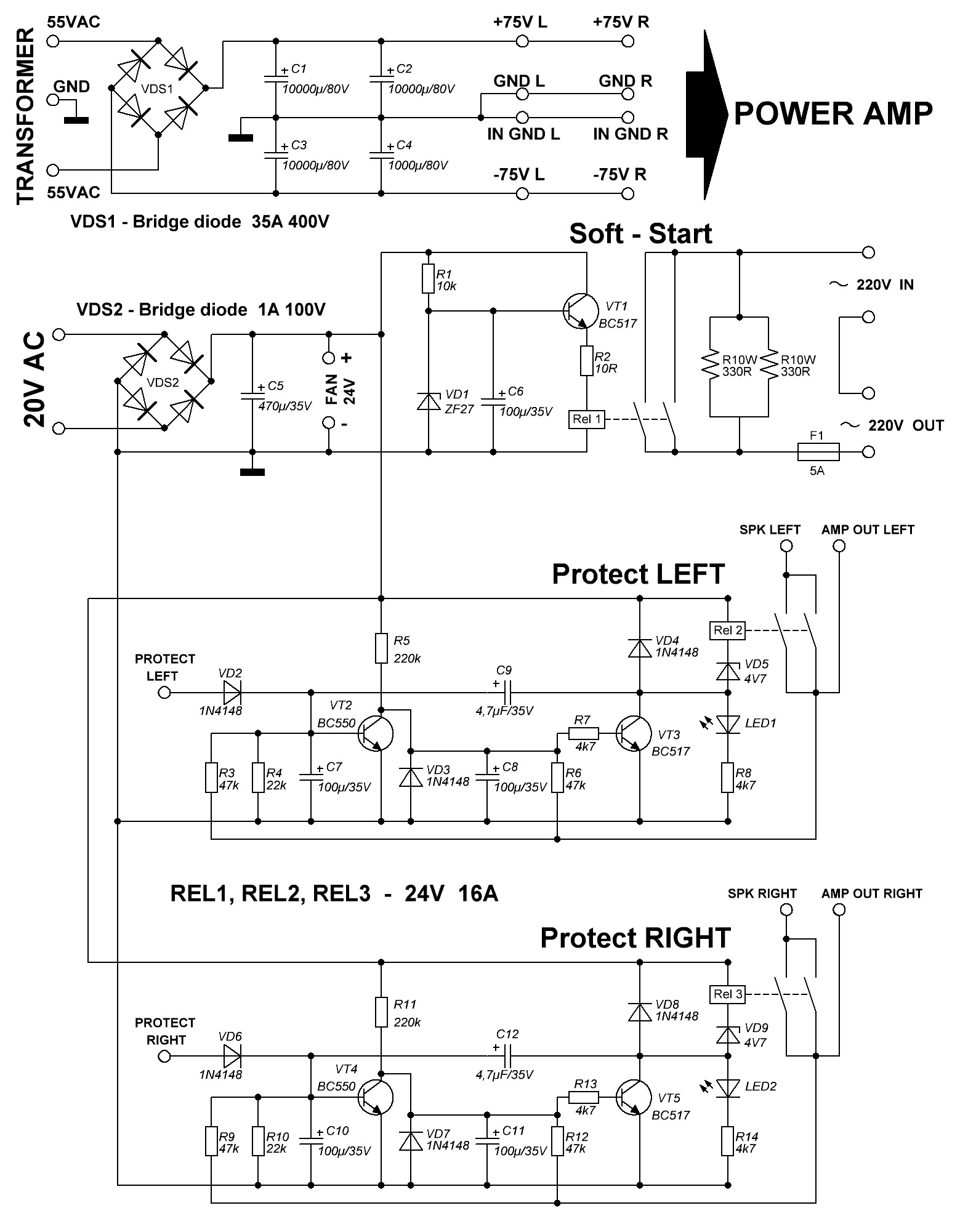

hi friends i am thinking to make a simple psu but need to have softstart and shut down pa amp electric if the dc voltage at signal output. but need to still have a power led open for the we can see there is no eror on psu. it will like a protect and show which part is broken psu or amp board
i just dont know how to make soft start for transformer. can any one put a working schematic.
thank you...

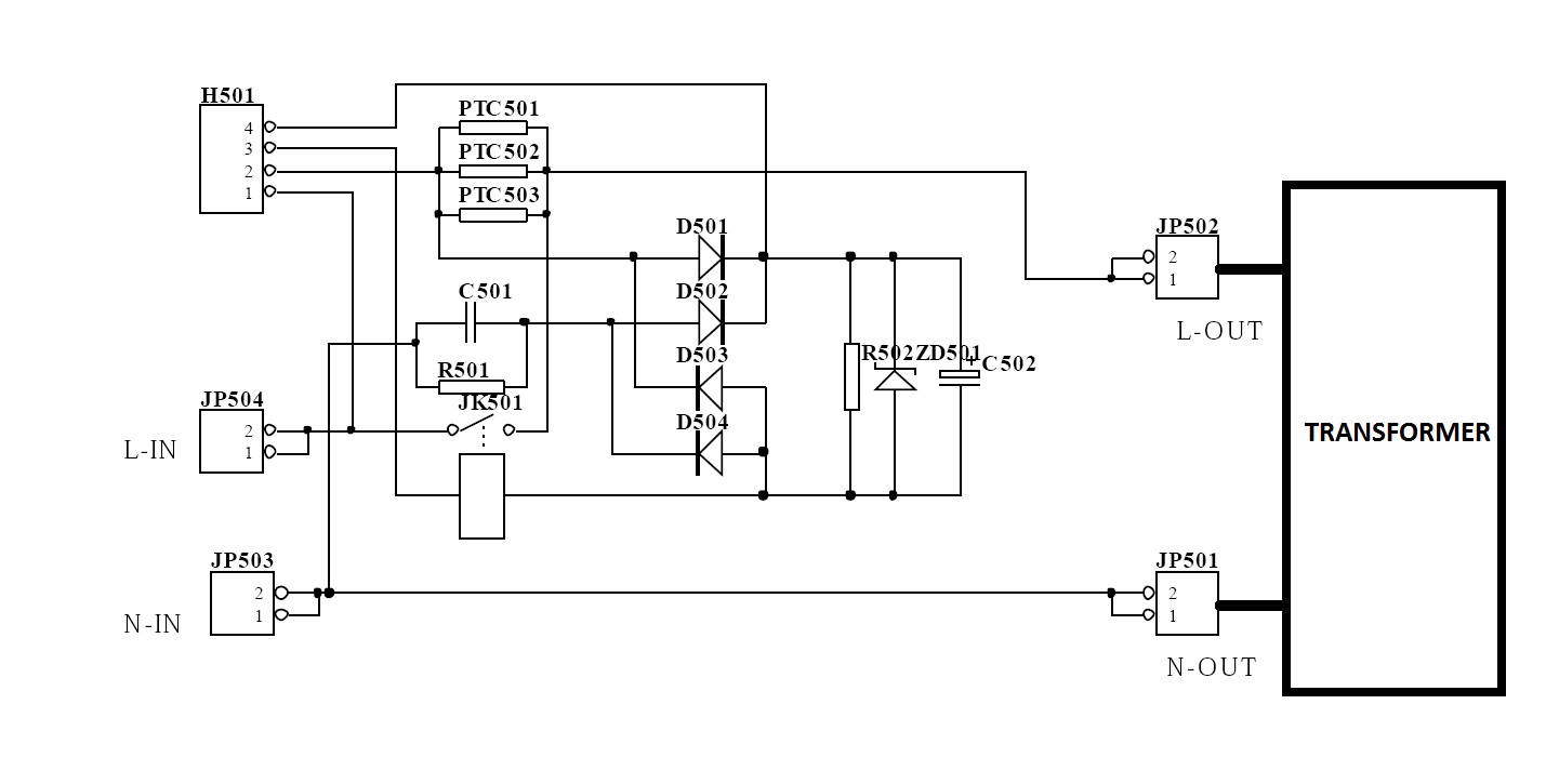

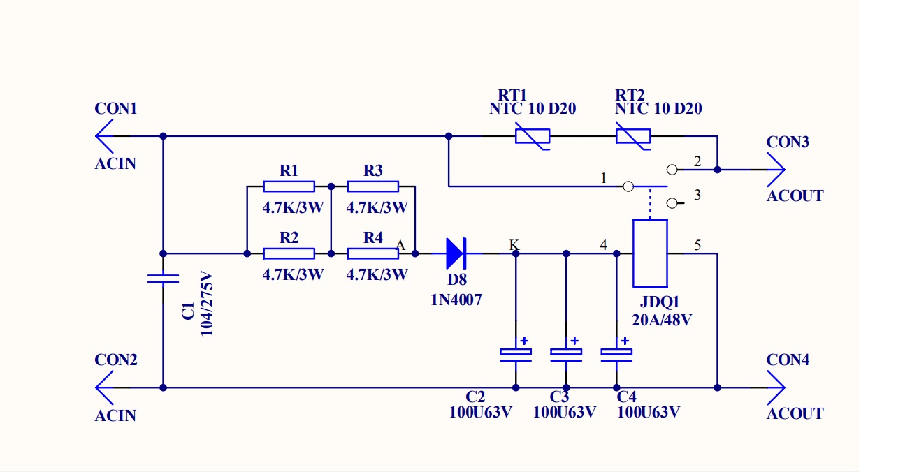

here i find 3 different softstart. i just wna to understand how it work.
their resistor values changing for the different amplifier vac or for the currents?
and 3th picture from apex psu. this is different it need voltage there 20vac. do i need 20vac from transformer secondery?
