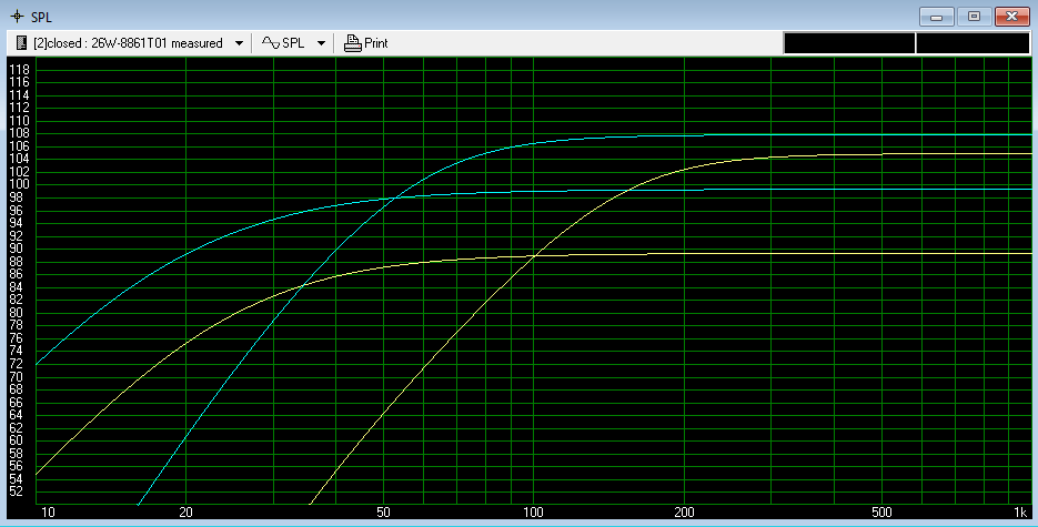

Well a bit more modelling has helped make some decisions - picture of max/peak spl hopefully attached.
Which seems great to me, for small rooms, larger rooms and then bigger rooms or THX levels. In fact the 3-way even without a subwoofer looks more than fine to me for my music requirements, especially as this'll be a tri-amped active crossover setup, which has an easier job than a single amp. So, whilst I'll allow for a subwoofer in the design, I probably won't make one for quite some time, if ever.

# At a modest scale.. the 15w as the only bass driver (lower yellow line) seems good in 6L combined with a linkwitz transform. It is limited by its linear excursion. This would be the expectations for a small 2-way setup in small rooms.
# Then.. if the 26w bass driver were also employed in an additional 20L cabinet combined with a linkwitz transform (the lower blue line) to make it a 3-way, I get a little bit more bass extension but a lot greater spl available; again limited by the linear excursion. [The 15w driver crossed over at 150hz (or more) has no problem matching the 26w's spl (upper yellow line)]. This would be the expectation for a 3-way setup.
# Then.. if some future subwoofer were employed and the 26w crossed over at 60hz (upper blue line) lots more spl becomes available - but this time limited mainly by my amplifier's peak power. However the 15w is less sensitive, so that will dictate the maximum SPL of the system as a whole (upper yellow line). In theory my amp (esp P101 with a 2x 40Vac transformer) will peak at 150w so the results of that are shown. Though such is the law of diminishing returns that even if the amp only reached 100w the spl would only lose a couple of dB.

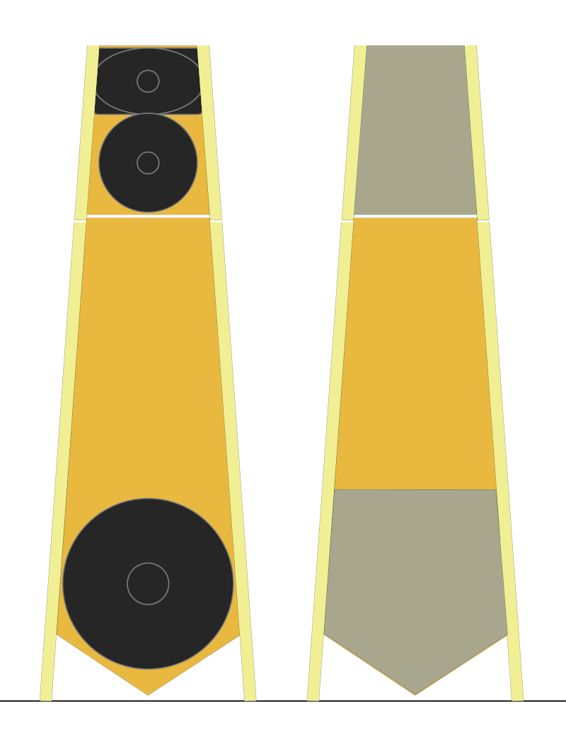

Just working on various shapes and sizes that could be employd to give the cabinet volumes needed. I'm currently heading towards this kind of thing:
So, it does seem that with a mixture of electronics and cabinet design the drivers can be wrestled into speakers of fairly modest size and reasonable aesthetics. Thats great news; I have never been very excited by the rather boring (if practical) boxes that I've made before, and so wanted something a little different this time.
Basically, a small 2-way that can be sat on top the 26W's bass cabinets if/when there is room for 3-way floor standers, which would then be about 1m tall in total. The sides are in lighter-coloured timber to act as a slight optical illusion, making them look narrower (the 2-ways look somewhat more squat and boxy otherwise).
I've seen the pointy-bottom idea somewhere on this forum before and really liked it; it seems to add a bit of elegance and lightness to an otherwise quite solid looking pyramidal shape. Wish I could find the thread to give credit, but if that was you then thanks!
I intend to have fabric covers on permanently, once finished, and might well use felt behind them to alter edge diffraction (since large round-overs would need extra baffle width). In fact I might design the front baffles accordingly, to avoid needing an extra frame for the fabric and the diffraction that these tend to cause.
The tweeter and midwoofer could be inverted, since the waveguide is quite wide. However I like the midwoofer at the bottom as it is then less equidistant from the vertical and horizontal edges, so will probably keep the tweeter on top - and maybe re-form the waveguide slightly to make it narrower.
The whole thing may only need to be about 8" deep which will suit small rooms and (if necessary) modestly sized shelves and window-sills etc. for the 2-way.
