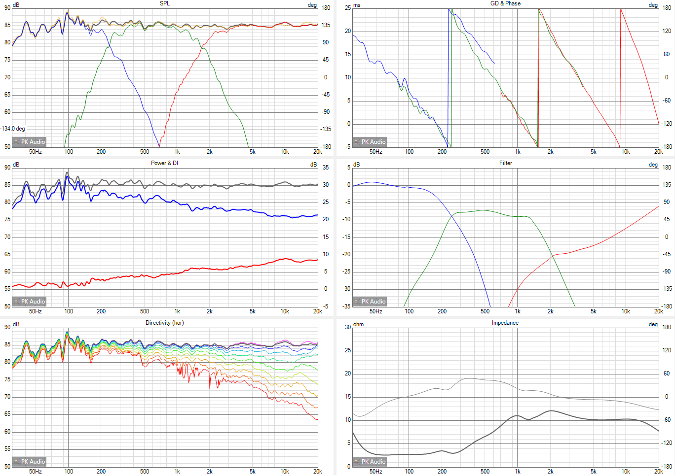

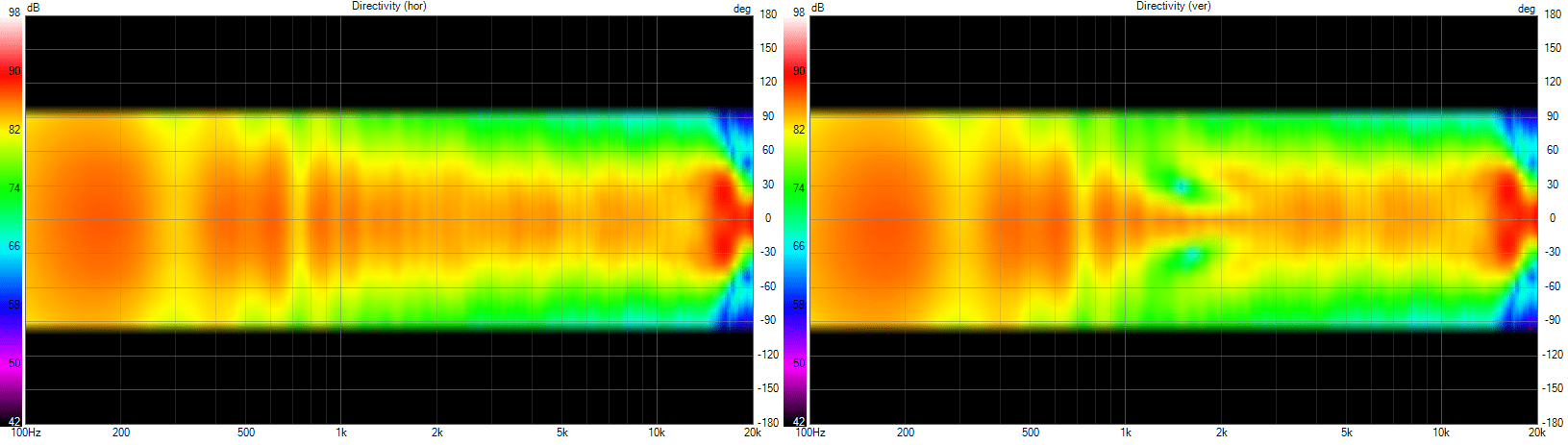

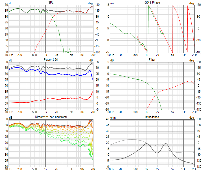

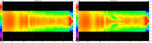

Either that or diffraction (and sometimes combination of both).Cone edge resonance I assume. Wavecors had the dip lower, around 400Hz.
Luckily it's a dip, so they are hard to detect.
Pretty nice directivity btw.

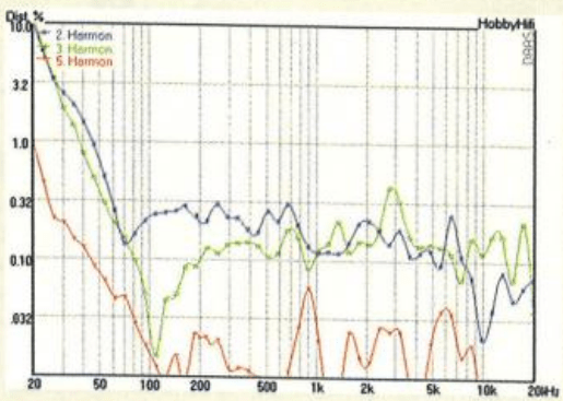

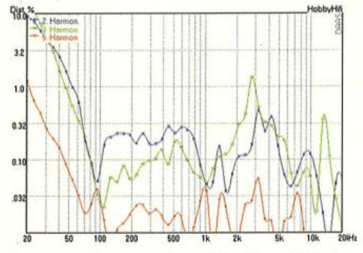

Do you have a screenshot or link for this?Btw, the Dayton RS225 was tested recently in Hobby Hifi, still a great woofer after all those years. Especially the 8 ohm version has very little issues.
RS225-4 @ 90dB
RS225-8 @ 90dB
For the full article you have to buy Hobby Hifi 2/3-2023
And no, it's obviously not as low as some much more expensive drivers, but extremely workable.
(at the same time, a lot better than woofers that are a more expensive as well)
Btw, this is NOT the P variant, I think the P variant performs a little less.
Not sure why.
edit: looks like the break-up peak is a lot lower at the P variant.
That's unfortunately, because I think they look a lot better

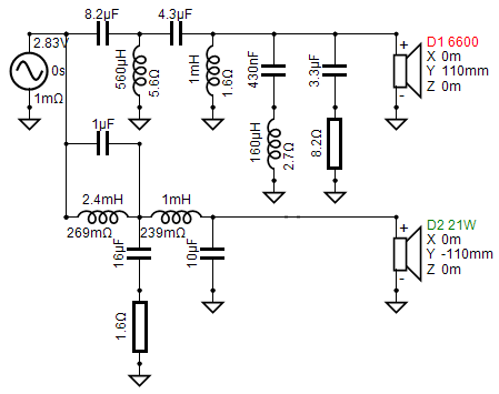

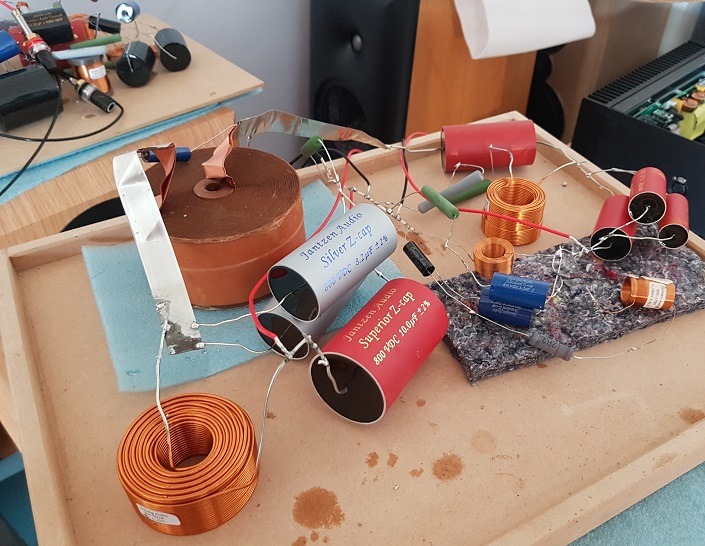

Today I continued listening and tuning of the loudspeakers.
I got rid of resistor in tweeter section doing the attenuation, and replaced it with series RC in parallel to tweeter and increased overall tweeter level by 0.5-1dB. This showed to be the right step.
As the result is very satisfactory so far, I will plan making final cabinets, with optimized baffle around tweeter to improve mild 2300Hz diffraction and smooth out off axis responses.
18kHz peak needed needed just partial compensation. As I expected mild lift of trebles above 5kHz is not a problem.,
After ClassIllu 2way with 18W/8545K00, this is again the moment I am impressed with Scan Speak Classic driver. I have been working and listening to 18W Revelator, 18WU Illuminators, Satori MW16P MW19P WO24P, SB SB17xx, NE 225W,.....and in 7-8inch cathegory Classic drivers just shine. They were not easiest to work with, I takes several iterations of amount of damping material adjustment, port tuning adjustment, and of course crossover changes, yet very rewarding experience.
