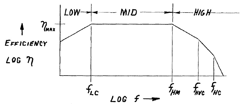

Not likely. Probably measuring/hearing cabinet resonance because there is no way that horn goes that high. The efficiency-bandwidth product is only 210Hz for that woofer.
Flc = lower rolloff due to driver compliance
Fhm = high end rolloff due to driver diaphragm mass
Fhvc = high end rolloff due to voice coil inductance
Fhc = high end rolloff due to the compliance introduced by the front chamber
Attached graphic is from D.B Keele's AES paper titled "Low-Frequency Horn Design Using Thiele-Small Driver Parameters".

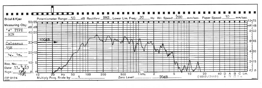

It definitely outputs a tone at 3.8KHz but dies off very quickly above that.
I have to add that I am testing at about 1 watt and its likely the speaker wont do as well frequency wise at full power. That's why I am using tweeters with it.
I previously bought a pair of Fane folded horn speakers off a guitarist and he used two tweeters with them to get top end.
Fanes own measurement for its w-bin.
Looks better than what I am getting but I am using a sub speaker.
