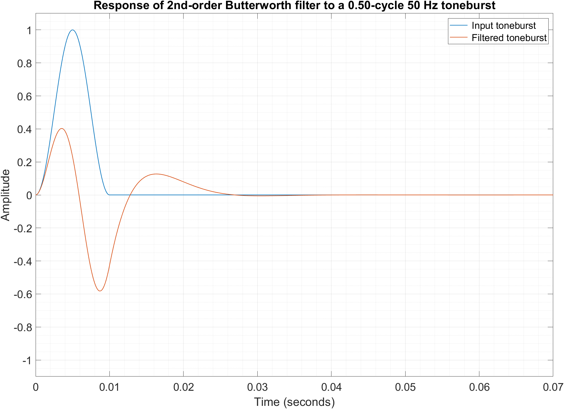

Below is the simulated response of a 2nd-order Butterworth filter to a 1/2-cycle 50 Hz toneburst. The 1/2-cycle might be representative of the impulse provided by a kick drum, although the ringing of the drum skin is not being included here for the sake of simplicity. This time domain response is the typical behaviour of a maximally-flat B2 sealed enclosure alignment with a –3dB point at 50Hz.

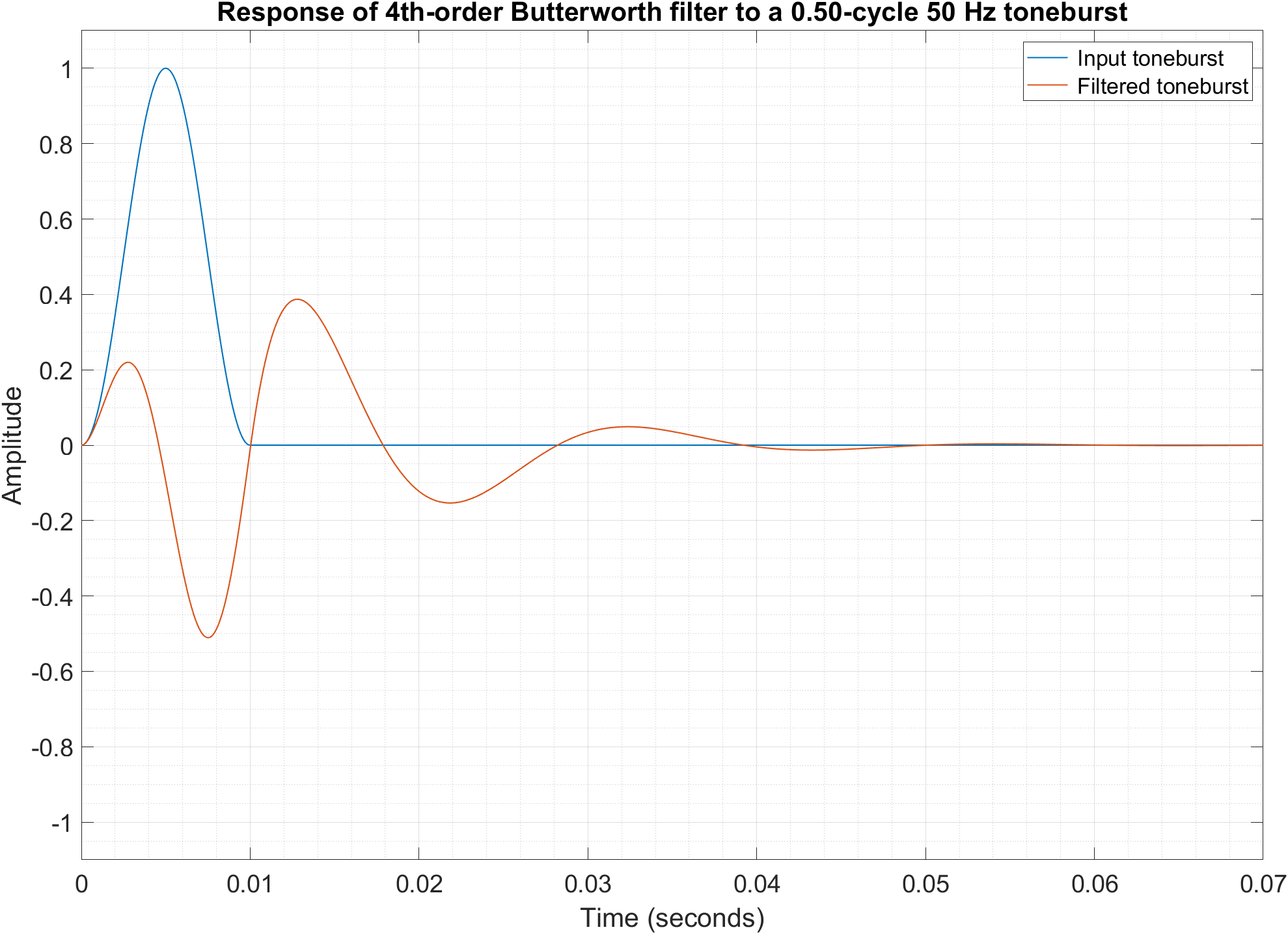

And below is the simulated response of a 4th-order Butterworth filter to a 1/2-cycle 50 Hz toneburst. This is the typical behaviour of a maximally-flat B4 vented enclosure alignment with a –3dB point at 50Hz.
Clearly, the 4th-order (vented) and 2nd-order (sealed) systems produce quite different time domain responses. Note that both output signals are attenuated relative to the input signal, owing to the high-pass filter response functions both being –3dB at 50Hz. In both cases, the largest output response swing is negative going, so both systems appear to "invert" the input signal to some degree. The initial positive-going peak is almost twice as large for the 2nd-order system, which may have a bearing on how these two types of systems compare in a listening situation. Overall, the transient response of the 2nd-order (sealed) system is much more damped.

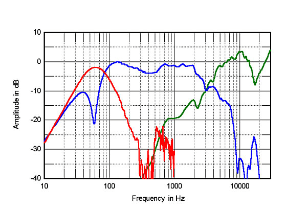

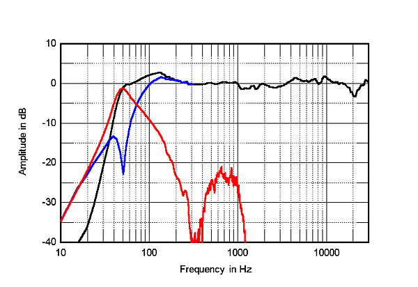

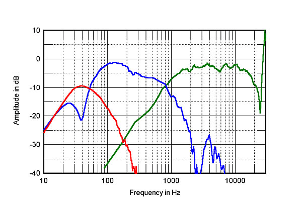

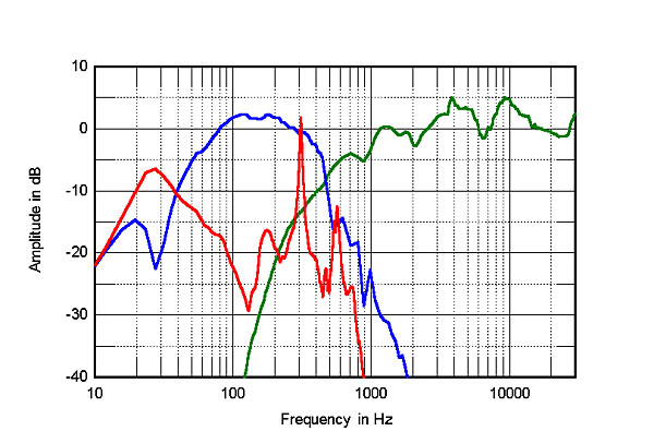

Some nearfield measurements from Stereophile, two floorstanders and two standmounts all with BR tuned woofers.

Although there are clear differences, there are also many similarities in the responses of the 2nd-order and 4th-order high-pass Butterworth filter responses to the 1/2-cycle 50Hz pulse. Note that the group delay at 50Hz of a vented system is 11.3 ms, which is about 2.5 times greater than that of the closed box system. It is unclear how that has affected the transient response, especially when it seems evident that the peaks in the transient response of the 4th-order filter occur earlier than do the peaks in the 2nd-order Butterworth filter's transient response. In this instance, the 4th-order Butterworth filter has less delay, is the opposite of the group delay response.

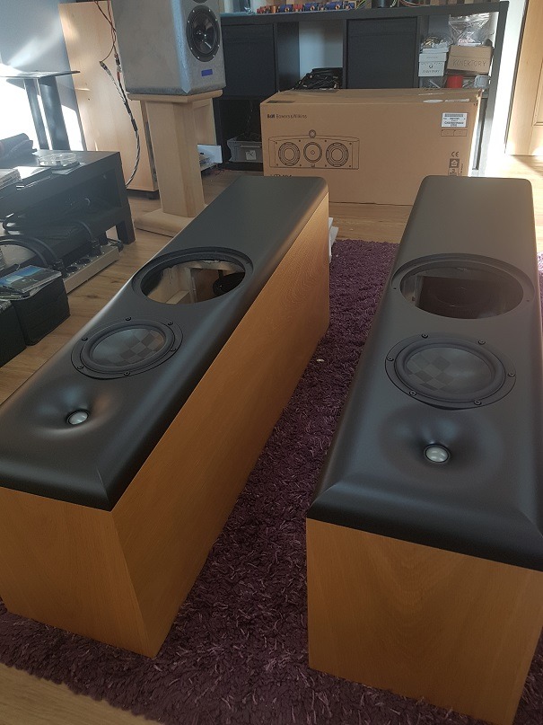

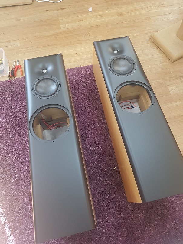

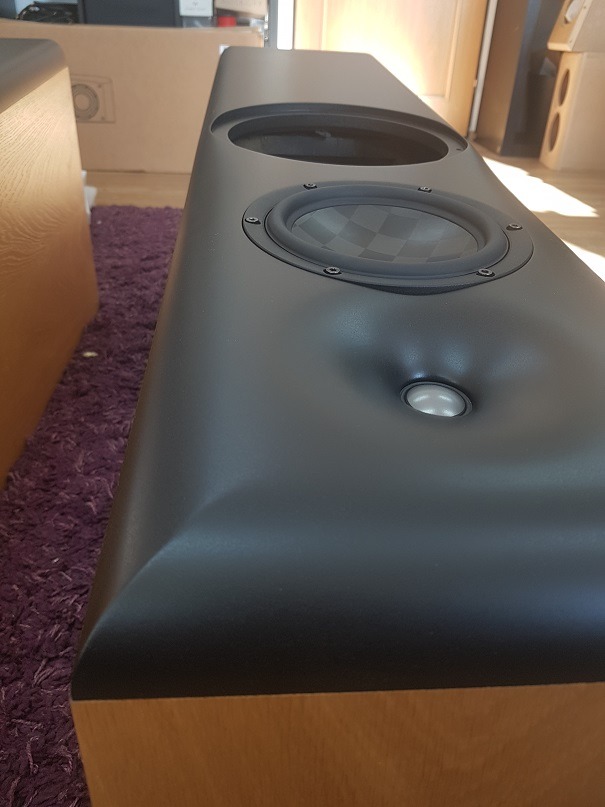

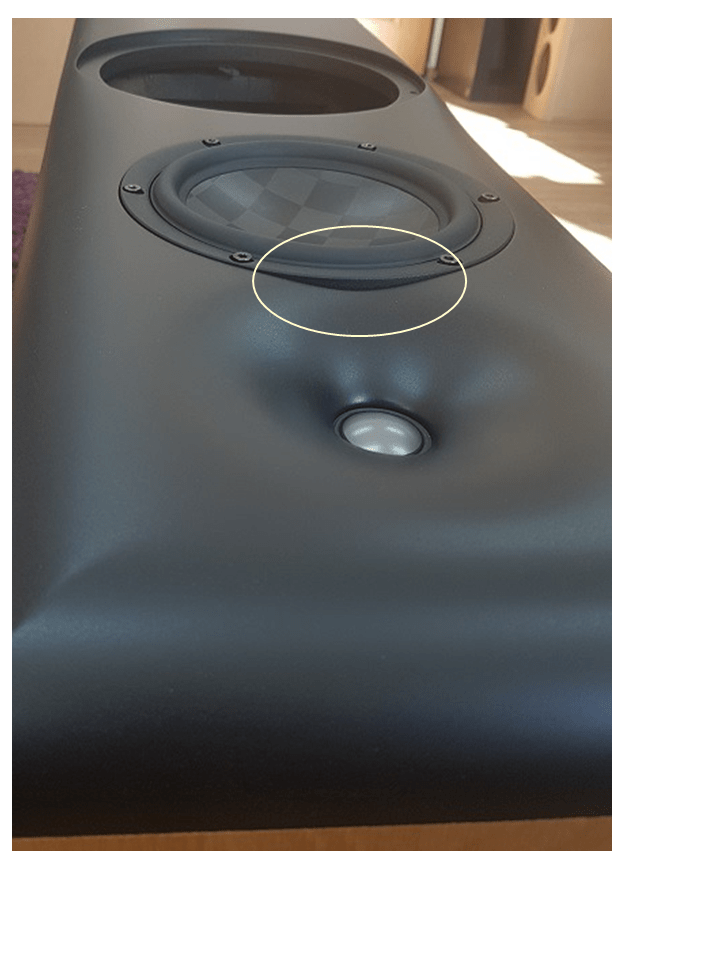

I think I have mentioned this before, but I am very impressed by the construction quality and craftsmanship of your cabinet. The baffle in particular is very impressive with the very large elliptical edge radius and the CNC-machined waveguide directly into the baffle. The overall look of your cabinet is exceptional.
I assume the small lip which protrudes into the waveguide (the frame of the MW16TX) causes no significant issue. Did you verify this by simulation before you built it, or was this determined by building the prototype? I ask because I seem to have reached the limit of my simulation capability, and I may have to build some prototypes... so I am curious about your work flow and your decision process.
j.
Hifijim, thank you....I outsource carpentry and painting, I was lucky to find reliable and enthusiastic carpenter and he is responsible for majority of cabinets for my projects. I am very glad I can realize my ideas, thank to him.
That lip protruding to WG show to be harmless. I like this esthetics better, I did not make any modelling, I just did it earlier for several projects. I think I tried it for N164 project with Monacor WG300 and XT25, and then several times with Visaton WG148R. There might be mild irregularitites caused by this but they were not severe enough I would have to rework it and make larger CtC.
