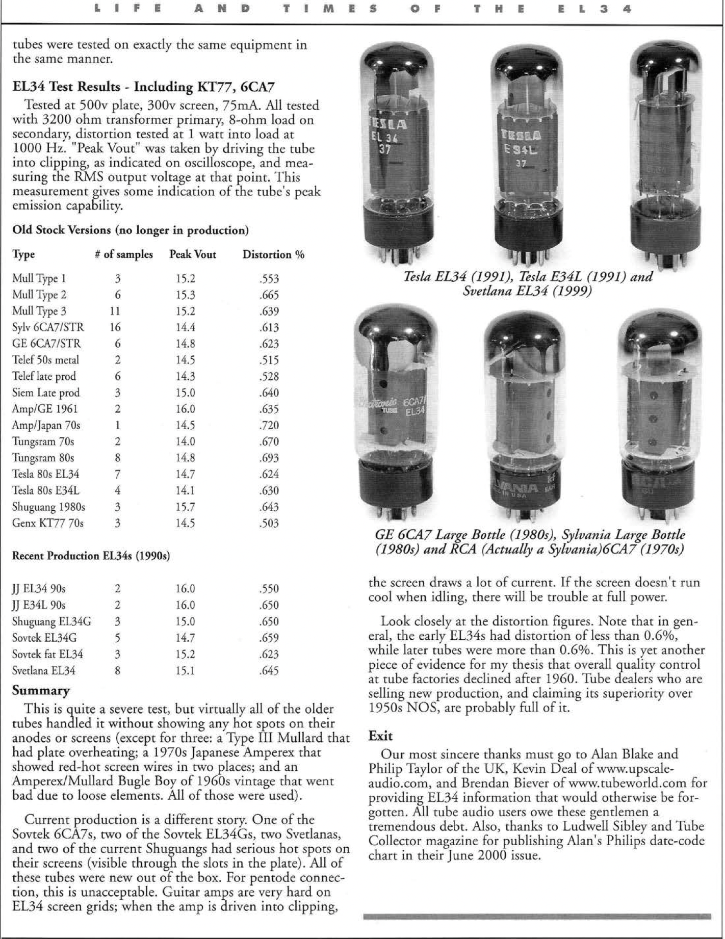

Marantz Model 9's. The EH 6CA7's sound great in ultra linear but lacking just a tad in Triode mode in the midrange. I purchased these for their reputation of good sound in Marantz's and their reputation for reliability.
I know Telefunken was the best for these back in the day and were the lowest distortion EL34.
This is mostly an old production comparison I have attached. Not sure about new production and these measurements were taken 20 or so years ago. Telefunken was the best EL34 type, JJ EL34 not bad but I am scared of their reliability.
Not sure how faithful the newer KT77's are as the original Genalax was great.
