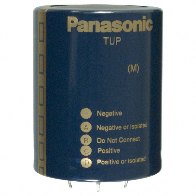

Got my capacitors yesterday. The 820uF/500V are really big. Diam 50mm x 63mm long. Which terminal should I connect? I'm thinking (-) and (C) but I don't know what's the difference between (-) and (A) or difference between (C) and (D). Anybody could shed some light please?
Thanks,
Thanks,
(-) and (A) are probably internally connected, check with a multimeter. Same for (C) and (D).
You're right. (-) and (A) are bridged together. Same for (C) and (D). I don't know what is the purpose of (B). It's not electrically connected to any of the pins. Maybe just for mechanical stability on circuit board.
Bingo! Or Panasonic markets another line of caps where the fifth pin is used as the center point of two caps in series.
For your cap, even though the pins are bridged internally, I'd still connect both pins to the circuit. - Or bridge them externally with a piece of wire, then run one wire to the PCB. You never know how strong the internal connection is...
Good luck. Hopefully, this is all that's needed to get that sweet gallbladder sound again... 🙂

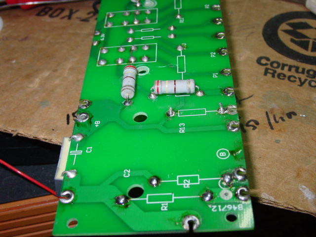

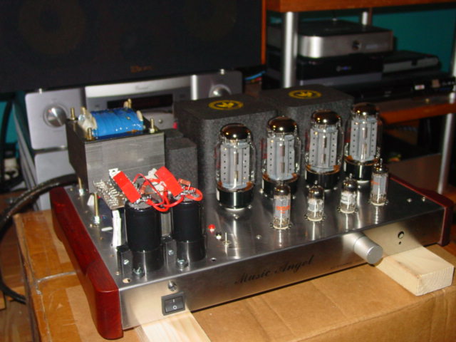

I bought this amp a few months ago on eBay. 2 weeks ago while listening to it for over 2 hours, I noticed heavy smoke coming from the left side of the amp. One of the hv capacitors blew up. It is 220uF/250v. For the last 2 weeks, I have been reading intensely about mods and other people problems yet I could not find a suitable schematic for my amp. First of all, my amp has 7 tubes: 4x kt88, 2x 6n8p and 1x 6n3. All the schematics I found has 8 tubes.
Also if you notice the power PCB, there is a modification done (by the factory, not me) with the yellow wire. Maybe I got a lemon. Anyway, I need your advice: should i replace the capacitor(s) with 220uF/400v? Would this solve my problem? I also want to eliminate the Triode/UL switch but I need a good schematic for that. Any other suggestions please help me so I can enjoy again “the sound of the music”.
Thanks,
alecu7

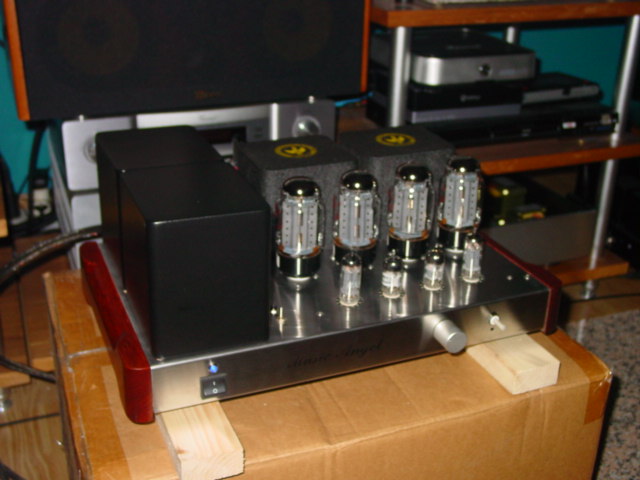

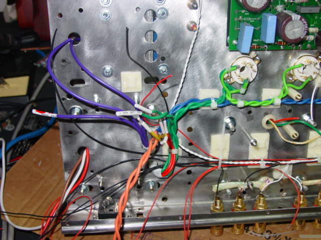

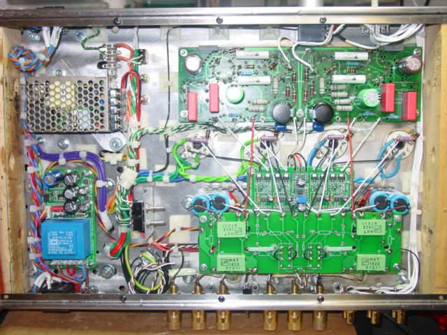

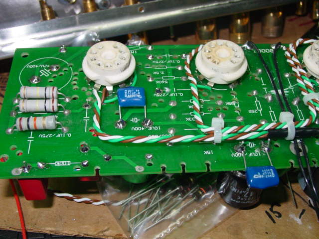

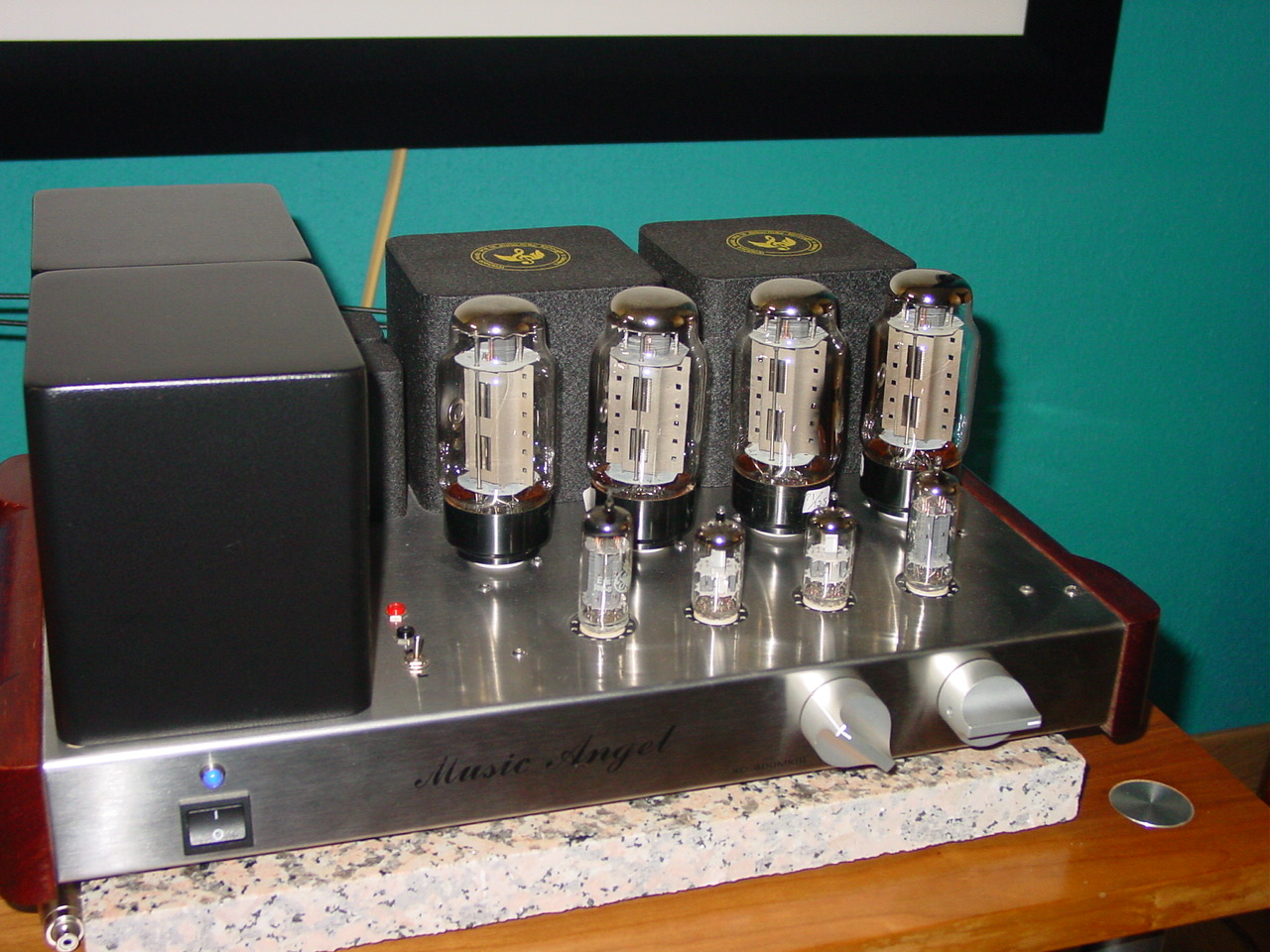

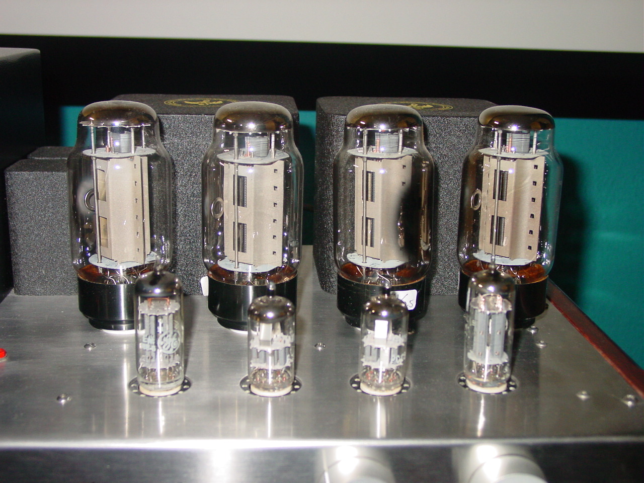

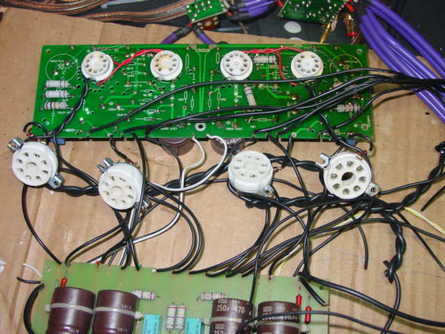

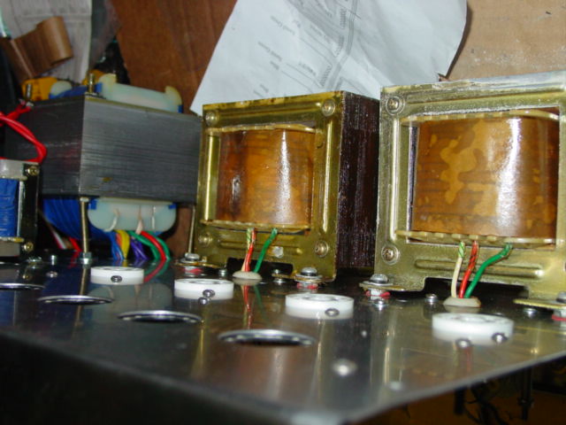

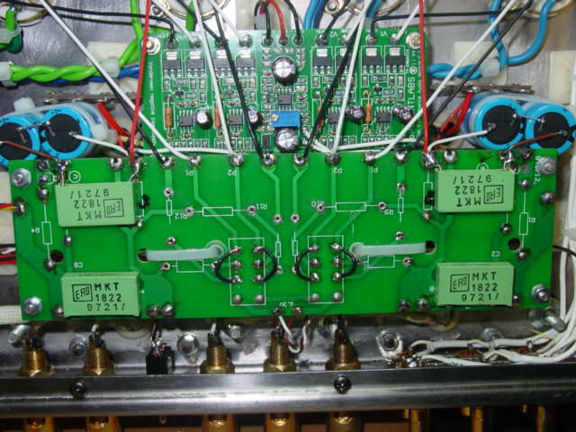

Music Angel KT88 rebuild

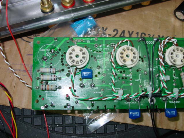

Hello,
I decided to buy this amplifier due the low price and because of good reports that i read in the internet.
I received the amplifier and liked the sound but after about two month the power transformers burned so i decided to make a full rebuild the amplifier.
I have attached some pictures of the process.
Now the amplifier is sound much better but this is almost a new amplifier.
Please excuse my poor english.
Best Regards

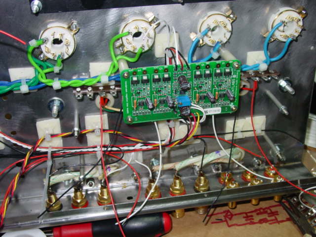

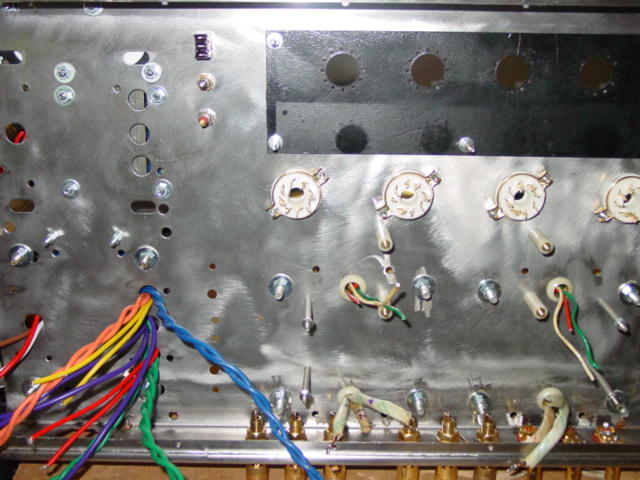

Hello,
Best Regards

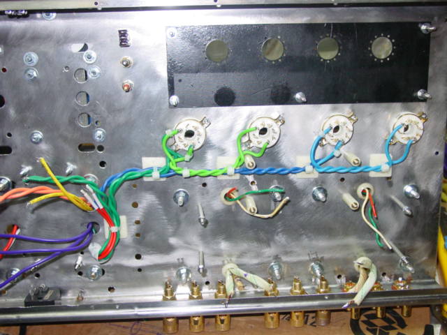

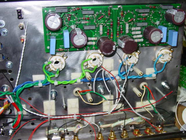

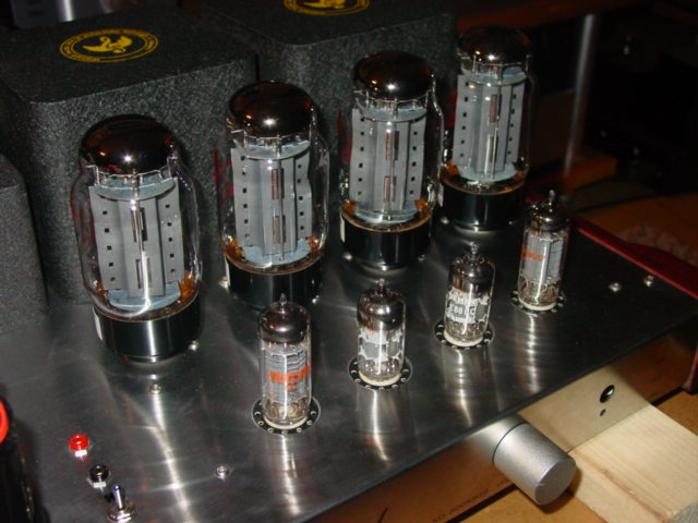

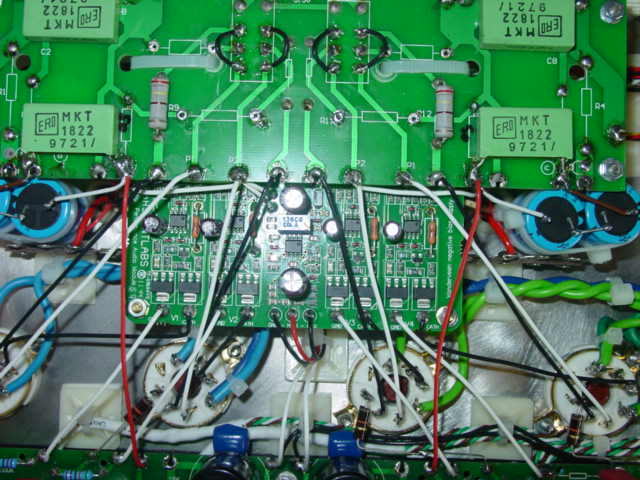

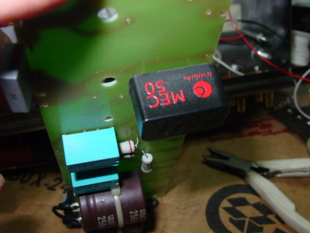

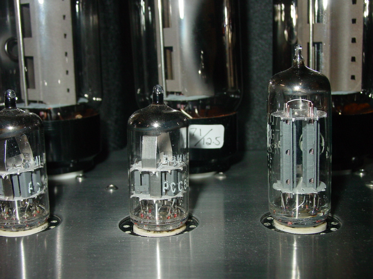

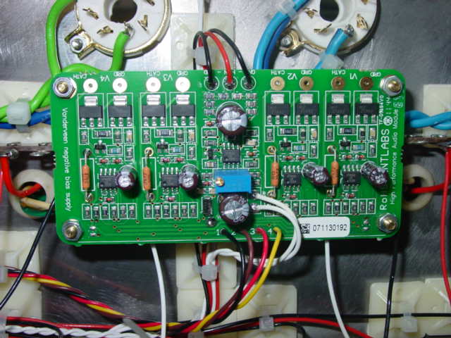

To bias the power tubes i'm using a Tentlabs bias module that allow me to use any kind of KT88, 6550, KT120, EL34, EL156. I just have to adjust the plate current i want to the tubes and the module automatically adjust the current for each tube even if i use not matched tubes.
I tested several power tubes and choose the EL156. These tubes have a very musical and natural sound.
I always use the tubes in triode mode.

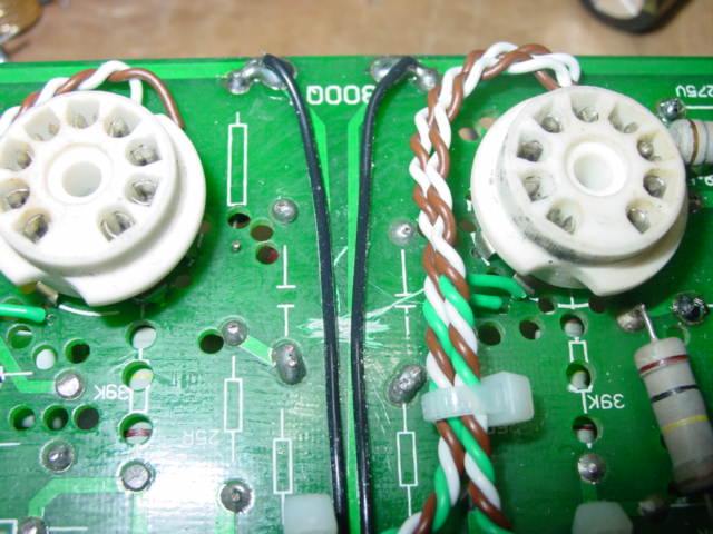

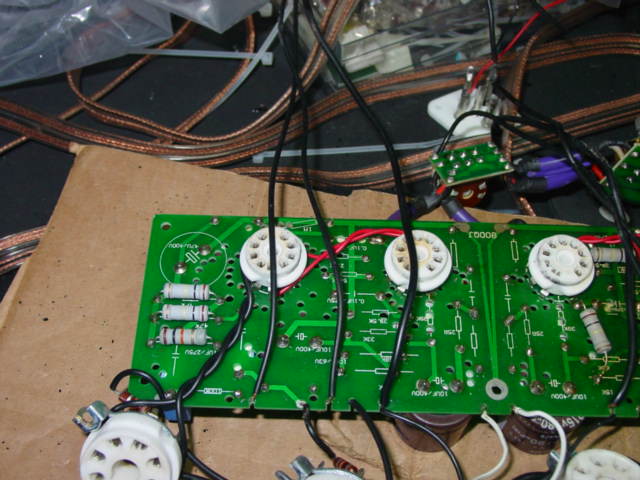

I change the front stage circuit to accept several types of tubes like ECC85, 6DJ8, ECC81, ECC82. Now i'm using Philips PCC88. The driver tube i choose the 6FQ7. These are much better tubes than ECC82 in driver stage, but i had to make some changes.

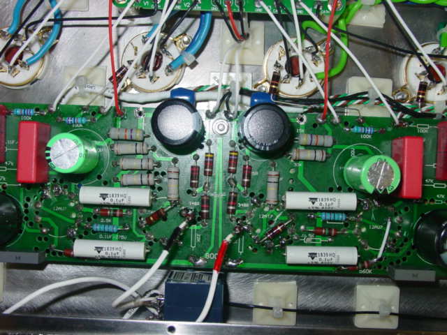

Here some more pictures.

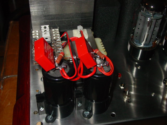

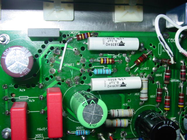

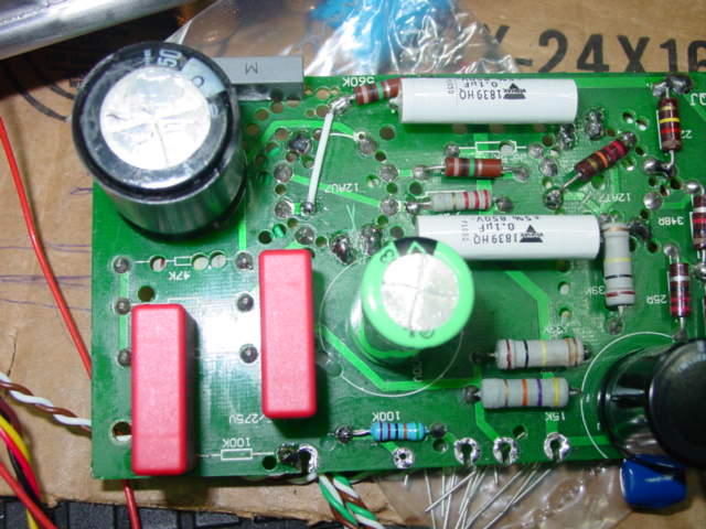

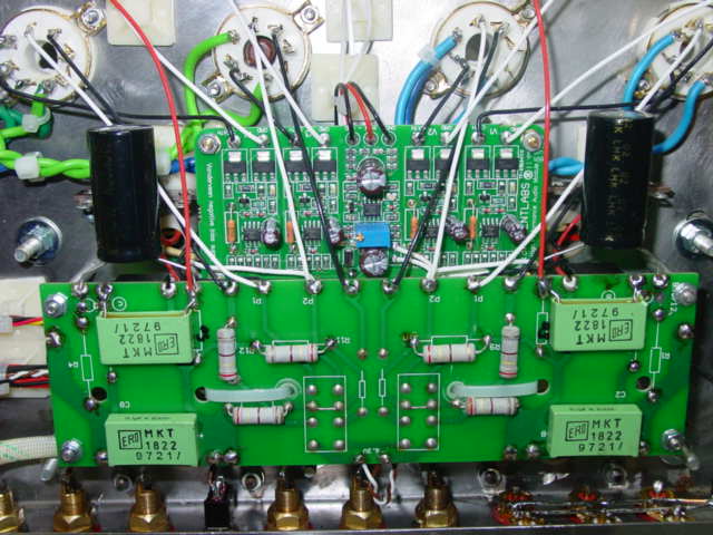

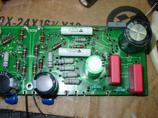

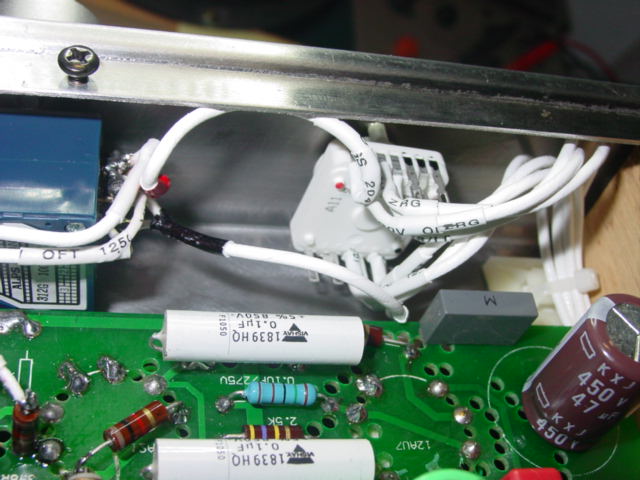

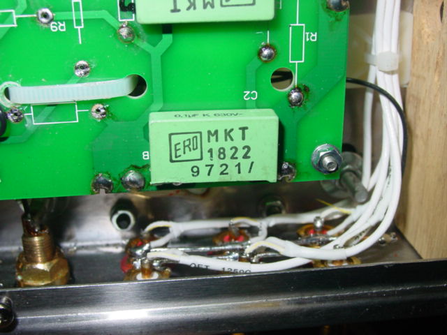

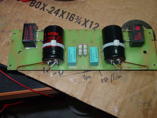

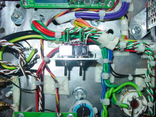

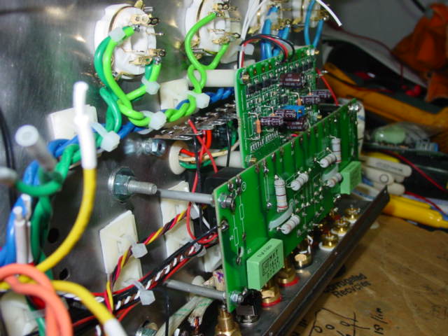

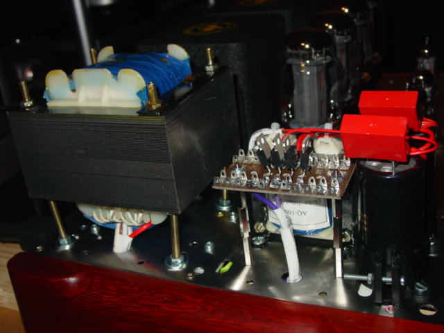

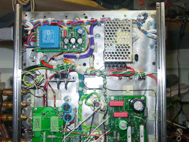

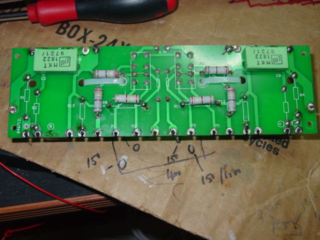

The power supply was built all over again with a much better transformer from ordered from ASL, FRED diodes, filter choque, Muldorf Eletrolitic caps bypassed with PIO caps. I add one more filter stage with MEC50 eletronic modules for front and driver stage.
The filament of PCC88 and 6FQ7 was DC supplied with a separated power supply.

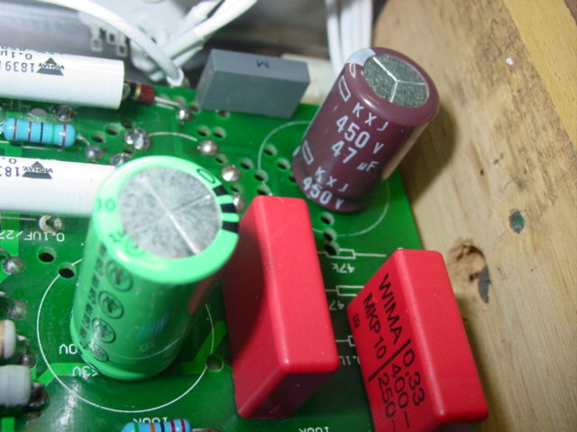

All original eletrolitic and PP caps was replaced with better ones.
The original volume pot and input selector was replaced with APLS Blue line pot and silver contact switch. The input signal wire was also replaced by silver cable.
I must try in the near future new coupling caps, maybe PIO but i must select the small onesas possible because i have reduced space inside the amplifier.
This amplifier have zerohum and noise even when i use my Lascala horn speakers.
Normally i use this amplifier with my Quads ESL/ESL63 with excelent results. I would like to try new output transformers, maybe Lundall or Eletra Print?
I leave here some more pictures.

hello, je possède moi aussi un xd-800mk3 KT88.J'ai remplacé toute les capa non polarisé X2 ~ d'origine par des mkp wima =.Et cela sonne mieux , pas de modification de schéma. Par contre , faite attention au sens de la grille de protection de fond . Au niveau des visses de fixation des pieds de l'amplificateur , elles sont un tout petit peu trop longues. Un mauvais positionnement entraine à la mise sous tension un défaut châssis/carte . L'appareil se met en sécurité . J'ai du mettre les écrous à l'extérieur et tout est rentrée dans l'ordre.
TRANSLATION
Veuillez noter qu'il s'agit d'un forum en anglais.hello, i also own an xd-800mk3 KT88. I replaced all the original non-polarized X2 ~ capa with mkp wima =. And that sounds better, no schematic modification. On the other hand, pay attention to the direction of the bottom protection grid. At the level of the fixing screws of the feet of the amplifier, they are a little too long. Incorrect positioning causes a chassis / card fault on power-up. The device goes into safety. I had to put the nuts on the outside and everything is back to normal.
