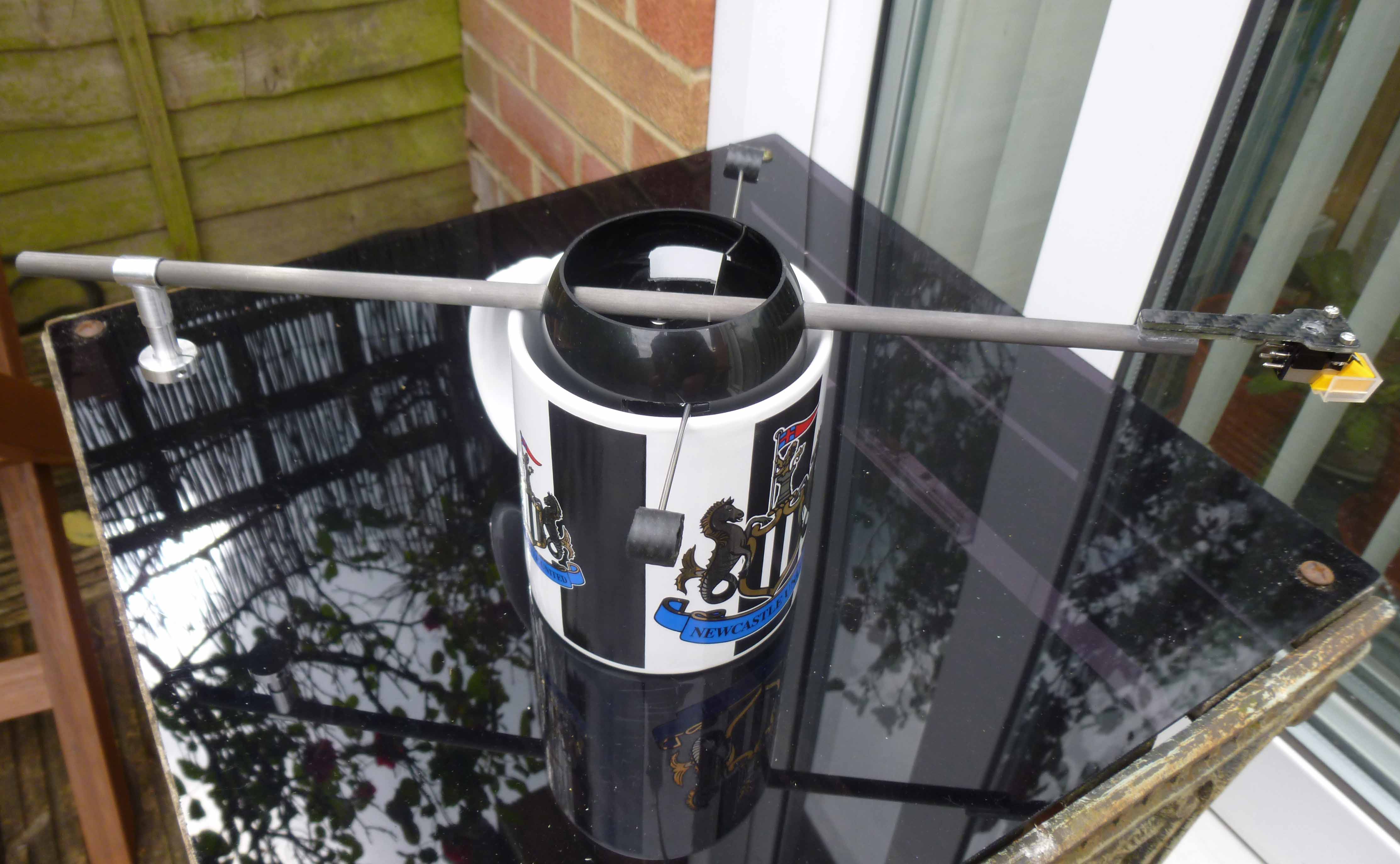

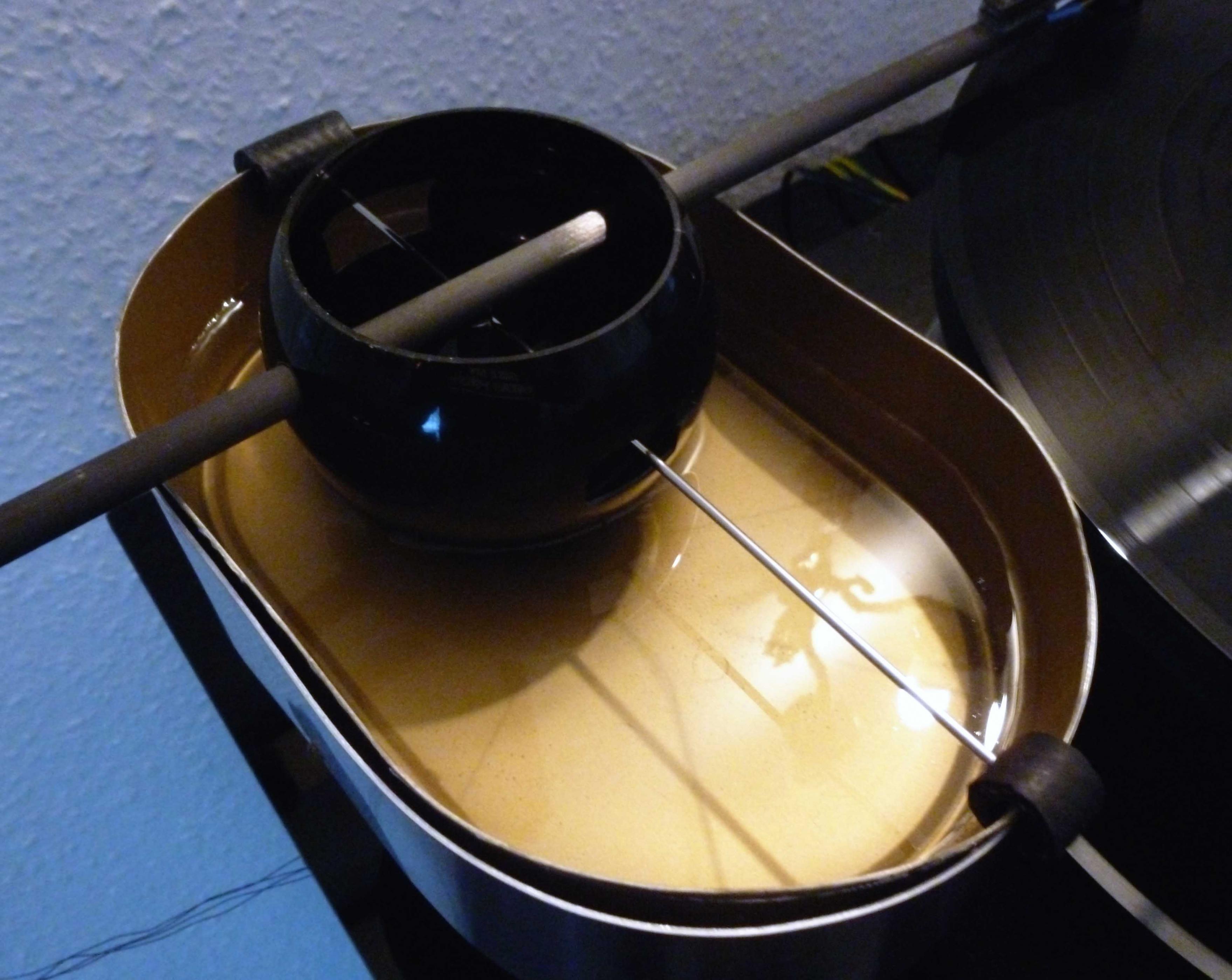

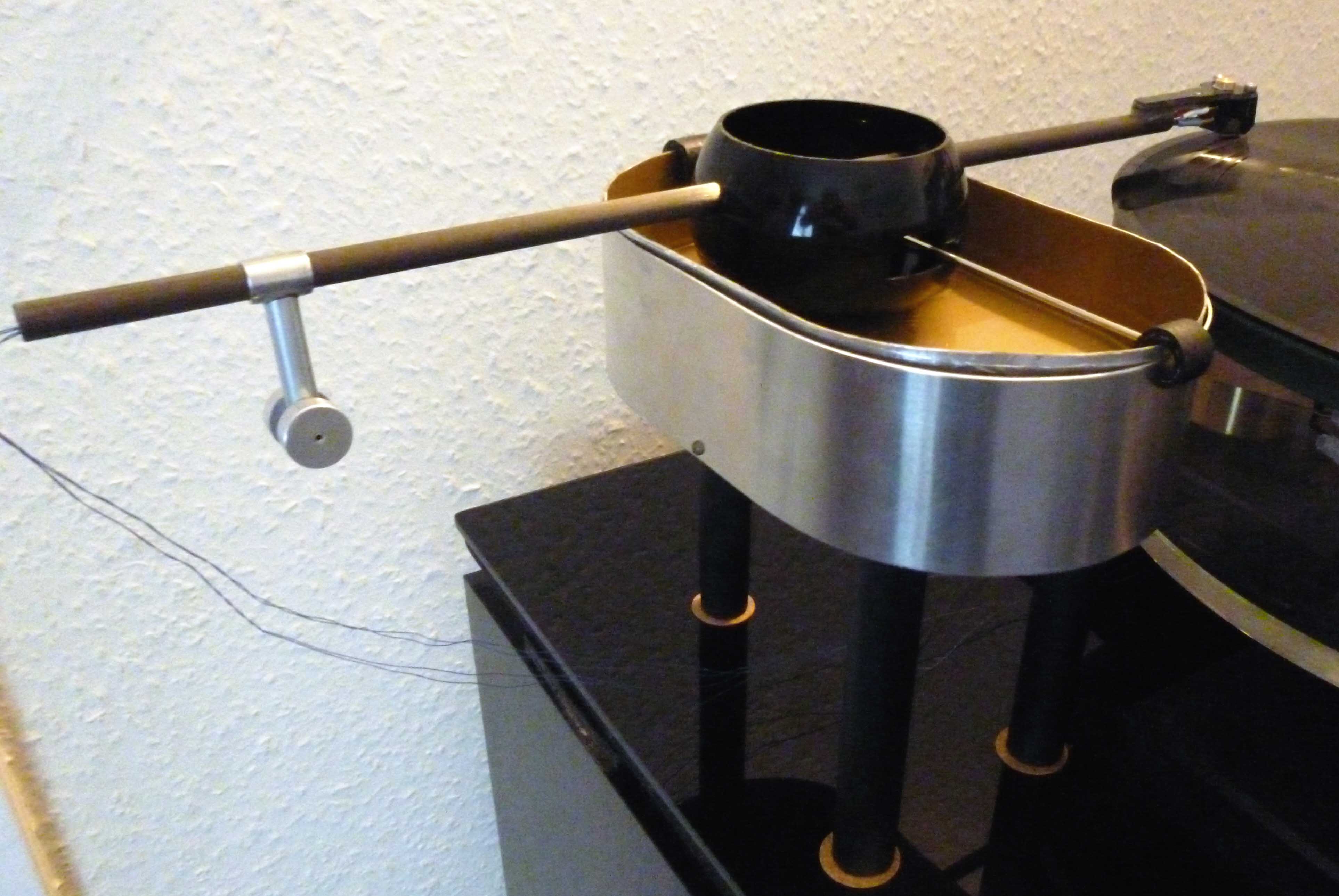

Mk.2 Floater
Hi All,
Sorry to take you away from the cart. Discussion but 😉 ……
…. It seems ages since I started Floater Mk.2 but have finally got as far as testing it!
My Mk.1 was with a shortened c/weight ‘tail’ [#1] but Tom recommended the full arm length of 400mm [stylus to tail], so who am I to argue?
He was right tho’ as it gives more control over self-aligning the ‘90deg to centre line from spindle.’
In the garage I found some leftover motorbike fuel hose which I cut into 2 x 20mm lengths, then sliced down one side & drilled a 2mm hole thro’ one face. Perfect for holding in place the horizontal bar, which can be adjusted easily on the fly.
Still using the ‘Ice Cream Tub’ but this time with a 1mm sheet of ally roughly formed to support it better & of course the old broom handle for the legs.
First tests were with my 35year old Linn K9 cart, warmer than my SAE1000 but, sounded great although obviously with less detail.
As Tom has said before ‘His Floater’ will bring out the best in ANY cart. You Guys gotta try it🙂
No apologies for the pics, I am just a bad photographer!
GC
Ps. How you getting on with yours, chrisg?
