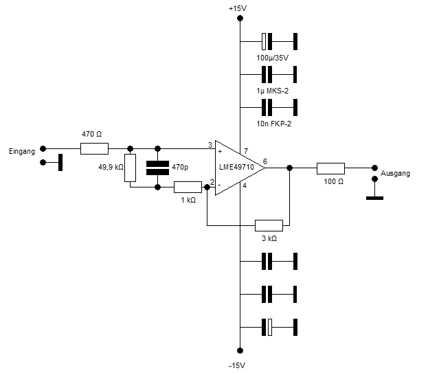

For better understanding, here is my thin sounding circuit:

Tolu, have you tried 100n bypass instead of 1uF, and also 100-470n from +v to -v. Btw, the other ends of 49.9k/470p/1k are grounded on the pcb, right? So, the gain = 4x in the preamp. I'd first try a lower gain, say, 2x or just use the LME49710 as a buffer.

I haven't tried 100n instead of 1µF, but what do you mean with 100-470 n from +V to -V?
What do you mean with the other ends of 49.9k/470p/1k are grounded? It is like on the picture. Eingang stands for Input and Ausgang for Output. There is only the Input and the Output Cinch grounded and the rest as on the pic.
The gain is 4x. Do you think gain x1 will warm up the sound?
Regards
Thomas
Oh sorry, I know what you mean with grounding the input section!
I had a look on the original circuit drawing and found that I had forgotten the grounding for Input section and the feedback resistor. But it works although! I am no electrician but a business man so I have sometimes problems of understanding! :xeye:
What will be the effect of grounding correctly? With an OPA604 there is enough bass. I tried the OPA604 in Class A mode (I took Pin 5 in replacement for Pin 6). It sounded very good but there was very much noise and plops when the cd player stepped from song to song! The missing ground could be the reason, or?

I HAVE USED LME49710 AS LINE PREAMPLIFIER WITH GREAT RESULTS.YOUR CIRCUIT IS WRONG.YOU MUST GROUND THE OTHER END OF 49,9K.ALSO BYPASS THE SUPPLY WITH SMALLER CAPS,SAY 100NF.YOU MUST ALSO CONNECT IN SERIES TO OUTPUT A 47-100R RESISTOR TO ISOLATE THE IC FROM CAPACITIVE LOADS.TRY THESE AND...NO PROPLEMS,IT SOUNDS GREAT.

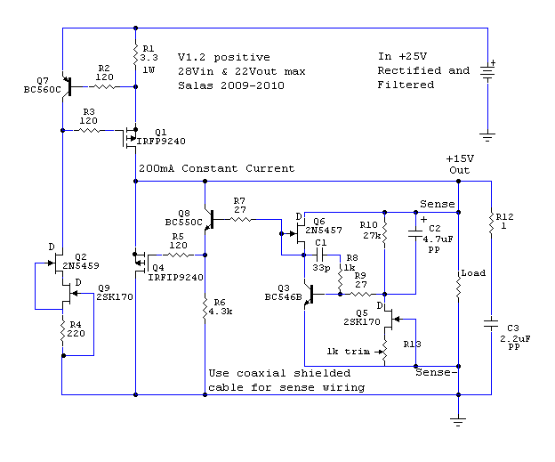

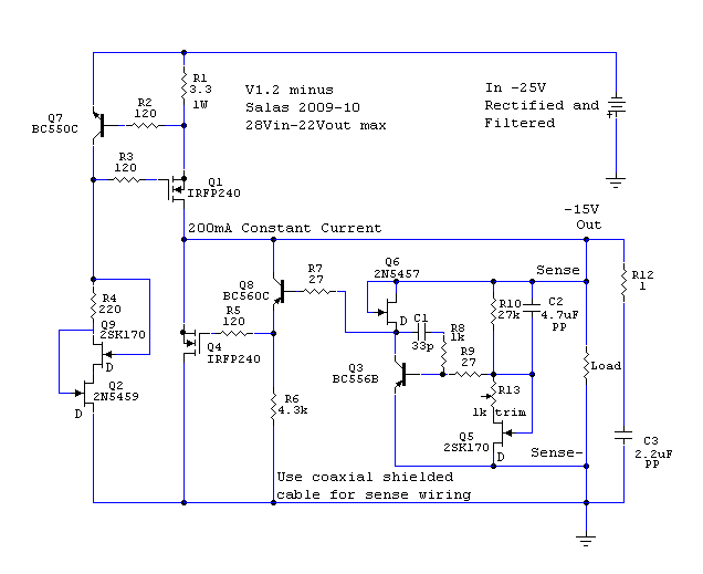

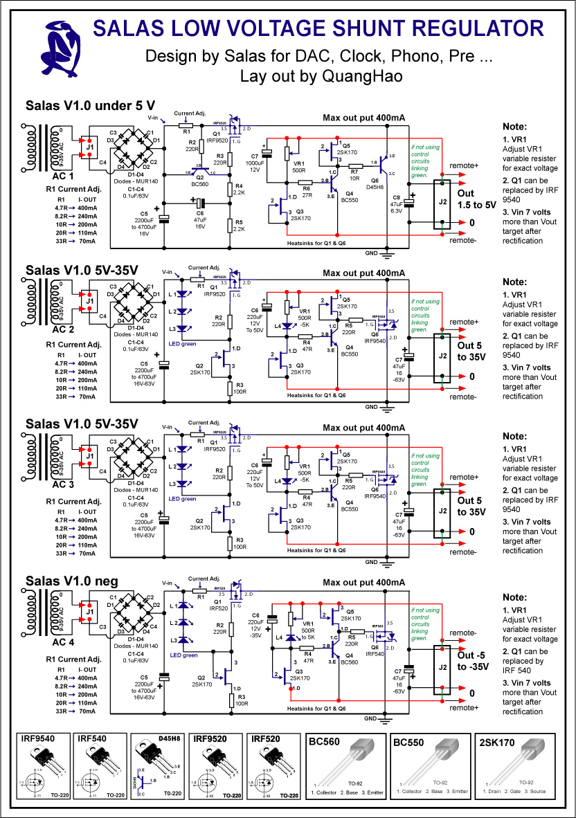

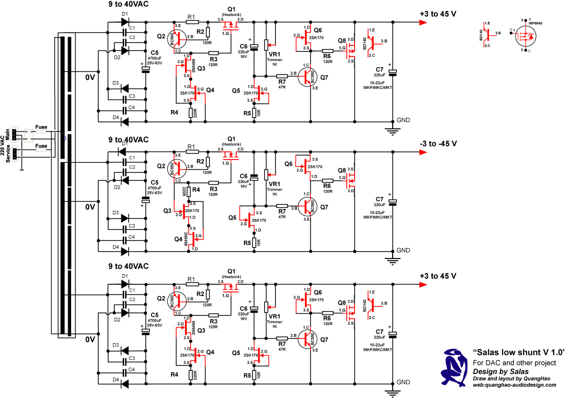

I have spent many hours reading here about shunt regulators and investigating the schemes here. Could anyone advice please, which one to use here? I have attached various +&- regs' versions. Some of them are with LEDs, others don't have zenners (why?!). To my mind they all differ and not so simple to me, previously having experience with LM317-337 only 🙂
