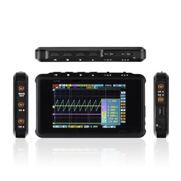

It maybe a stupid thought but one like this would be a dream!! Looks too good to be true probably cheap and nasty with basic specs haha 😱

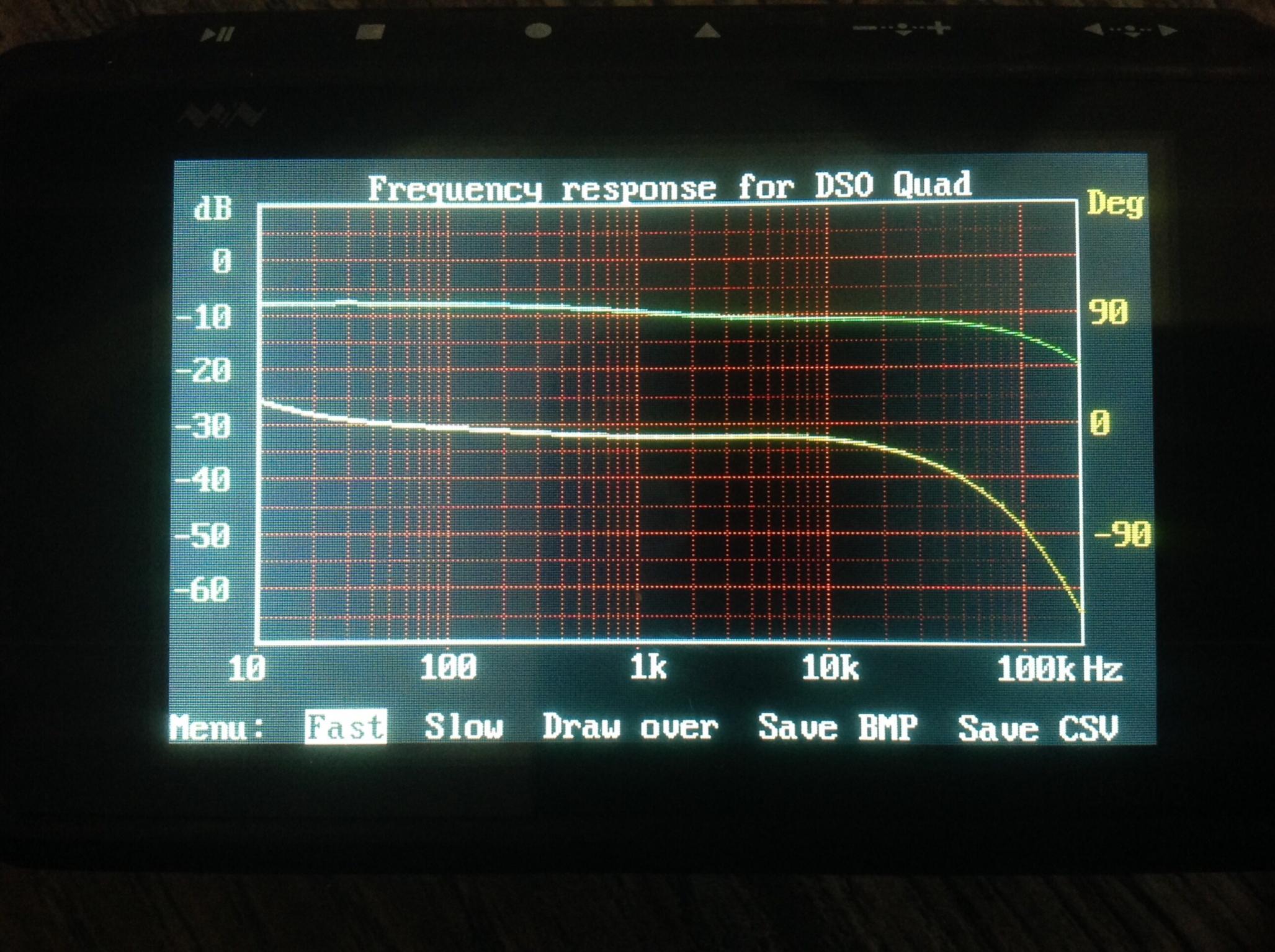

Ha, ha. Does that cutie HAVE "specs"? Or even a name?
Filling in the knock-knocks: it is a 1MHz machine. Half of all the 'scopes I've used were under 1MHz. Not just the couple 450kHz machines; one crapped-out at 19KHz. Did some service and a LOT of teaching/learning on that one.
haha so true but probably no specs but dam I just want one for novelty purpose the fun of it lol just looks cool 😛

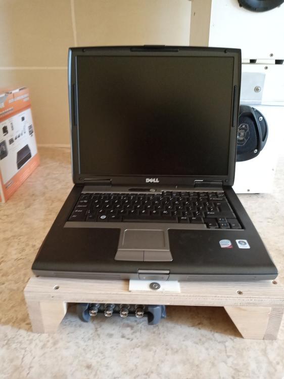

I have a Hantek USB scope with four inputs for which I made a short stool-like structure. I fixed the oscilloscope module safely under the top taking care to also fix securely the connecting cable. On top, I fixed a laptop with Windows 7 installed. The laptop will only be used for the oscilloscope. This setup emulates a portable more expensive oscilloscope with the extra benefit of having an adjustable display window.
