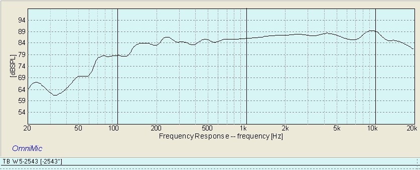

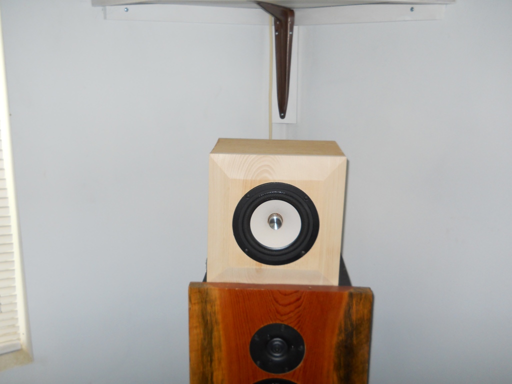

After finding DIYaudio, the 1st thing that I did was set up a fully active 4 way system. Next projects were to build a few two way systems with crossovers. Next up I built a few subwoofers. There were other systems in between on my journey - an econowave, a Danley style unity/synergy system. Now I working on a small portable system that is essentially a full range and a separate small subwoofer (Dayton 6.5"?). The full range I decided to try is the new TB W5-2143. I built a small cube for it with a tapered front panel. I must say that I am impressed and find them very pleasurable. They are not that expensive and have good sensitivity. I would recommend these drivers! I am including a pic and an initial measurement.

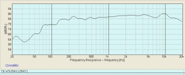

I had them on a separate open framed stand (middle of the room) and measured at 1/2 meter. I used the Dayton Omni-mic system. I played around with the smoothing and interestingly the upper frequencies did not seem to change..... very smooth. Of course the lower frequencies are affected by the room. Since I am planning a small sub up to 180hz, I was not too worried about the lower frequencies.
When you say "a small sub up to 180", do you mean a single /mono unit? I think that's rather higher than you want to go to maintain channel separation - you could get some "interesting" image wandering
From what we can see on the photo that's tidy work on the little box for the W5
