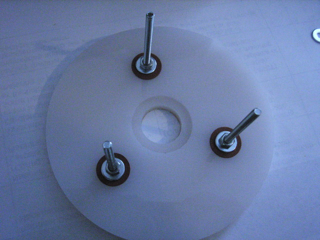

I am not going to house the motor directly underneath the plinth.
I will house the motor in it's own case then sit it on the bottom of three MDF plinths that will be sandwhiched by to layers of 4.8mm cork. So the only MDF that will touching the motor will be the base one.

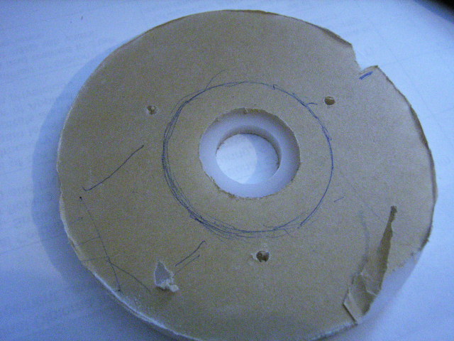

First i cut out the top of the moter housing using 5mm white perspex. i use what I have at home and try to keep things simple as I don't have a great selection of tolls. So it's a metter of making do.
It's about 95mm round. The whole is counter sunk so as to let the motor sit flush up against the underside. The whole are 20mm & 16mm

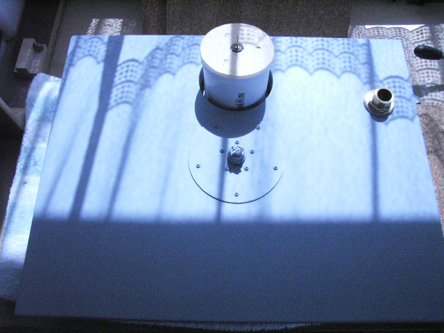

Checking the positioning of the motor before cutting whole in plinth.
I wanted the plinth to be big enough so that I was able to place the motor at the back.

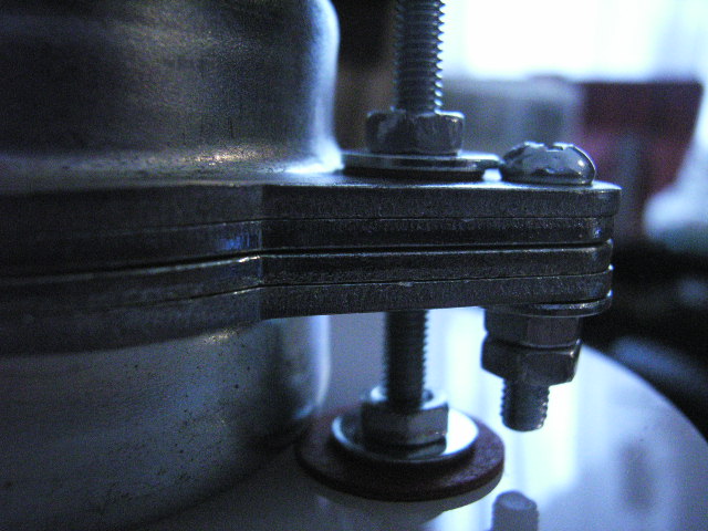

The motor is not cut down yet, as I will be placing a wood plate to go on top so the platter doesn't sit so high and stand out above the the plinth.

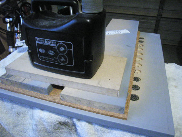

Started glueing some cork onto the bottom MDF as well. Debating over whether I should have waited to paint the top coat first. But as usual I got impatient......
I didn't get much done today, spent the morning at baby class learning how to breast feed..............lovely stuff, all along I was really thinking about geting this thing finished

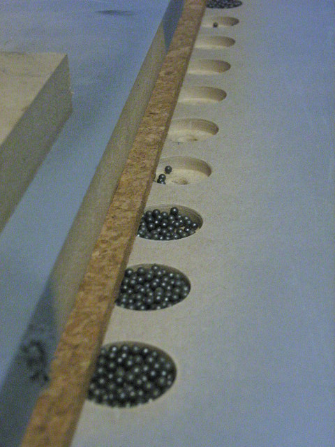

Before i placed the cork on, I drilled a whole lot of holes and filled them with shot, i had this in the garage as I was planning to something different to the TD160, but changed my mind
lead shot
close up of the shot
Drilling:
I had an old spade bit that was broken at the tip. This allowd me to drilled down, otherwise I would have gone through the bottom with the tip.
I put a piece of masking tape around the spade bit to mark the depth to drill to.This worked well. Couldn't use the drill press as it wouldn't reach into the centre of the board.
Drilling:

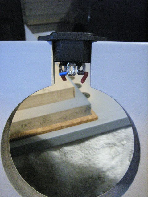

RCA connectors

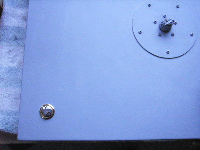

Put in a Perspex plate with RCA connectors as well, today. I drilled the holes into the back and then drilled holes down to meet these, so I can thread the wires through the MDF without any showing. I will pull all these things off again before painting top coat. Just wanted to check that evrything fits before painting.
