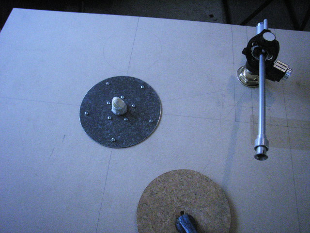

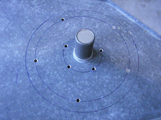

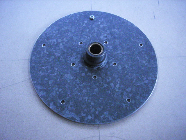

Sub-chassis
Alain,
That steel seems rather hard, you could be right about it being a big job. I will do a test on it and try drilling one small hole to see how hard it is before i go go any further.
I was going to cut it out about 120mm across and then drill a lot of holes around so as to get a good solid contact onto the the MDF plinth.
I'm thinking trailing a MDF-Cork-MDF combination. 20mm MDF onto a 4mm Cork layer, then mounting to another bottom layer of MDF. This I might place holes around and fill with a bottle a 10kg of shot pallets to give that bottom layer extra weight.
Alain; Question for you. I have been looking at ebay, at some tone arms and they seem to be a little pricey for my NZ dollar. How good are the original arms, if set up properly. Is worth looking at getting something else?
Brett
Alain,
Brett

no worries
If you use a grinder make sure you get as close as possible to the outer line so you don't end up with too much filing, but be carefull not to take out too big a chunks.
The Plinth dimensions are 500mm x 400mm. The platter will be sitting dead centre.

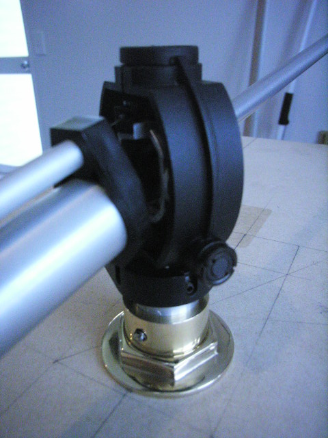

Standard 16 toonearm. With my own stand for it made from 20mm plumbing pipe which I will re-polish and then coat with a clear coat
