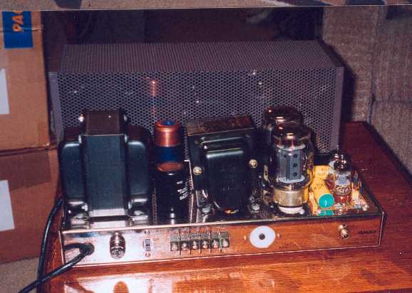

My Dynaco MkIv's
Dynacos were a kit tube amp from 'a while ago'.
They had a very good reputation.
My pair has been redesigned and includes such niceities as fully regulated power supplies etc etc, they push about 35-40wrms of pure, clean, smooth sound. Not loud, but REALLY sweet to listen to. 🙂
