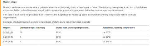

Peerless says neodymium "is unstable and loses strength as temperature increases" in their description of this driver. Comment?
What is "this driver" ?
Technically, the statement that neodymium "is unstable and loses strength as temperature increases" is correct, but loudspeakers normally use neodymium iron boron alloys with terbium and dysprosium, rare earths necessary for neodymium magnets that require high heat resistance. Formulations are available with working temperatures of around 240C, comparable to ferrite magnet formulations.
The availability of terbium and dysprosium can drive the cost of "neo" drivers quite high.
Art
From what i've found here, FAQ - Frequently asked questions about super magnets and magnetism - supermagnete.frtemperature supported depend too of the ratio between base surface and his height.
It seems so to depend in fact too of how is built the speaker. Neo magnet are "smaller" so, it make new arrangement possible, as a disk in bellow the gap inside the pole piece. So that it's not a tall magnet needed.
Real demagnetisation VS temperature depend of the magnet shape. Tall magnet support better temperature than disk. So using disk in the pole piece, choosing neo magnet with higher temperature grade is the way to go (N grade magnet beeing the lower temp grade, 80°C vs 230°C for AH grade magnet).
But with old school construction, replacing ferrite (arround the pole piece) with multiple neo cylinder, temperature grade of neo magnet is less mandatory. For diy, using lot of cylinders of available N grade magnet seems so the way to go.
Just found info and calculators here : Temperature and Neodymium Magnets
EDIT : i OVERsimplified the problem. The full magnetic circuit need to be taken in account to determine temperature VS loose...too much for me...
