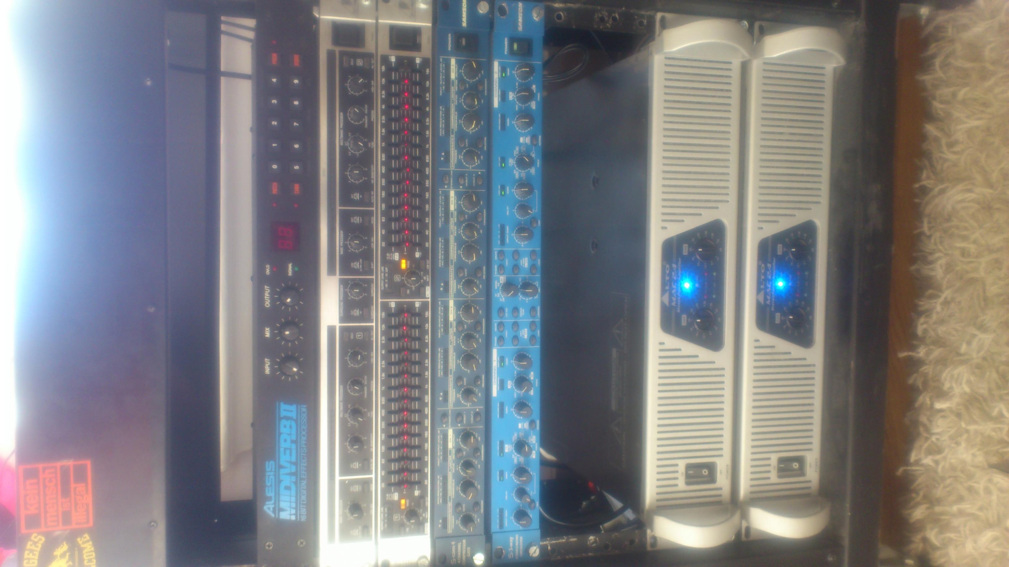

Hi! I just registered here, after countless hours searching the web and reading forums and articles. I arrange techno clubs and have recently bought a new soundsystem (we used to rent). We got a really good deal, but there is a lot about the operation that i dont understand. I hope that you can help me straighten out a few questionmarks!
The system consist of:
Amps:
2 x alto mac 2.4 Link
1 x alto mac 2.3
Speakers ( homebuilt, seemingly good carpentry):
4x passive 12" monitors
4x 15" bases - JBL 2225H Link
4x 12" + horn - P. Audio C12 Link
Misc:
Mixer
3way splitting filter
Compressor
EQ
Currently the smaller amp drives the monitors. So far, so good. Here the confusion starts. Reading some articles about power, i come to the conclusion that the amps are way oversized. Reading others, i get the impression that i im way underpowered. I cant make heads or tails of the numbers here. Ohms, RMS, EIAJ, continous program power, program powre and sensitivity.
If someone can tell me how these specs of the speakers relate to the rateings of the amplifiers, i would be very grateful!
The other question i have is regarding expanding the system. Our Idea is to sell the monitors, and get one active monitor. Than use the smaller amp to power the tops, use the 4x 15" speakers to run lower mid, and build a subbase (double 18" perhaps?) to be run by the second big amplifier. What do you think of this idea?
I realise an active system would be better matched to our skill, but its a question of money, and also of wanting to learn.
Thanks so much for taking your time to read this, and i hope i made myself atleast somewhat understood 🙂

Thank you for your replies. I will ignore the smaller amp and the monitors, since we are planning on selling those.
My wiring is as follows:
SL2442FXPRO mixer to
Samson s-3way splitter to
-> Low signal R+L (<900hz) -> amp -> 2 paralell bases for each chanel.
-> Hihgh signal R+L -> amp -> 2 paralell tops for each chanel.
The speakers are identical. They are connected paralell with two to each channel, thus giving a total resistance for each chanell of 4 ohm i think. The amplifiers are rated on the website as such:

Okay, so you have 4x 1x15" subs, and 4x 1x12"+horn tops, and a pair of fairly powerful amplifiers.
Here's how I'd go:
Set the crossover for, say, 150Hz.
Use one amp for your left side, one for your right. 2x15"s on one channel, 2x12"s on the other. This keeps your speaker cable runs short. Should be 4ohm on each channel of the amp, which is fine. I wouldn't trust these amps at 2ohm, but there's very few that I would.
The 15" JBLs may be the weak link here, depending on what sort of music you'll be playing. Most bass is fairly peaky, so you'd have to be pushing really hard to burn the drivers. If it'll be EDM and dubstep, you're gonna need some good limiters, since they can approach sine-wave-like content, which kills drivers very quickly unless you can cut back the power. Either way, make sure the subs do not receive signals below the tuning frequency of the cabinet. Its very very easy to do mechanical damage when there's no highpass filter in place.

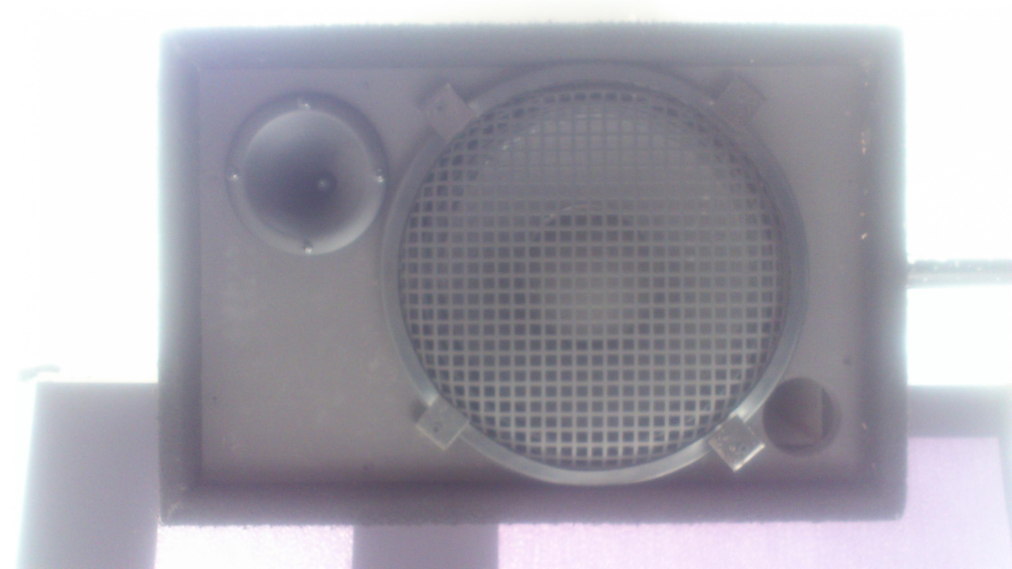

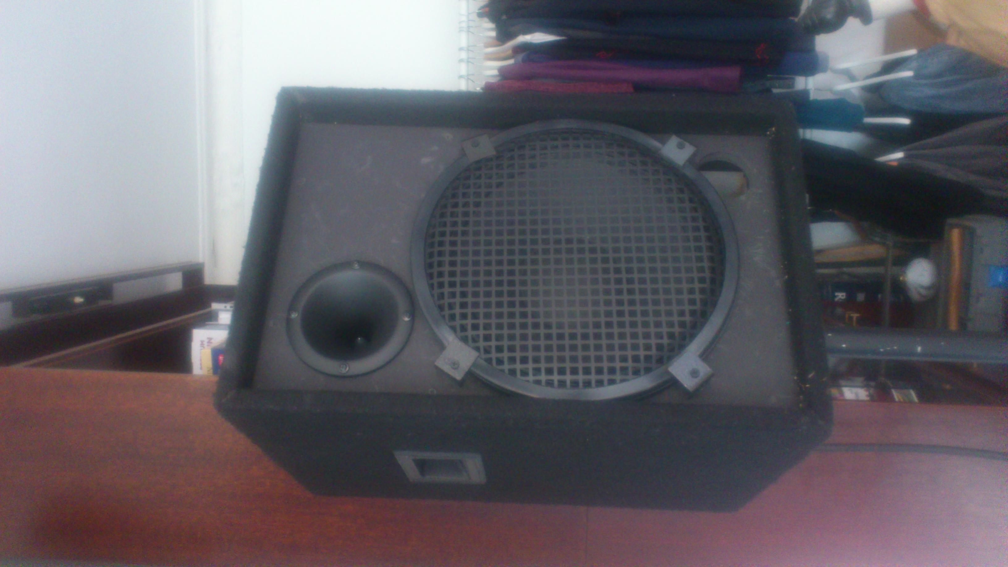

The tops consist of a 12" drive + a hornloaded HF drive. There is also some kind of passive limiter at the back of the speaker to the HF drive, which i usually put as low as -12db in order to not get "sharp" soundiing music that hurts my ears. what this is a symptom of i dont know, but since i can get decent sound out of it, im happy.
As for the crossover at 900hz, i also thougth that this was very high. But turning it lover, i seem to loose something in the music. We will get acess to our new place in about a weeks time. I will do the sugested testing with pink noise then.

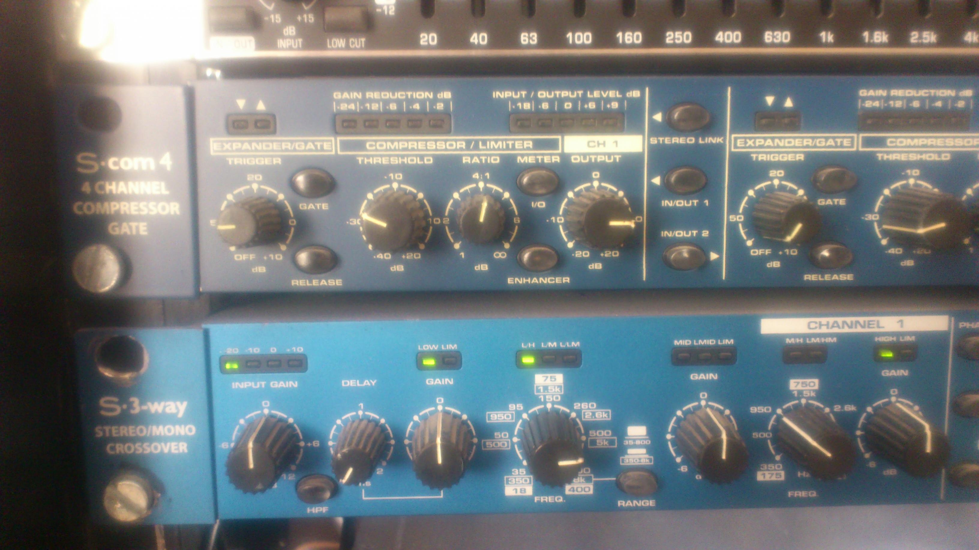

We play almost exclusively Techno, DJs, but also live. This is the compressor we have, and this is the EQ. Your sugestion is to replace these to guys with a more advanced limiter?
Could be a lot of things causing that like no internal crossover or a really poor quality HF driver. You may have to look deeper into this as it has been my experience that those adjustable potentiometers don't last in pro audio applications, sooner or later it burns up and that often spells the end of the HF driver too

Samson — S-com plus That one has the limiter function.
Again, Behringer may be better for your uses... a bit more sophisticated in what it can do.

The thing on the back of the tweeter is likely a level control, not a limiter.
It has to match the output level of the mid driver, so likely it needs to be set low.
You can also likely dial in a "roll off" on the Samson that drops the highs above 8-10kHz by as much as -6dB @ 20kHz and like the sound "more better". Like turning the treble control down, except that instead of the treble control starting to work at 1kHz it starts more like 8-10kHz...
The Behringer EQ also has a LF cut, use it too. Two cuts, one on the amp, the other on the EQ.
So to do the HF roll off with the Behringer, (unless it is easy with the dial on the Samson) you'd take the fader to the right and set it down to -6dB, maybe 8-10dB, the next one below, a bit less cut, the one below that a bit less, until you get to the one that says some number between 8kHz and 10kHz, that one would be "flat" aka "0" or maybe just a tad below zero.

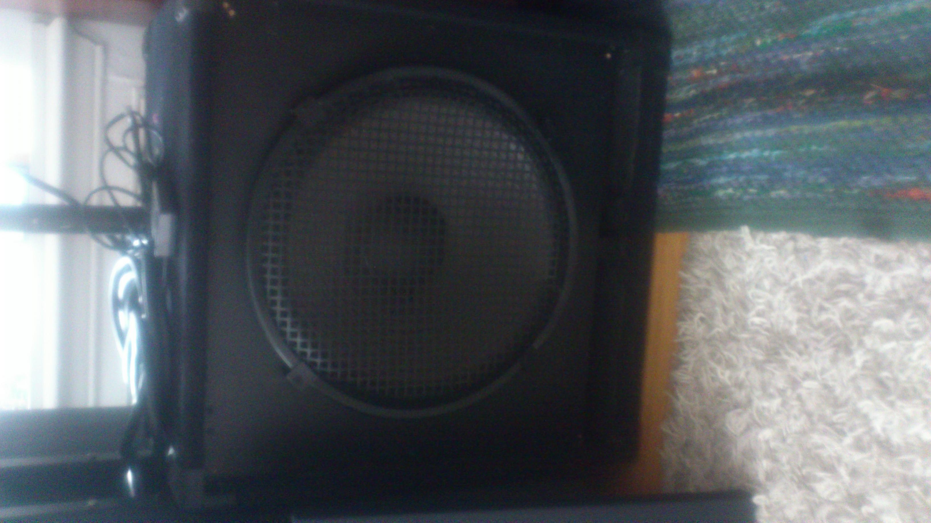

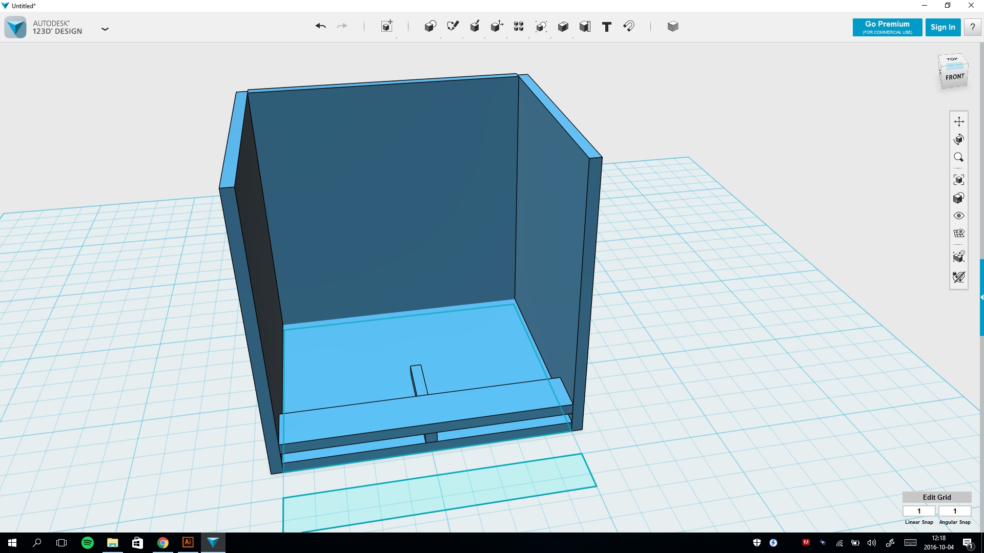

This is the unit. I realised though that it was propably how i tested that gave those results. I Had the xover at 900hz, and then set the volume for the bases and tops to get a good mix. Then turning down the xover to lower hz, the tops had to take more of the output with the same power, thus giving a decrease in volume from the tops. maybe.
I tried to see at what point the cone stopped moving using a tone generator online. but honestly, i didnt really see it move at any frequency. Meassured it instead:
Height: 51,5 cm
Width: 50 cm
Depth: 44 cm
port heights: 4,5 cm
depth of "port roof": 8 cm
Depth of port separator: 20 cm.
What now to do with this information? This seems like very useful knowledge for the upcoming subconstruction project!

If you place a bit of tissue paper hanging over the port area, taped above and free to flap, you can find the resonant frequency of the PORT when it moves the most.
Unfortunately that does NOT tell you if the driver is properly matched to the volume of the box and the port frequency. If it is homemade, it may not be correct at all.
The other way to do the xover frequencies is to run the sections separately, one at a time and see where they sound right and handle level properly. I'd run the low woofers alone, and then the mid boxes alone, moderate levels and adjust the xover frequency with music and then pink noise running... some EQ may be required to make each sound balanced as the xover point shifts... etc. The mid boxes ought to work to 200-300Hz, but if there is a problem doing that, then you'd have to discover why...

Here are pictures! Again, almost useless camera.
Height: 51,5 cm
Width: 50 cm
Depth: 44 cm
Are those internal cabinet dimensions or external?
If that is external and the boxes are constructed with 3/4" (18mm) plywood then I guesstimate an internal volume of 81L after subtracting volume displaced by the port and driver. That produces a box tuned to 62hz using a handy program called WinISD Pro.. http://www.linearteam.dk/default.aspx?pageid=winisdpro with this you can model driver response in a given or theoretical enclosure.
