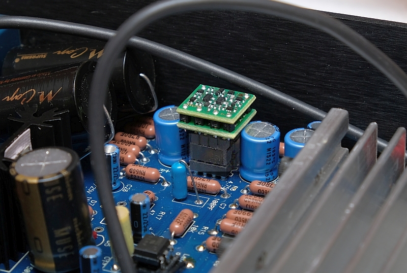

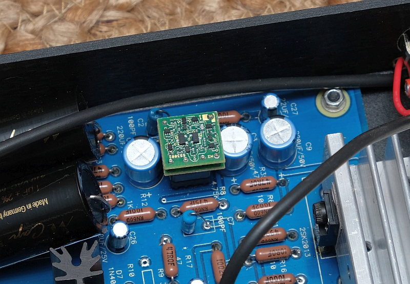

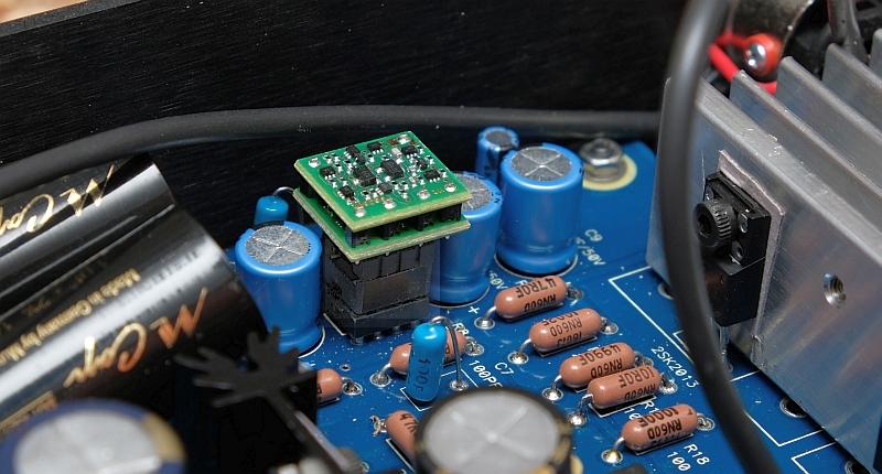

Swapped the AD823 with a Sparkos SS3602. Has turned out to be a really nice match with the rest of the parts. Voices are pleasant, mids are present without being harsh, the highs are crystal clear and soft to the ears. Definitely worth a listen. To my ears really makes all of Wayne's work shine.
Who is a recommended source for the Sparkos SS3602 devices? Quick search turned up Ebay, who absent a trusted seller I do not trust.
I take it they are quite a bit larger than the AD823 units? Any pics of how you wired them?

Straight from Home - SparkoS Labs Inc. Russell. I will take apart my HPA tomorrow and snap a pic. Sparkos sends a DIP spacer so it fits nicely above the two caps on either end of the socket.

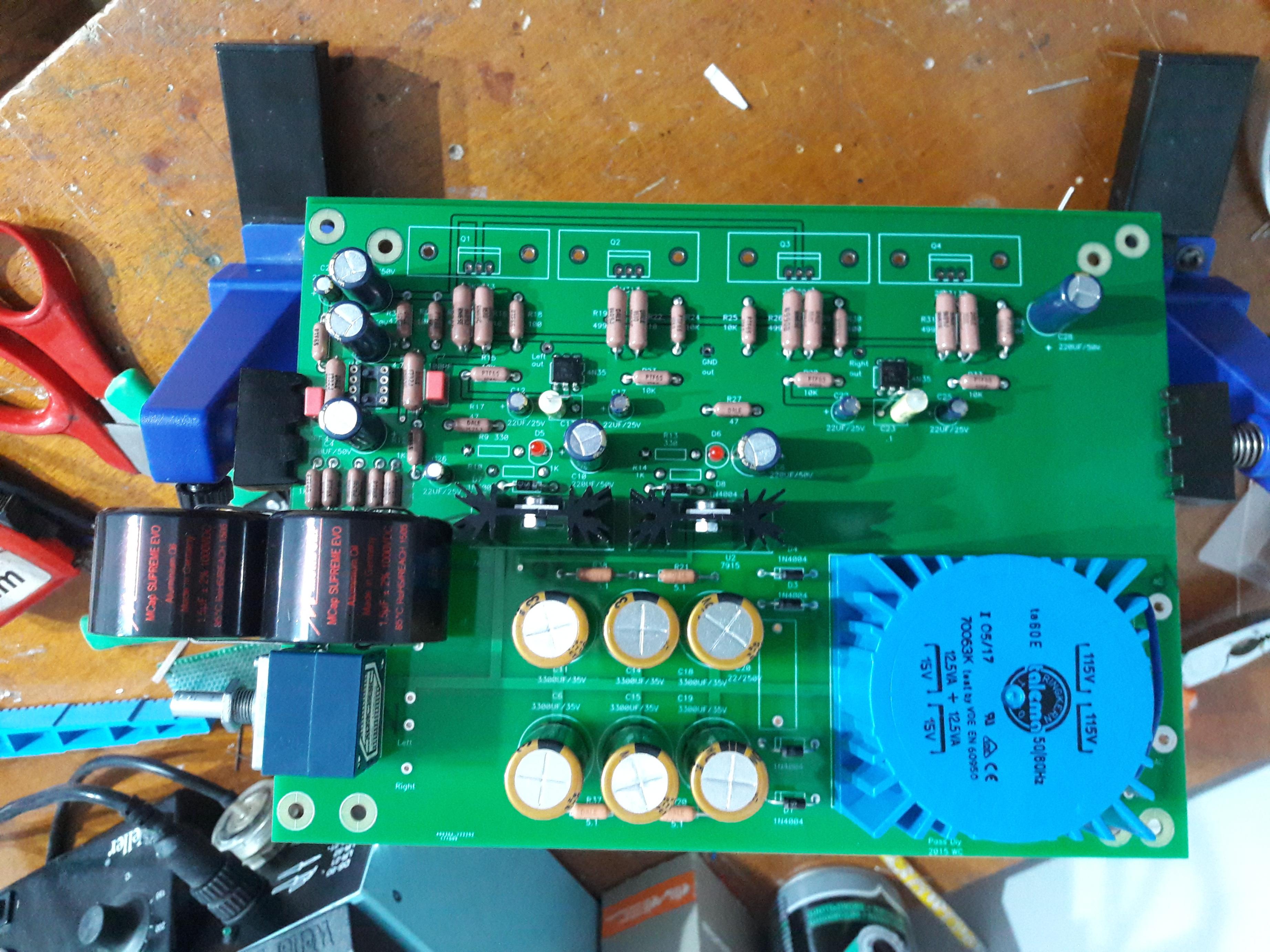

Here's my board almost complete.
I have used dale resistor ptf65 and rn60 & rn 65,for capacitors panasonic fc , nichicon fine gold, and Mundorf supreme evo oil, resistors are all 0.1%, matched led.
I'm waiting for 2sk / 2sj matched and then we can go to the test.
For the op-amp try OPA2228PA and OPA2132PA and maybe later discrete OPA

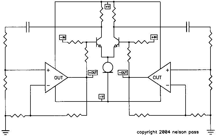

Actually, wouldn't it be good to have a circuit for a balanced version, and possibly with X-feed too - the 'THAT Corporation' chips work pretty well
Papa did a diagram like that for the gain clone chips.
