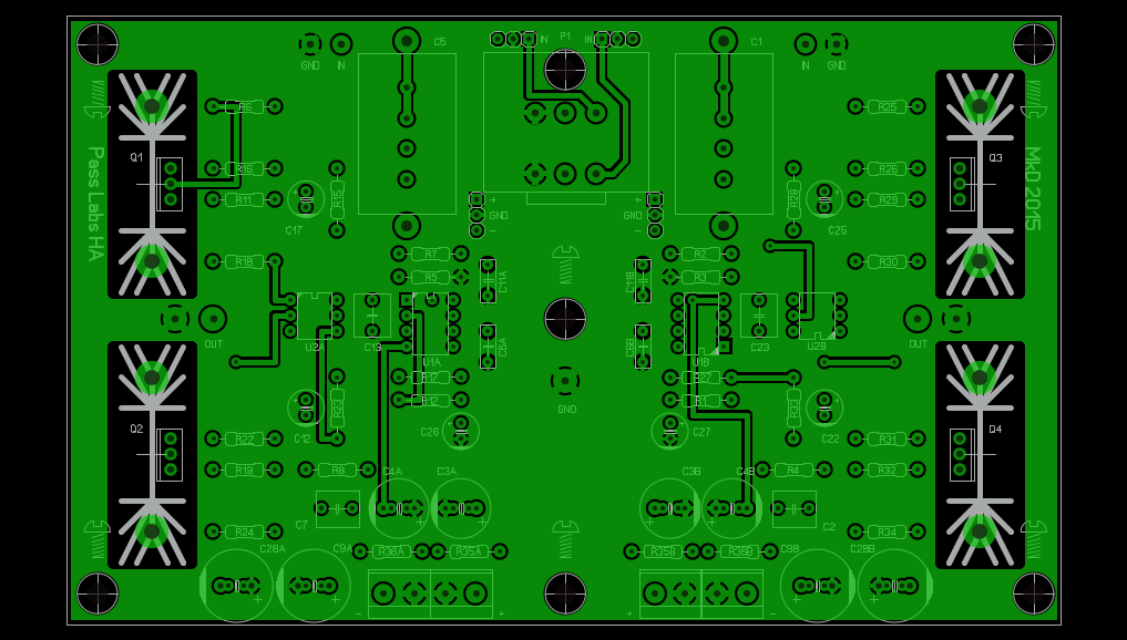

I placed a order at pcbway today 😉
Features:
- PSU for each channel
- Single OPA
- Stackable to my Universal PSU*
- Alps or my Muses direct mount

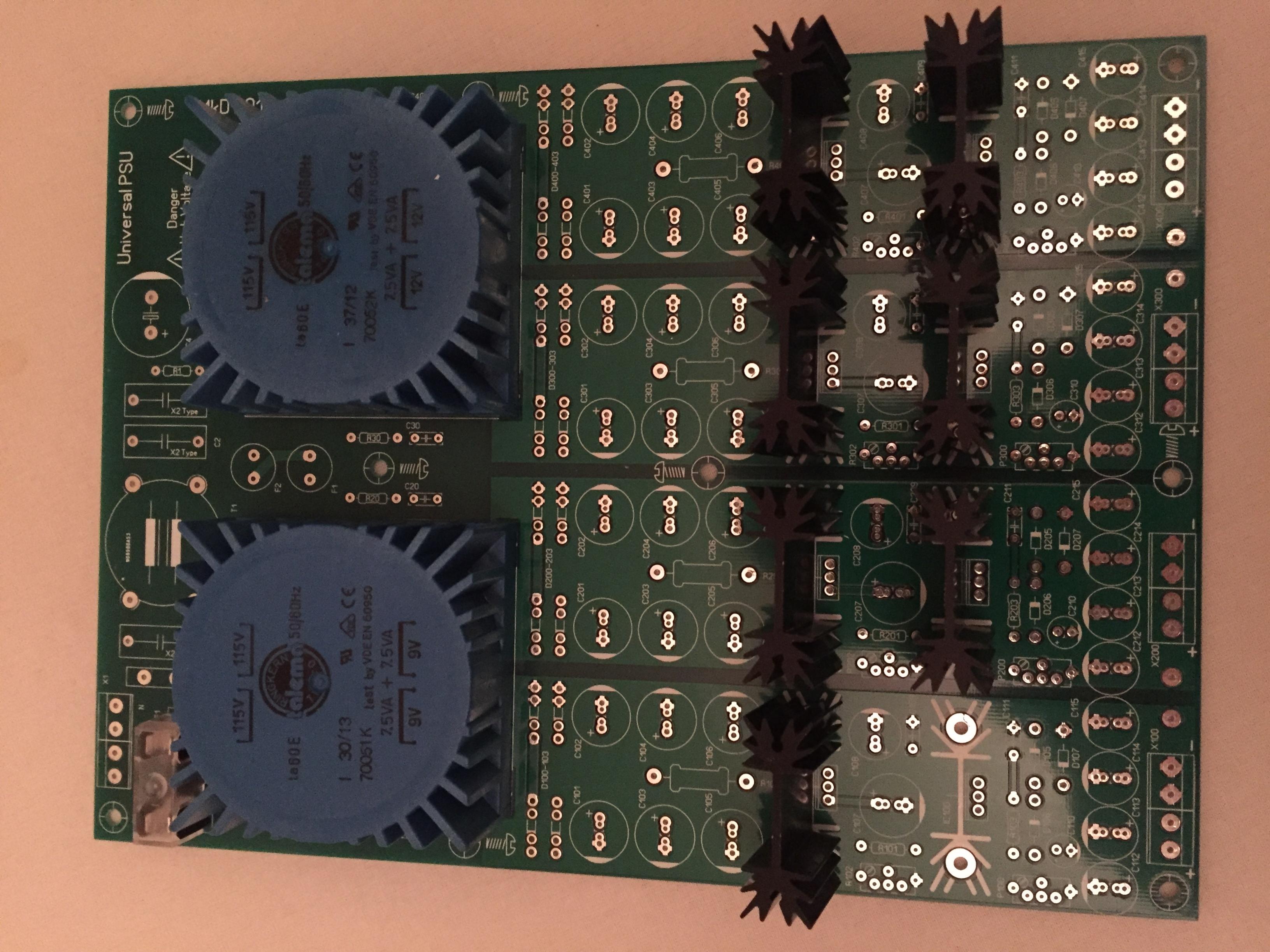

Universal PSU:
- DC / HF Mains Filter
- 2x 15VA Talema
- CRC + Capmultiplier + LT1086 or LM317

Universal PSU:
- 2x 15VA Talema
Wow they are fast. Where are they located?Here are the very good boards from pcbway.com
Off Topic:
China. Very good quality, good price and fast.
Only problem with customs.
On Topic:

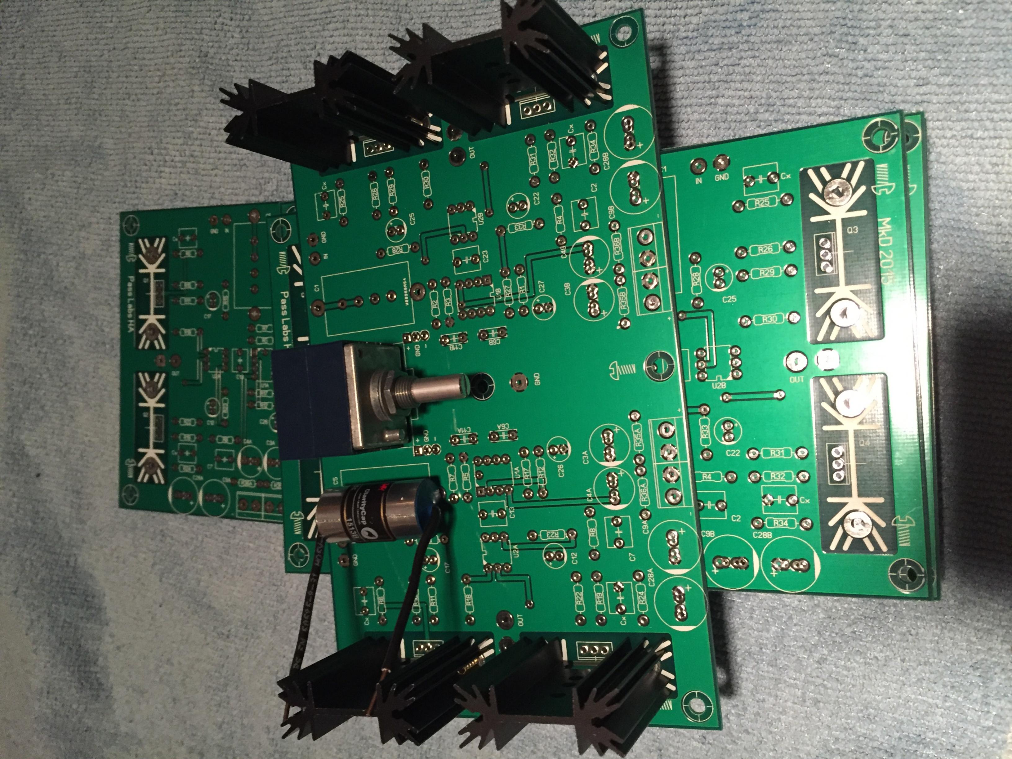

I will assemble a proto over the Christmas days.
Daniel
They delivered in 8 days??? How much did you pay?
Please send me a PN and use the online calculator from pcbway.com
The PCB are with 2oz copper, silk screen.
Daniel
Been wanting to try this gif - and this is the perfect time. 🙂 🙂 🙂
That PCB looks beautiful!
Thanks! I hope the sound is awesome too.
Daniel
Better looking boards than I did! It should sound good you may need to trim a little for compensation.
Are all resistors in the output stage 1/4 watt? I want to use the output stage as a source follower after the ba3 front end. Gonna put it together on perfboard.

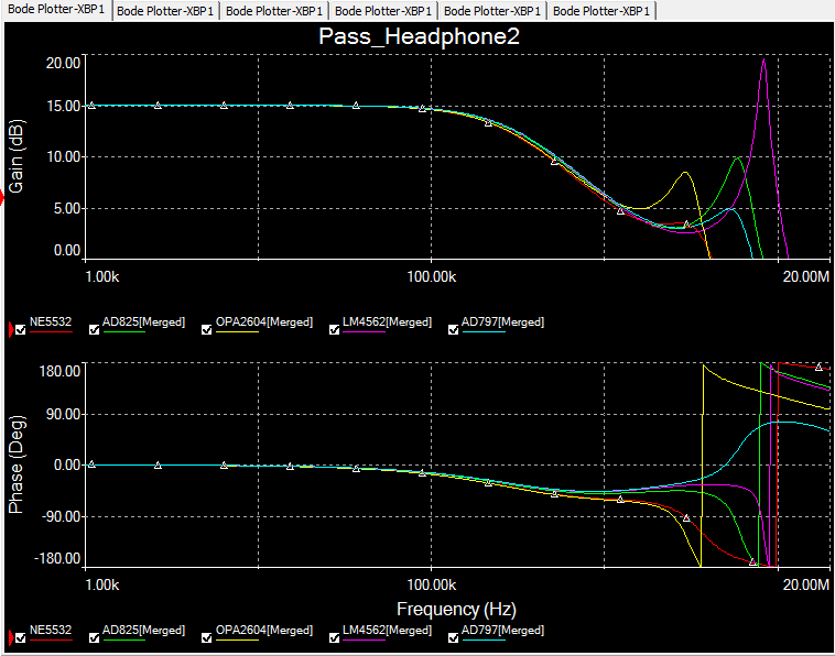

can you tell us the way to choose the right capacitor value?
In the shematic I read:
"C7,2 optional. Depends on OP Amp used. Sweep of frequency response and stability."
WHAT have I measure and WHERE?
Do you have values for different OPA wich did you implement?
Daniel
Daniel
