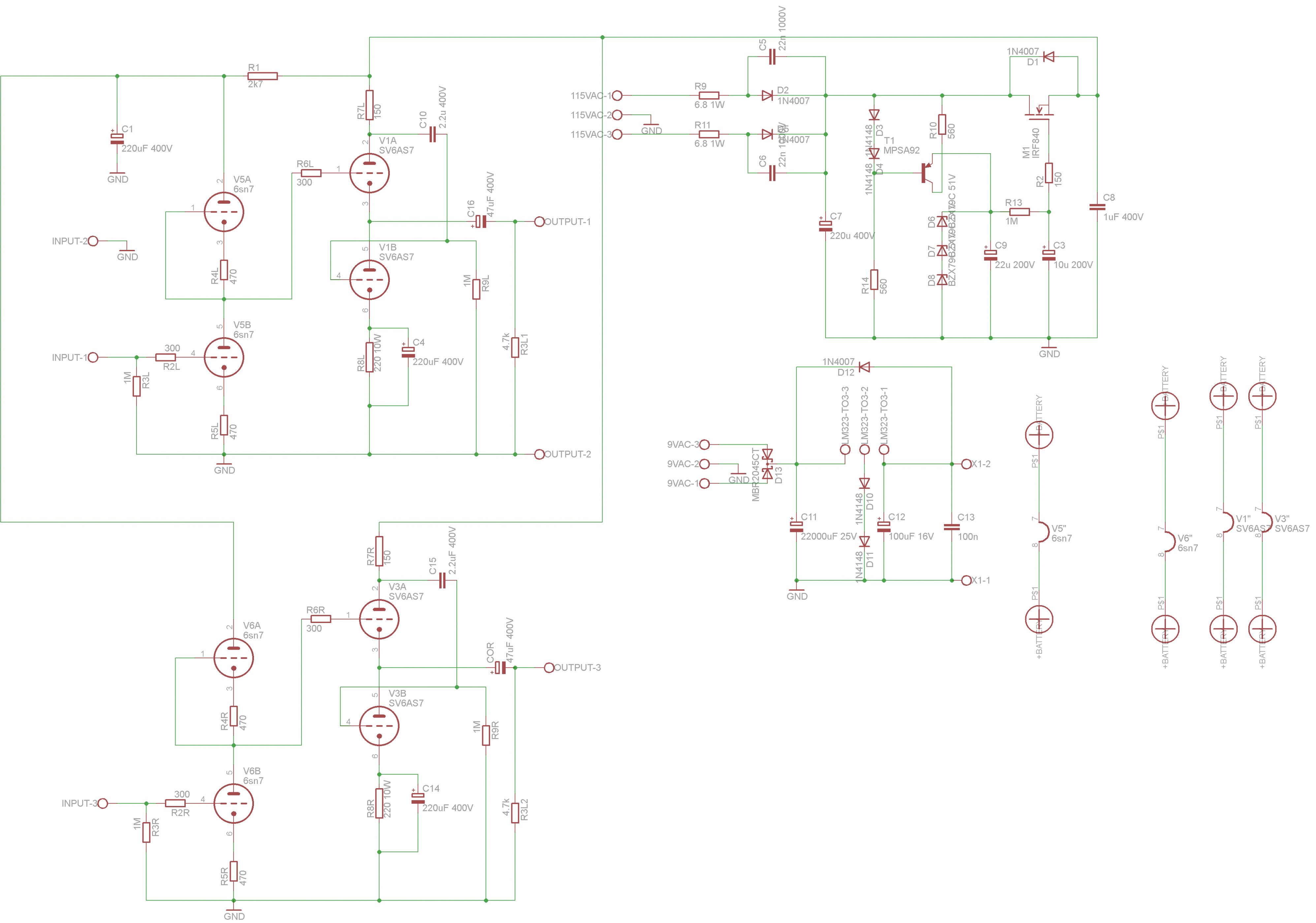

new schematics
New schematics. Power supply not modified yet...

I am afraid you cannot obtain exactly 150v B+, MosFET stabilized, with the 115v-0-115v transformer. After rectification you will get around 150v raw DC, but you need to have *at least* 10 volts over the mosfet (and preferably 20v or more), to insure good performance, low parasitic capacitance, low output impedance, etc.
Also, the two WCFs will draw serious current (I guess 80-100mA each channel), are you sure your transformer can supply that without overheating?
Ciao Tesla88
you are right. Looks ugly 😀 and the 4 octal tubes on that small amp are kind of dis-proportioned. My initial idea was much prettier and clean with the shielded tranny and the 2 tubes.
Furthermore the tranny I ordered was expensive and will be too small for the 4 tubes.
So maybe I go back to the initial design and modify the power supply to more easy with a choke.... 😡
thanks and greetings to italy 🙂
Chris

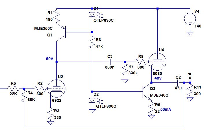

So either 160Vdc/130mA or 320Vdc/80mA. If you insist on using the 6080, we're stuck with the first option.
Let's try to use what you have. The ecc88 has too much gain. We can use some to add feedback and linearize things a bit. The 6080 doesn't have much breathing room on 140Vdc... let's ac-couple the stage and add some CCS. With your transformer and those tubes, I don't think you could do much better than this. And I'm gonna get crucified for suggesting that much sand.
Btw, I think there's a way to use your current transformer for heaters too if you use a lm2596t DC-DC converter. The to-220 version (not the smd one!) will do 3A if heatsinked (there are boards for cheap on ebay). Its efficiency gets (a bit) better as voltage goes up, so it would better to use your secondary windings with a bridge rectifier to get 25Vdc before stepping down. And you might want to put a big common mode choke after the converter.
115-0-115v with 30VA
9-0-9V with 50VA

Chris, with that xformer you'd better stick to the original ECC88 circuit.
You can always build the other one later on and then we'll do it properly instead of trying to shoe horn existing components into a service they were not designed for.
Ciao, 😉

Frank, probably you are right. Better to concentrate on my "bigger" SE KT88 project later this year where I would like to take less compromises (and there I will ask first before buying parts. Getting some help of you there would be highly appreciated 🙂
Ben, thanks a lot for your simplistic design. Looks interesting. you don't have schematics for the the power supply by hazard ?
The solution with the 2956 switching regulator sounds interesting and indeed there are many cheap modules on ebay, but all of them with SMD 2956 versions. But there are not many parts, and as already stated, I have lot's of spare time in the office to make a small pcb for the to-220 version with a heat sink.
So instead of reverting back to an old design I have a new alternative, great.
I'm quite fond of this simple reg by Elvee . I'd keep your psu as it is but replace the zener follower by one of those, set at 135Vdc.
As for the 2956t, I've found one board on ebay . The TI datasheet for the lm2596s is very detailed if you intend to design your own board on the other hand.
