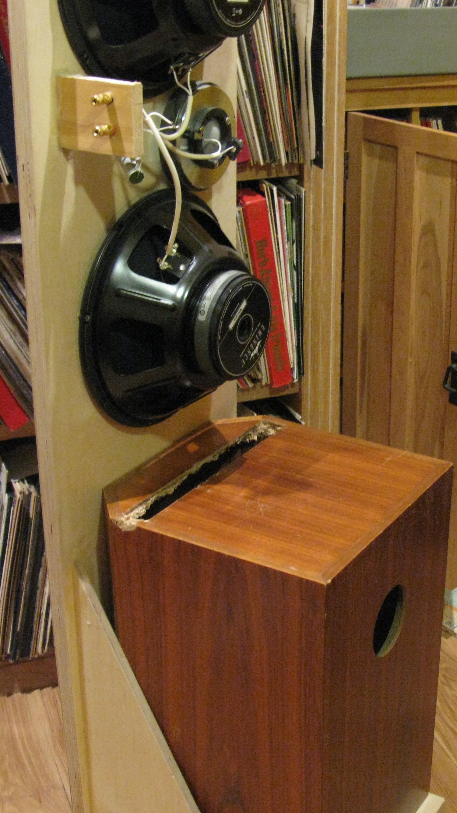

I certainly don't need another experimental project taking up space, but that won't stop me. It stands to reason that if he is getting enough sound output down low with such a low Q driver that it could only get better with a lower mass corner (is that the right statement in this case?). Dammit, I'll do it. Any suggestions where to start? Without any other ideas, I suppose an enclosure suited to generate reasonable bass if the speaker were in a standard arrangement is a good place to start looking. Someone earlier on said that there was another commercially available system that used this unbox principle. Any links?
If it's just an experiment you only need to make one. It should be pretty easy. Take any fullranger ported box that you already have on hand - as you speculate, it should be just about the right size, at least for initial experimentation. Take the driver out of the ported box. Install it on a narrow baffle. Take the ported, driverless box and cover up the driver hole. Install an opening (or port) in the driver hole cover. Now it's a helmholtz resonator with an extra opening. Simply place the opening in the resonator near vicinity of the narrow ob. Listen and measure. Adjust the opening and port accordingly. If you can't get a reasonable tuning, try tapering one or both of the ports. Also, like a guitar, if the box is big enough and you don't need very low bass performance you could plug the port right up and not use helmholtz resonance at all. If necessary, you might need to adjust the size and shape of the baffle, and driver position on the baffle, but probably not much. Once it's tuned, if there's too much bass, reduce the size of the double ported box. If there's not enough bass the ported box needs to be bigger.
That's pretty simple and should give you plenty of info, enough to build a final version.

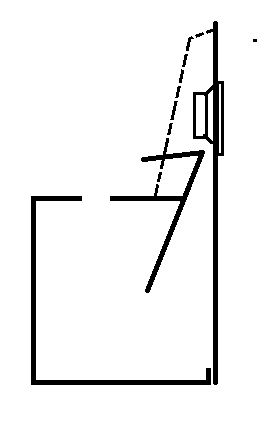

Having never built any open baffle speakers you might take the following with a large pinch of salt 😉
Looking at that design i think it could be done better 😀
The slot gradually widens as it drops down into the lower enclosure, this should spread any resonances - so far so good. It's the coupling to the driver that looks suspect to me, far better to have the variable slot all the way around the periphery of the driver rather than one edge i'd have thought? That way you actually might get some useful damping of the driver cone itself, whilst still leaving the speaker as an open baffle.
If anyone doesn't comprehend my madness i'll attempt a crude drawing 😱

Interesting design if it really works and provides enough bass to justify the build. Looking closely at the drawing on the part 4 article, it seems there might be more going on here. It appears that the bottom of the baffle board doesnt solidly attach to the box (gap), hence the addition of the reinforced lip. Maybe attached with flexible adhesive? If this is the case, does the baffle act as a cone since it can freely vibrate? Also, the port under the driver expands inside the box so some sort of horn loading thing also going on too? Just some quick observations and queries.

ok as I was so keen on my own open baffle project i am ready to try this test, not for bass extension etc. but for what i perceive as missing harmonics. Here is the photo...... what a lucky fit. Had these in the shed pair... of old reynauds ....had a gap already on the top for a tweeter and the port at the back was for the crossover. Unfortunately both the f5 and oto are both under testing, so might not get round to testing them till Sunday.
But there's nothing to indicate that the baffle does not attach solidly to the side pieces. Being loosely fastenned to the botton only would not allow for too much free vibration. Or would it be just enough...?
Not horn loading, but spreading out of the peak resonance, theoretically (and probably actually) flattening out a sharp spike into a wider and flatter hump. Air flowing past the mouth will tend to excite a note closer to the original driver's sound rather than a single pipe hum. Audio Joy looks like a good candidate for feedback since he is quite familiar with his setup as evidenced by his long build thread and listenning impressions. If there's any positive changes in sound, then I'm on board.
