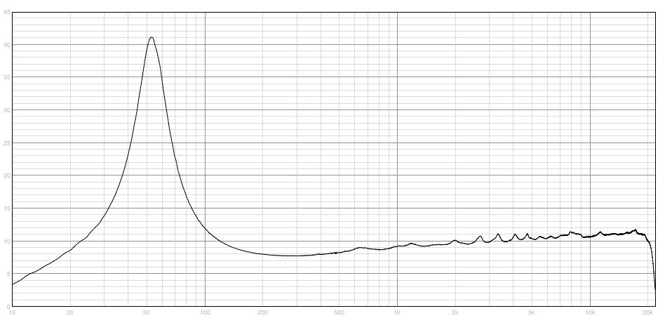

I'm used to, and willing to put up with the few bumps i see in the Fostex i'm most used to, but i was quite concerned when i measured a literal "ripple train" in the imp of the AN10 & AN12 (similar to what the factory data is showing for the Cast 15). AN10 imp attached.

Actually, the 'ripple train' is pretty obvious in the original AN data graph from commonsenseaudio for the AN10, so it shouldn't have been a real surprise if I had been paying attention to the specs.

I could never get excited about them, so never looked closely. If i had i would have been moaning earlier 🙂

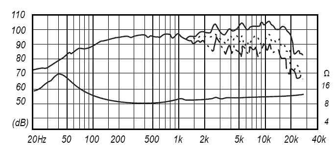

PS: I'd be very interested in seeing proof that those bumps in the impedance curve show up/make a noticeable difference in an actual freq response curve using calibrated equipment of some sort.
They will do, as one is linked to the other. For e.g., you can see it even on the heavily smoothed Fostex plots, like the one attached (from the 206 if you're interested). Exactly how audible it is depeneds on the driver & to an extent, the listener of course, so as always, if you like what something does, & you are listening purely for enjoyment, that is the only measure that really matters.

Thanks, Scott.
Looking at the 206 plot you posted, it's obviously a pretty complicated situation.
Sometimes a bump in the impedance curve has an effect on the freq. response curve, sometimes it doesn't , and often there are bumps in the freq. response where the impedance curve is 'flat' !

You should be able to find some info with a search... impedance curves are a pretty standard tool for searching out resonances. The big one at the Fs is a particularily obvious one.
dave
