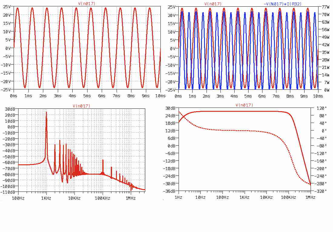

Yes Zen, the bias current is a bit high. You adjust it by altering R6 and R11. Increase the value of R6 to decrease the bias current in the pnp (Q10) side, increase R11 to decrease the current in the npn (Q9) side.
It's set high in the simulation to balance the npn and the pnp halves of the amp for the majority of it's operation, giving mostly class A operation.

Apart from the troubles which started this post, i think the A-100 can be set up far better than the original.
Attached is a LTSpice model of the original A-100 power amp, also a screen shot of test results from this circuit.
