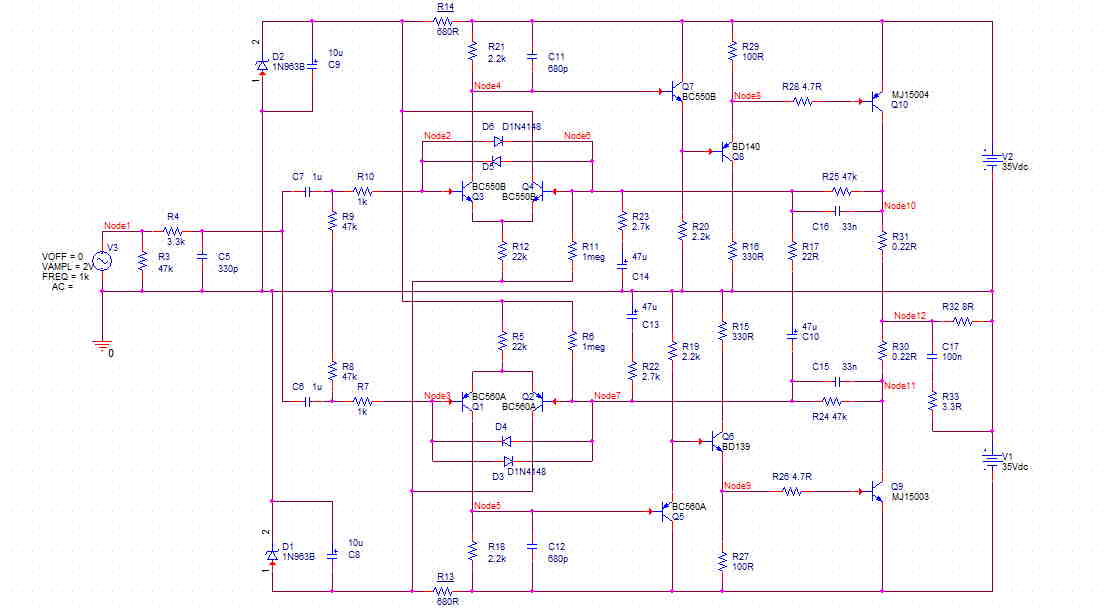

Ok, i've got one of these old bipolar tranny amps. i bought it with a fault - a roughly continuous >200kHz ring on one channel.
i've stripped and re-built it, replacing all electrolytics for +104°C versions, replacing all bipolars with hFE matched pairs or quads. Still it rings.
"Yes", you all say, "throw it away and buy a decent amp. Before it burns your house down". Yes good, however i'm a fan of the designer of this amp's work.
Anyway, tracing out the circuit diagram of the power amp section i got this:
Any thoughts folks ?
xx.
Hi Redbeard,
Didn't see you first post. Welcome to DIYAudio!
You did a good job so far. The schematic is too small for me to make it out properly. Check the resistor and capacitor that make up the output zobel network. If either goes open the amplifier will be unstable. This network goes from the output to ground.
-Chris
this amp looks quite similar to my TGM7 amplifier - it was an extremely high gain bandwidth amp that took some effort to tame in terms of oscillations. At 200kHz it could well be instability from the global feedback loop so I'd check the compensation caps (like said already, hard to see the low resolution image) of which there appear to be several, including those on the base-collector of the drivers. Wiring is key too, any output signal currents invading the input signal ground will give big trouble.
Just for test purpose try increase C32 like x10 or more. Same goes for its counterpart C22 (? I can't see values properly). So if it's a compensation issue this is supposed to cure oscilations. Then step by step try lower and lower values (keep these caps closely matched) to find the safe limit.
Of course, bad contact could also be the cause.

By "lag caps", you mean the ones in parallel with a resistor (collector of both output transistors to base of input stage long-tail pair, and +ve and -ve supplies across collector load resistors of other side of long-tailed pair ?
i've attempted to post another copy of the circuit, this one from spice, to be a bit more legible. When i've swapped the capacitors and had a play about i'll report back.

Yes, there appear to be four zobels in this circuit, one on the output where you'd expect, one between the two phases of feedback and one to ground from each feedback leg. That's a surprising ammount of impedance matching or phase shifting.

Chip_mk, ok, i started with the wrong ones - C15 and C16. Upping these by a factor of 10 has stopped the HF oscillation. This week (when i have time) i'll gradually reduce them until ringing starts again then up their values as you suggest. Or would i be better starting with C11 and C12 ?

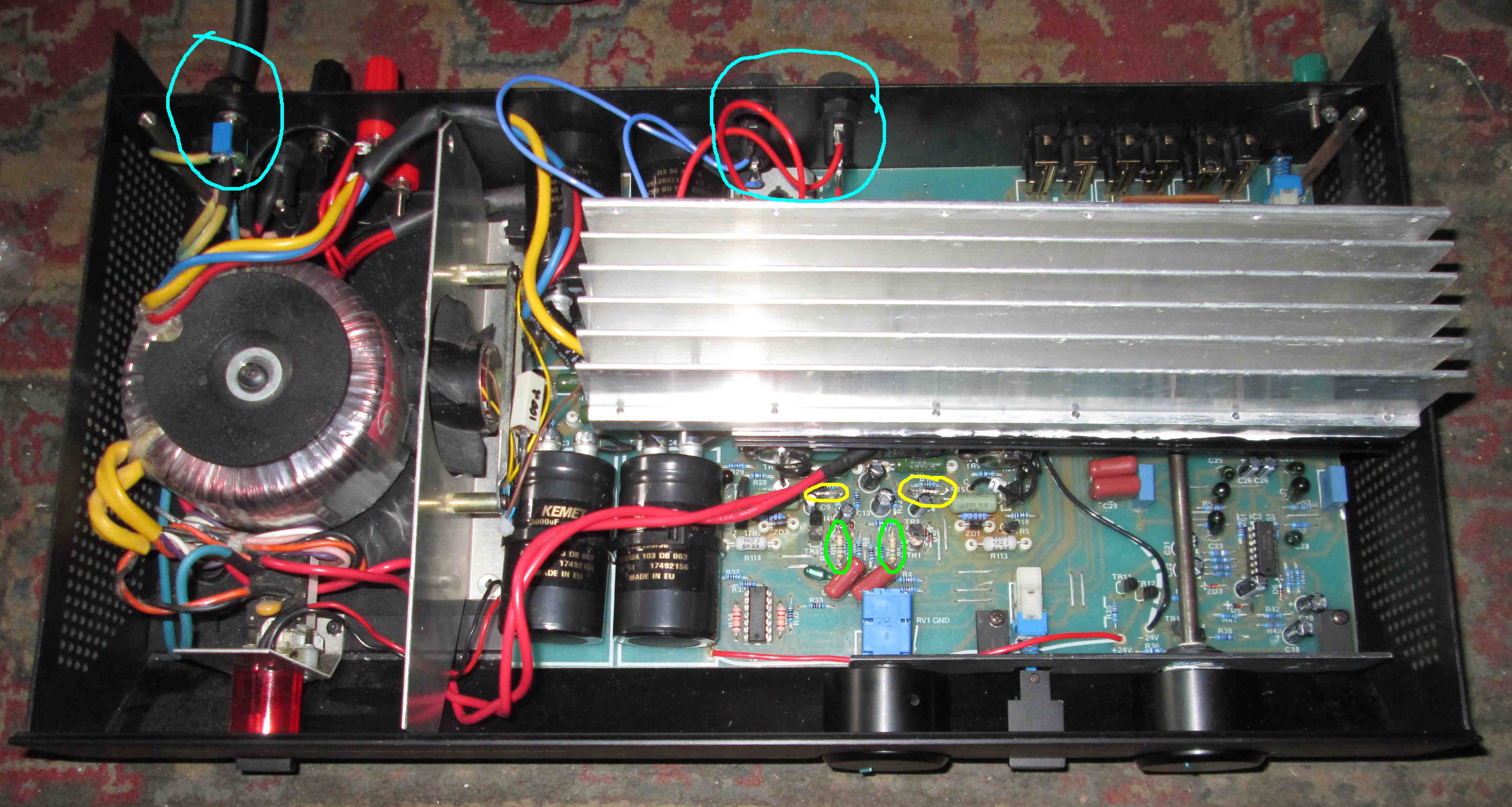

Attached photograph shows the state of play at the moment.
Ok, the story so far - i changed C15 and C16 for 10 x value (i.e. 220pF) and the oscillation stopped. However, i'd also changes the two "bias" resistors (R6, R11) from the fitted 5.6MΩ to 2.4MΩ to see what that would happen.
The amp sounded great, but thermally shut down after about 20 minutes. Hardly surprising as i was biasing it hot and the attached heatsink (the silver thing scrounged from the scrap pile at w**k) only allows dissipation upwards, isn't of of as great an area as the proper lid, doesn't allow the fan to properly channel through the inverted "U" section as it should &c.
Last change was fitting "Vero" forked pins to the mounting points for R6,11 and C15, 16 to allow for easy component changes from above.
R6 and R11 were swapped back to their original values, C15 and C16 were changed for 100pF.
Last run, the left channel oscillated and sounded rotten but the right channel sounded alright, so i swapped C15 and C16 for 150pF.
Prodding showed that my soldering is dodgy. Back to the soldering board ;o)
On the photograph, the left-channel parts under investigation are circled yellow and green. Chassis modifications i have made are circled pale blue. +VB and -VB fuses, thicker mains lead with earth, earth-lift switch (closed, the chassis is earthed, open the chassis is earthed through 200Ω).

Design flaws: The circuit of the A-100 is practically taken straight from the A-1. As a result the +/- 12Vdc rails (for the "tails" of the LTP input stage and also for powering the drive op-amp) are really cooking. In the A-1 (running off +/- 25Vdc or so), R13 and R14 may be right but in the A-100 the resistance values are far too low.
The "tail" of the long-tailed pairs draws very little current, almost all the current through R13 and R14 has to be dumped bu the zeners. In mine i've doubled the 680Ω's to 1200Ω and they still cook. Next step is 2.4kΩ.
