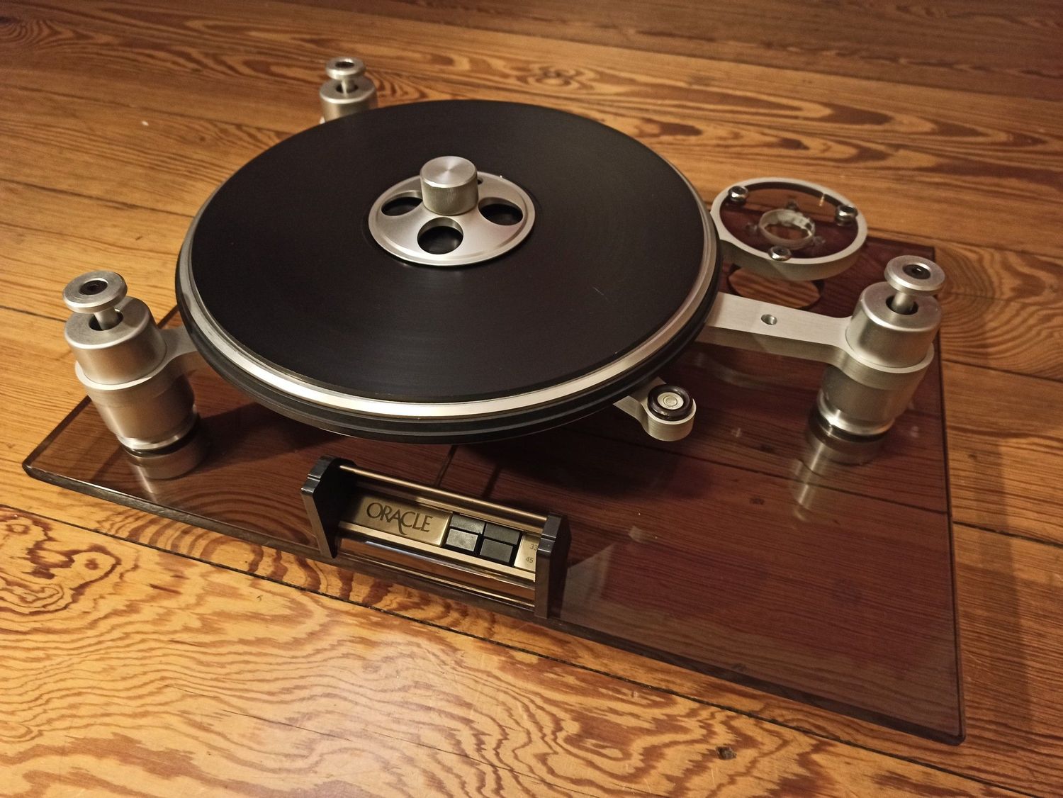

Thanks, i will search for Maxon. Today i was cleaning the Delphi for two hours. It is a real beauty ...
Thanks for the information about Maxon. Maxon 110191 + Maxon LSC 30/2 controller is the way to go. I already found& bought for 50€ LSC 30/2 on ebay and i will buy new motor directly at Maxon. Now i have to think how to mount it properly.

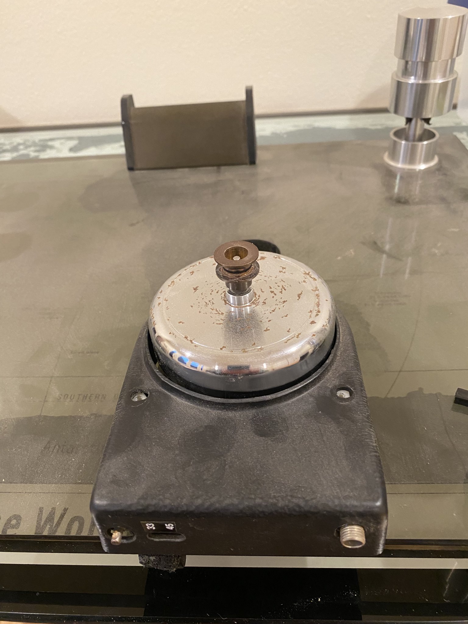

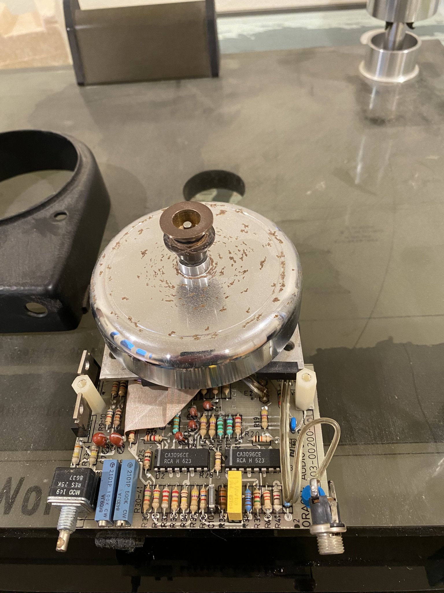

I have a Delphi Mark III (serial number 7955) which is exhibiting some strange motor behavior.
I am not sure what kind of motor is installed on my particular Delphi.
Wondering if it is the same as your Delphi motor.
So I enclose a pic and am asking you if this is the same kind of motor that you have and that you discussed with Jacques Riendeau of Oracle.
If yes, and if its not too much trouble...can you share with us the instructions you got from Jacques regarding how to
"properly align and set up the fully brushless armature and get it tuned perfectly" ?
Thank you very much.
Curt

Different motor… but I would suggest calling Oracle and speaking with customer service… they were really epic.
