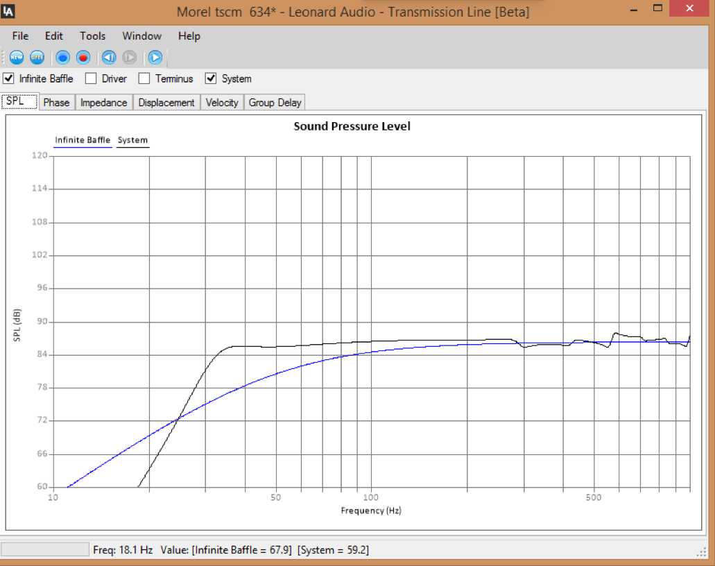

Had a quick look at the driver with LeonardAudio TL sim, and it outputs solid down to 30Hz. Very nice.
It's not cheap, but it looks fabulous.

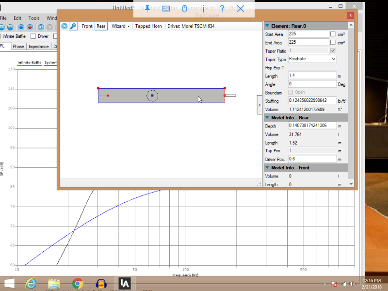

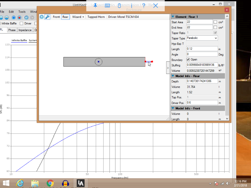

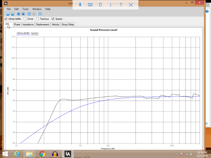

I had a few extra minutes this afternoon, so played a bit and adjusted a few little things to get a better response.
Cross-section is still the same at 225cm2, but length is 1.2m, Vent is 18cm2 and 0.09cm long. Driver at 55cm from the top.
Losing a bit of extension but flatter response.
Actually, it would depend on the room. Many rooms will pick up and enhance the bass, so, even if the sim looks flat, the speaker may sound boomy in some rooms that are very lively. Then, a slightly lower bass end would work better.
