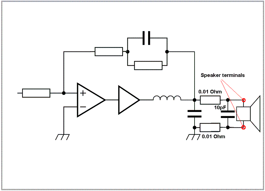

Anyone, even without any basic of high school, knows that the last stage of the audio power amp is connected direct to the speaker terminals, otherwise or it's not an audio power amp, or it's not a last stage!
In the attached sch. single voltage loop took off NOT at the speaker terminals, but before the Pi-filter. Does this topoligy violate the Philips patent?

I think it's very clear that taking feedback off the speaker terminals has been around for a long time just for simple concept demonstration. The 0.01ohm in the schematic above is the same as direct wire since lots of wire type would have the same resistance due to real conditions.

Not quite true, Bruno. US patent 4,041,411 from 1977 is a self-oscillating amp using only output voltage feedback.
The feedback is actually a UCD type compensation, allthough some smalll hysteresis is used in the forward path. However the hysteresis, could be argued, just has been put in in to speed up things.

Well I might clarify that you don't need to infringe upon all claims in order to have a patent infringement. It is sufficient that every element of at least ONE claim is shown to be used. This is what so upsets people about the UcD patent. It squarely claims every amplifier that uses a single voltage loop taking off at the speaker terminals. The reason why the patent attorneys who wrote it, felt confident to do so, is that before nobody had actually realised it was at all possible to use only the last state variable in the amp to take feedback from, so there wasn't any prior art.

You don't feel a very important difference - in this amp (like in all others) the feedback is taken from the last output stage, and in UcD it's taken from the speaker terminals!!! 😀 😀 😀

Edward_L said:You don't feel a very important difference - in this amp (like in all others) the feedback is taken from the last output stage, and in UcD it's taken from the speaker terminals!!! 😀 😀 😀
It would probably take you six months and hundreds of thousands of dollars to argue that very point against Philips in court, one of many I'm sure. Certainly the UCD is extremely patent worthy, regardless of which claim Bruno tried to argue himself, I think Philips lawyers may do a better job in that regard, he's an engineer after all.
