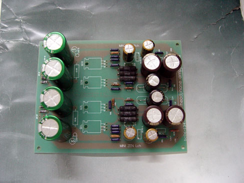

r_jik45 said:Hi Digi01,
Nice work, thank you for sharing it.
I suppose I missed something... but why are D1 and D2 (from the original schematic) not here anymore?
Have a nice day...
Yes,I have removed them.

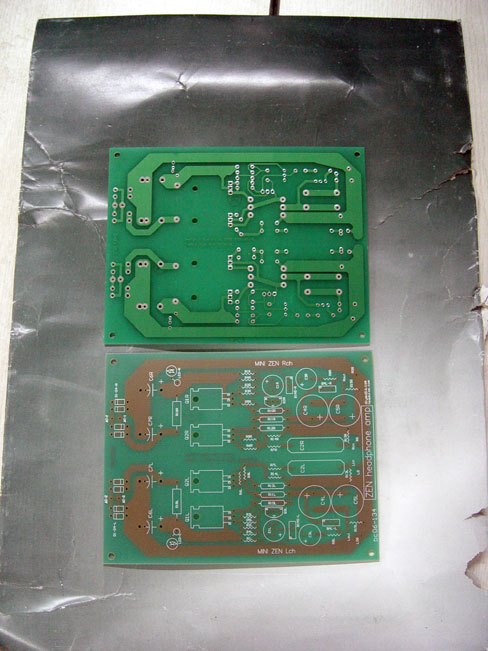

Hi Zang,
The boards look good.
One question: What is the recommended way of
mounting the mosfets? Do we just mount them
flat on the PCB with small heatsinks?
Thanks,
Dennis

Hi Zang ,
the boards arrived today ,
nice work !
Thanx again for this Group Buy
Greetings from Germany
Jürgen

thanks all.
Partlist below:
R1,R2,R3,R8=1K
R4=20K
R5,R6=220
R7=33K
R9=220K*
R13=100K*
R14=180K*
R15=470
R10,R11,R12=2.2,1W
R18=5.6,3W
C1,C3=100uf/35V
C2=4.7u/100v
C4,C5=1000uf/50v
C6,C7=2200uf/50v
D1,D2,D3,D4=1N4007
Yes,you can mount them flat on the top of pcb with small heatsink or mount them on the chassis.

Q3 position?
I'm making this amplier too and while soldering the parts I wanted to be sure regarding how to put Q3 (ZTX450/2N2222); for that I checked on Digi01's board in a previous post (LINK).
According to the attached file and to the transistor datasheet, the pin are E, B, C from top (Q1 side) to bottom (C4 side), but according to the schematic it should be B, C, E (B connected to R3, C3, bias / C connected to R2, R5 / E connected to C1, R10,9,11, etc)
So here is my question: don't you have problems when you connect Q3 the way it is presented on the drawing? Don't you have to rotate it in order to connect it according to the schematic? 😕
Thanks in advance for your reply,
And have a nice end of weekend.
