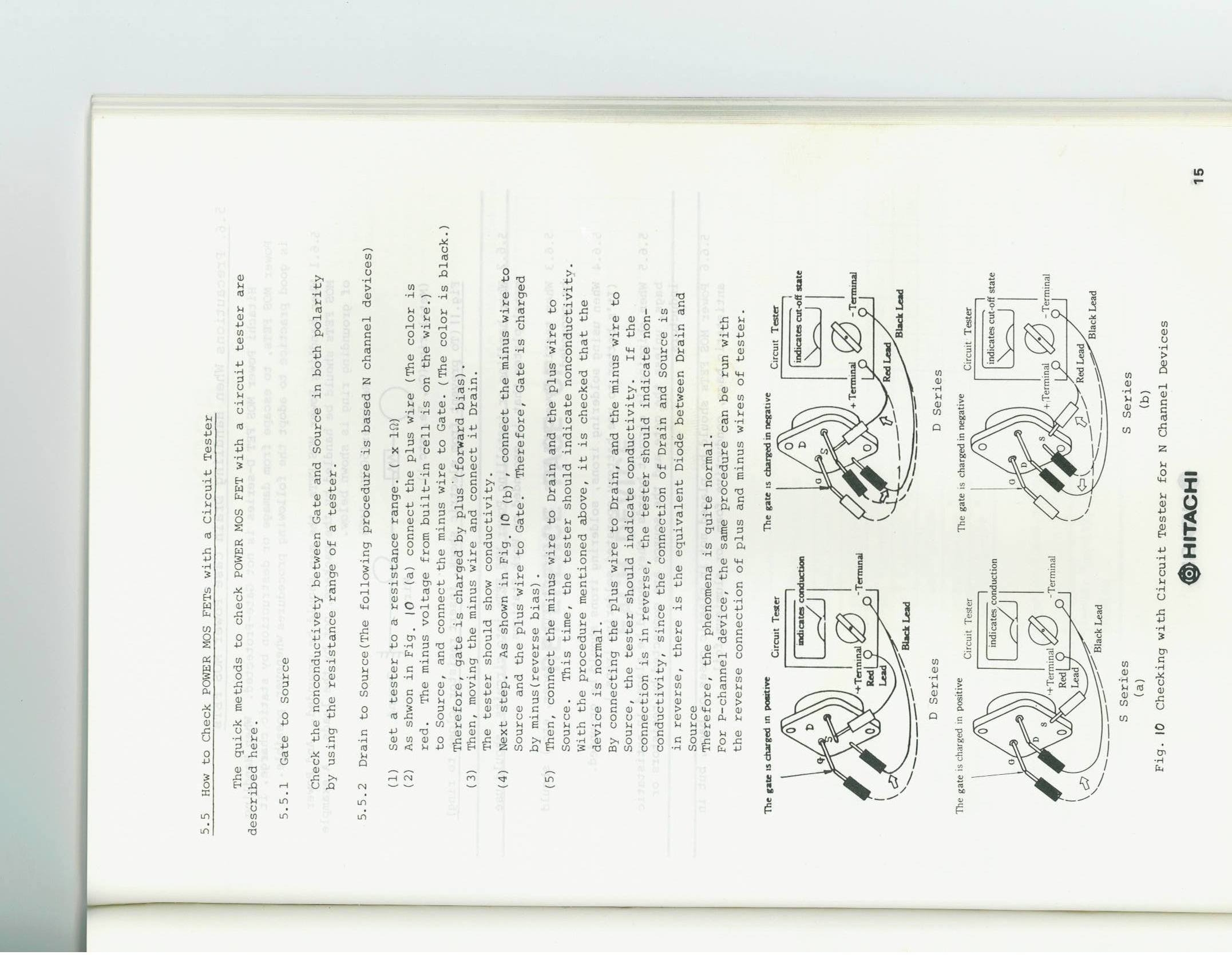

My first informational post will be how to test Power Mos Fet Transistors with a VOM. This is a page from my original Hitachi D Mos Power Fet Data Book from 1981.
