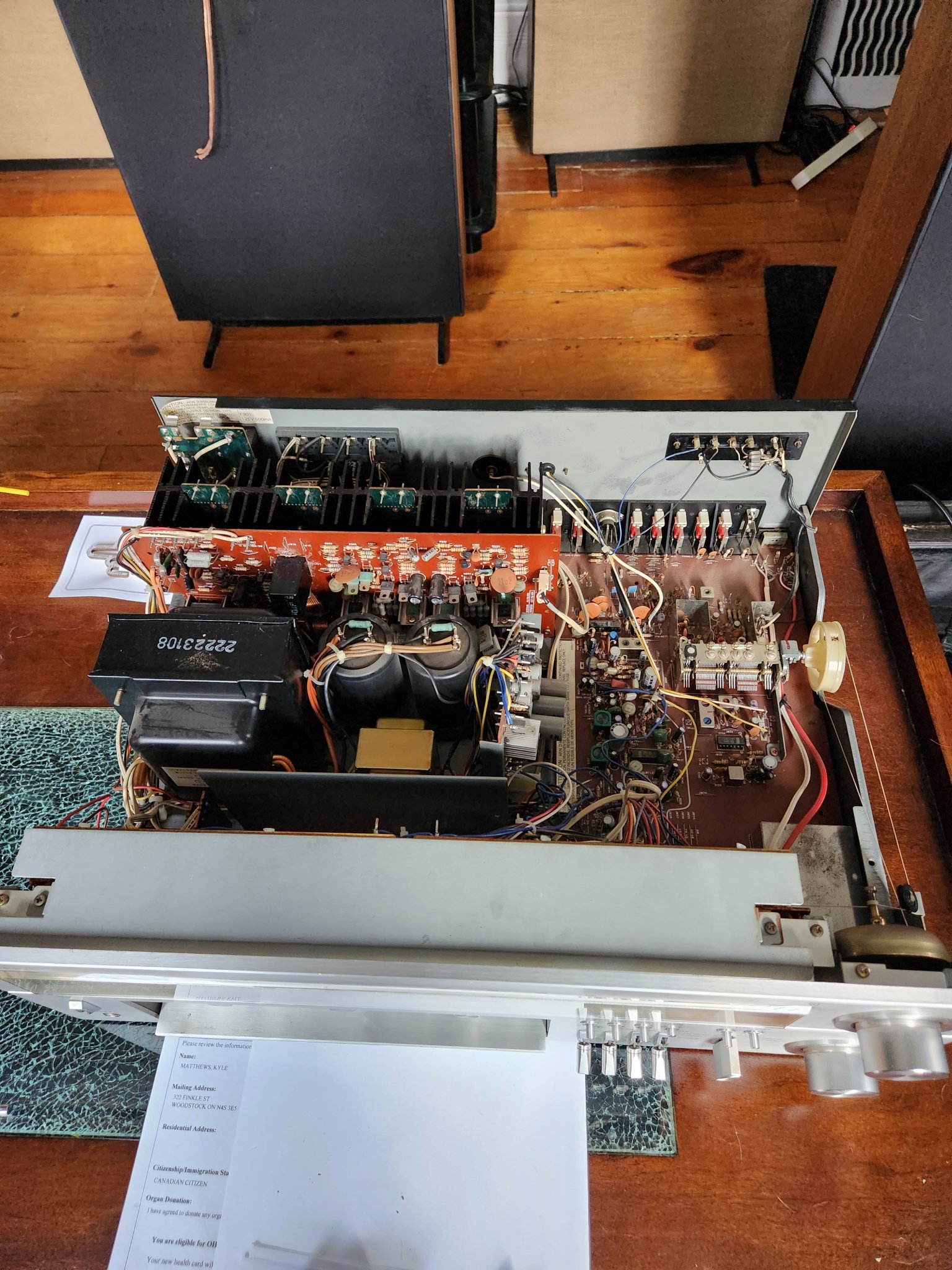

I have a new toy and I was disappointed when I found it dead, I removed the monsters cover (barn) and found its 8Amp fuse had been replaced with a 14Amp fuse and this was blown. I nearly spit my 🍺. The fuse it to protect the wire and fear this could get expensive. I am looking for a schematic online and will be looking for.a short.

Nice amp, designed by engineers who were paid by the amount of transistors they used in their designs. 😉
The manual is on Hifiengine but I upload it here in case you don't have an account.
First thing you need is a lightbulb in series with the mains to test.
If a 14A fuse is blown there has been a serious current flown...
