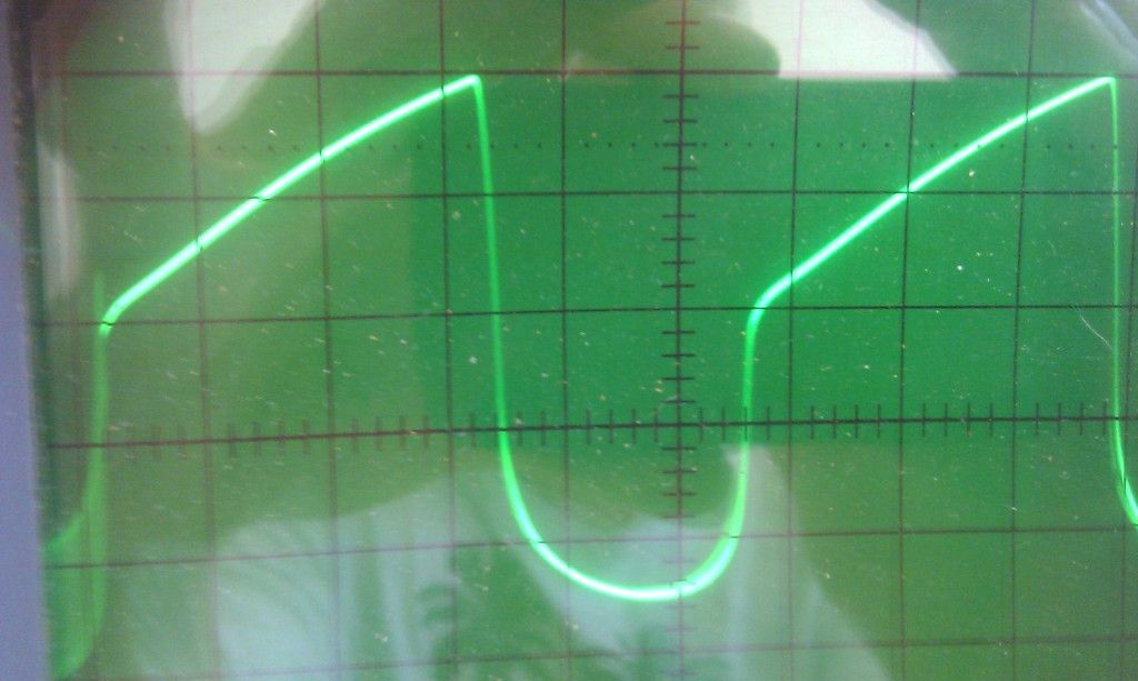

Ok, so I added the grid block resistors and it both brought down the preamp gain and stopped the oscillation at high preamp gain. Great suggestion, Thanks! There is alot of good info about the tone stack here, but I need to put that aside till I can meet the specified power and harmonic distortion output required of me for my project.
Right now, the amp is only putting out about 1.2W and is breaking up kind of early. I know, according to the datasheet, that I should be able to get 5.5W out at 12%THD.

This presumably means I can get more out of it at higher distortion. I measured the power of my 15W fender superchamp xd (6v6 PP config) and the max I could get out of it was 52W calculated with the RMS voltage across the load ^2 divided by the load resistance (8 ohm). The signal was very distorted at this point.
I should also say, how the test was conducted. I am putting a 300Hz sine wave in and measuring the voltage out across the dummy load (a big 8 ohm power resistor). I am increasing the input voltage till the amp saturates and stops putting out more power. Is this the wrong way to measure power? I get more out of my amp when measured across the speaker (also 8 ohm) but I know you can't trust this, because the speaker is inductive and the impedance changes with freq and changes with the position of the cone. In addition the current and voltage are not in phase.
With the sine wave input and my amp cranked, here's what the output looks like, and it isn't what I expected. It doesn't look like the typical clipping tube output, like a sine wave with the tops rounded off and slanting:
I am not sure if there is some strange phase shift in my circuit causing this.
I believe my power output issue is in the power amp circuit, because lowering the gain of the preamp (with the grid stopper resistors) did not change the power output of the amp.

screen resistor WAY too high
It is customary with the 6V6 to run the screen voltage very close to the plate voltage. Based on research I just did, that high value screen resistor is going to decrease the power.
The 6V6 sounds very good when the screen and plate voltages are close, with screen voltage of course a little bit less. I have noticed as you widen the gap between plate voltage and screen voltage, the sound will get more "dynamic," but you pay for it with what I call "pentode screechiness."
Not having the screen resistor bypassed is going to provide a form of negative feedback. in an appropriately sized screen resistor (1K or below) , this negative generally provides for less distortion, This being a guitar amp, you don't need to worry about that so much. if you are keeping the plate voltage at a reasonable level for the 6V6, why don't you try reducing the screen resistor?
BTW, your schematic shows input at the screen and the screen resistor connected to the grid.
it is helpful to think of the voltage dropping resistor (screen resistor) as part of the power supply, providing a voltage "tap." Obviously, it should be bypassed for voltage stability. THEN, you add in the screen resistor, 100 to 1000 ohms, probably on the low end, and attach directly to the tube socket.
make sure the grid has a high value resistor to ground or common.
it would be helpful to see everything, power supply included. Even selection of rectifier matters in terms of "tone."

Scopes don´t lie [tm]It doesn't look like the typical clipping tube output, like a sine wave with the tops rounded off and slanting:
What you see is the TRUE tube power amp clipping waveform ... one of them at least.

Now some REAL WORLD Scope captures:
a KILLER sounding Marshall 18W, driven full tilt:

Run out of image space, here´s more TRUE scope captures:
this is a complex but common case: the bottom push pull tube is almost dead of old age, has such a little cathode emission and voltage gain that it is too feeble to even saturate; the top tube is fresh and easily saturates BUT the very different current capability causes imbalance in the OT core, it is partially saturated and lost inductance, meaning it lost bass (see the upwards slanting top half wave) , a very complex waveform indeed:
asymmetrical distortion created by (very poor performing) concertina type phase inverters.
Power tubes reproduce this quirky waveform and add their own wild peaky clipping as shown in earlier examples:
to boot the cathode driven tube gets blocking distortion, while the plate driven one does not, this twists even more the output signal.
Overdriven preamp tube, showing input and output signal for comparison:
Well, now you clearly see the differenc between myth and reality.
And that such an easy to disprove myth goes on and on and on all over the place tells me that *many* (most??) who speak about tubes have not done much practical building or experimenting, but rather read a lot of Forums and write what seems to be the consensus or copy each other`s books or pages.
Mind you, I have seen the fancy unreal drawings even in respected manufacturers literature ("M.B." cough cough) who should know better.
