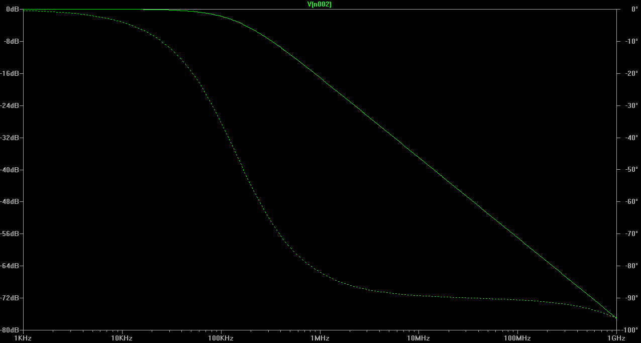

It has the potential for resonant peak but there's also a lot of resistance in series in this case. I'm using 5.6k in front of an EF86 in pentode mode, gain of ~50 so for a simulation I estimated 200pf Miller capacitance. The body of the Mills is 1/2 long, the inductance of 1" of wire 10 nH, so for the Mills an estimate of 20x was used, or 100 nH.
The result in LTSpice is shown below. It looks clean past 1 GHz. This is a rough estimate and neglects large inductive influences like input coupling caps, meter long interconnects, internal wiring, etc.. The Miller capicitance is also modelled as a perfect cap, i.e. self-inductance below 1 nH. If that's changed to 10 nH the response shows a strong null (no ESR in the model) just above 100 MHz and a clean rise towards 1 GHz, but by that point the model is so far out of it's assumptions it can no longer be trusted.
I think small value grid stoppers would be more vulnerable to this effect.
Edit: Forgot, there's 10 megohm in parallel with the Miller cap, it's a grid leak bias amp.

Did I displace a decimal? I though I read somewhere the value was 4 pf but that's what you get cranking this stuff while trying to be on time for work. To clarify the plot, it represents voltage to the input of the grid.
