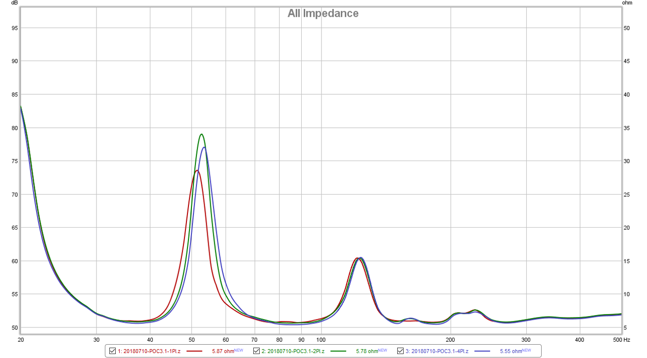

I'll just post this here as it might be relevant - impedance measurements of my POC3.1 TH loaded into 4PI, 2PI (on the floor) and 1PI (against a wall). There are definite changes in the impedance curve, which imply that the FR will change as well. The question is by how much.
Pulling the data from the graph, the change in the lowest resonance frequency is small (where the phase angle crosses zero).
At 1PI loading, it's at 37.5 Hz
At 2PI loading, it's at 37.7 Hz
At 4PI loading, it's at 37.9 Hz
Note that at 925 cm^2, the mouth of this TH is pretty small. I expect that as the TH's mouth gets larger, the changes will become more significant.

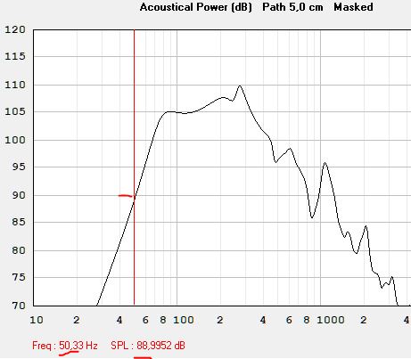

They way I read 'coupling more = more bandwidth', if you use multiple cabs, lets say 8. You do not need to drive them to xmax to reach the operation level (volume) of the location/venue in question. Thus you can lower the HP filter and thus get a wider band without destroying the driver. it's much more logical and makes more sense than 'magically appearing' octaves.
hmm wait it can happen. If you have one Cab or 8 cabs. the lower range got more output automagicaly see below images, 1 cab vs 8 cabs:
90db at 50hz
90db at 26hz
