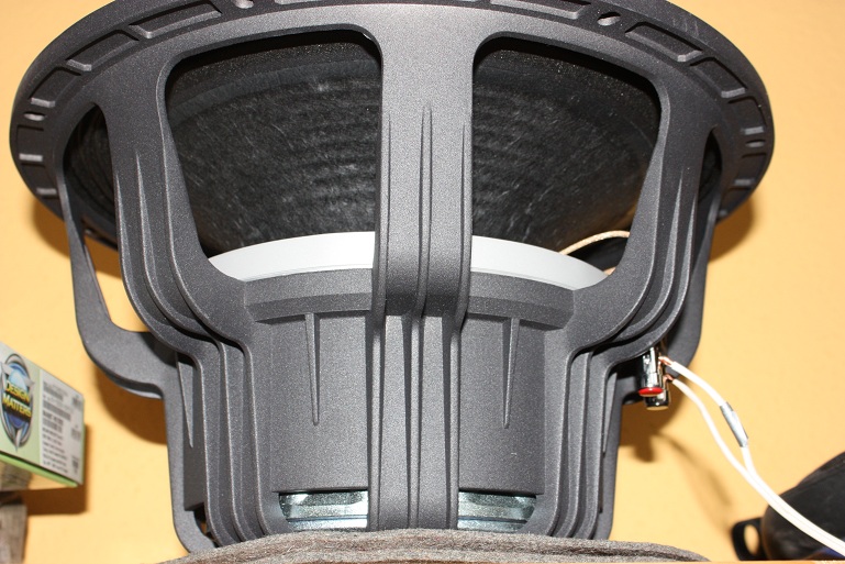

meet my modern sub hammer
I use it in closed box for bass guitar
clean and strong
What are you powering that with? I play bass as well.

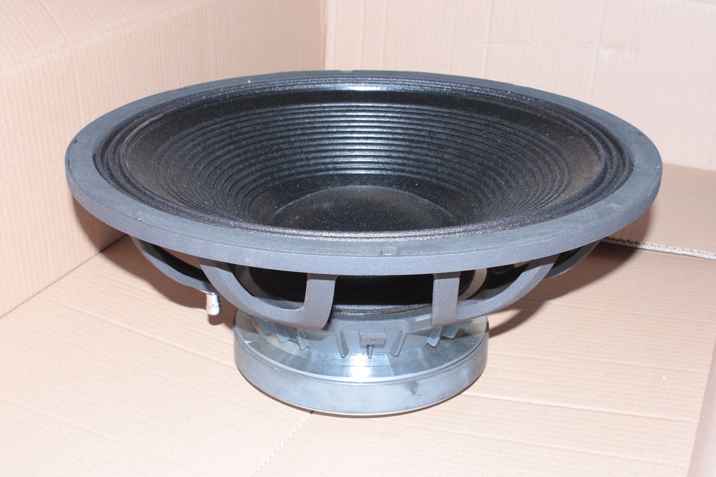

maybe, but I will never buy cheap semi pro woofers again
but did get this one cheap, on sale
GOSH! ... 18" really is BIG 😱
(unfortunately they also delivered a damaged one 🙁)
just getting excited, sorry 😀

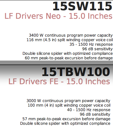

you mind posting the specs for the 15tbw100 4? I modelled it with the 8.
even the lab 15 gets you more low end response (just no hump)
Here is the spec sheet for the 15tbw100-4, along with the spec sheet for the 15SW115-4, thanks to the guys at B&C!
I don't doubt that the LAB15 will play lower as you had stated previously, however I needed the power handling of the B&C to be able to safely handle what my amp can output.
F3 for the Dayton HO's was around 33.5hz, with the 15TBW100-4's it's about 30.75hz. The B&C's are about 1 db less sensitive at 40hz, but are 6 db more sensitive at 150hz, which should provide for some greatly improved kick drum action from the subs. I currently low pass at 190hz, 4th order BW, but may switch to a lower order.
meet my sub hammer
clean and strong
15"
15mm poleplate
30mm voice coil 'height'
Qts 0.33
Fs 38hz
VAS ? ... 80 liter
