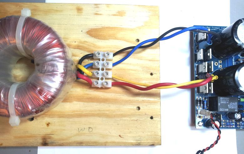

Hi all, Here's the latest installment of my build....

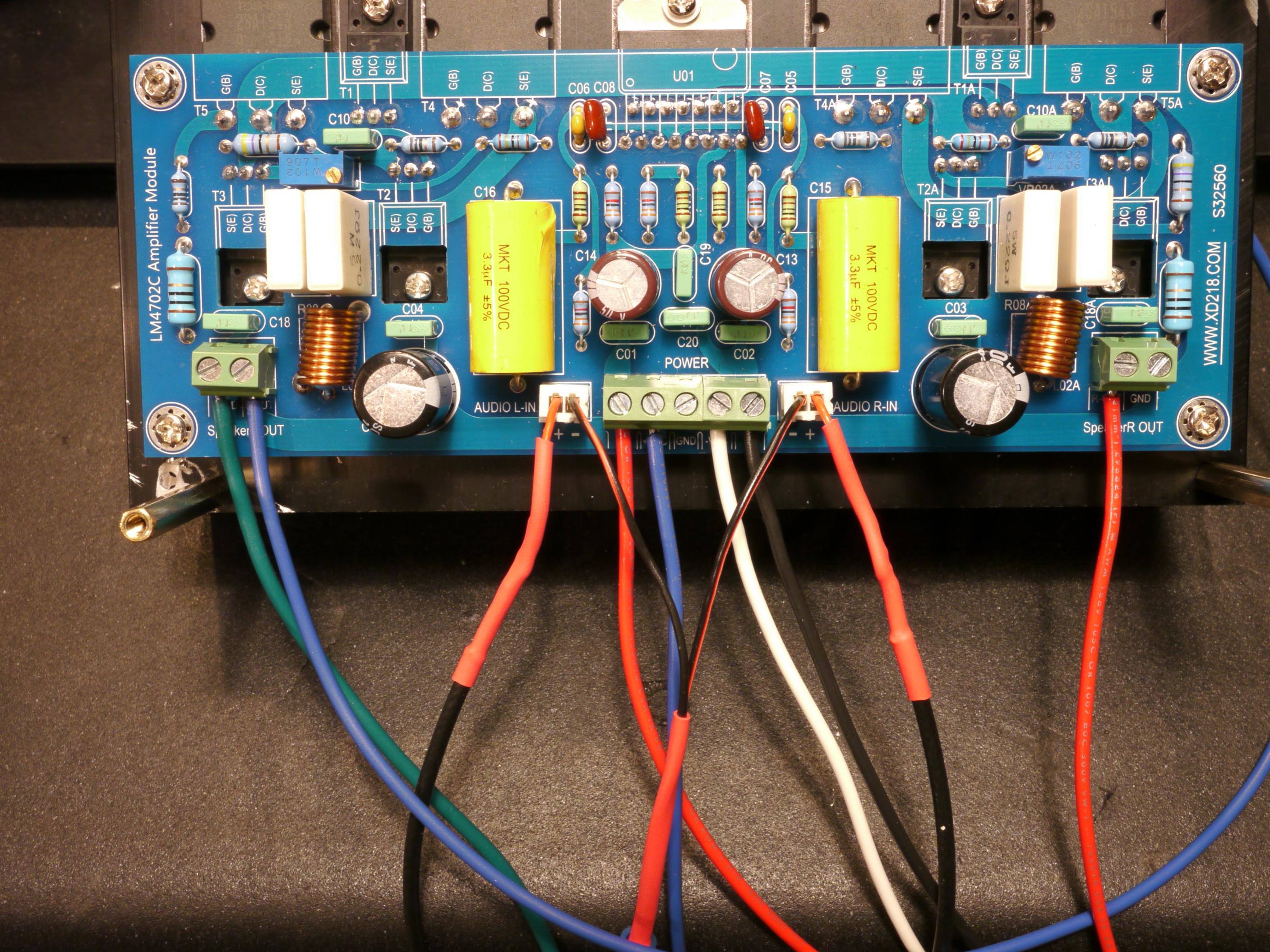

I've finally completed the wiring and testing of the amp module and speaker protection board. I've included a few photos below. Photos of the complete build can be found here.

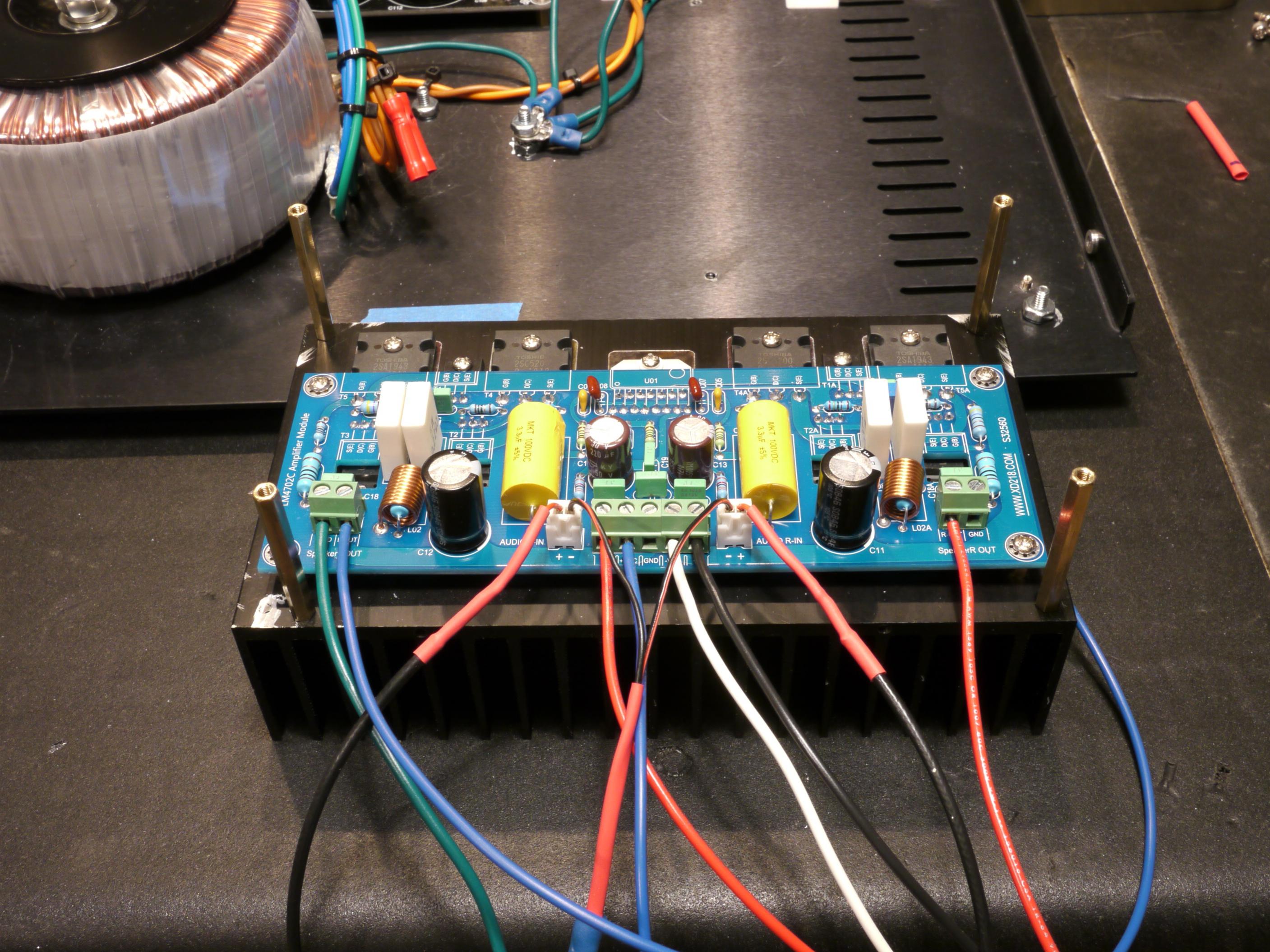

Since the last update I completed wiring and installing the amp module. This had not been tested before today. This module is being feed + and - 60volt rails (no load). I haven't checked the voltage under load yet, to see how the PSU is holding up.

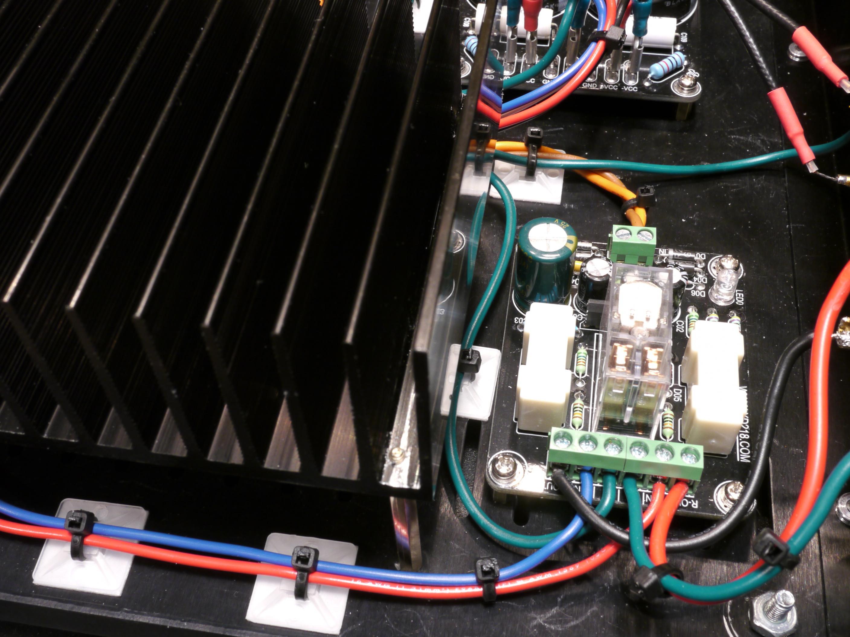

Once the amp was in place I finished the wiring to the speaker protection board, and the RCA inputs along with the output binding posts. I wasn't happy with my soldering job on the binding posts, because they are heavier then the RCAs and my soldering pencil just wouldn't cut it. Good enough to test, but I do need a heavier wattage iron, or even a small gun to get the required heat.
Soooooo... after everything was in place, all wiring double and triple checked it was time for the big test. Since I had fired up the PSU before, I knew the output voltages were spot on +- 60v. It was now time to test the amp module. In went the power cord, on went the switch and after I heard the speaker relay click there was no smoke to be seen! Not even a spark. 🙂
I then proceeded to measure the voltages at the speaker terminals. Both channels right around 3.4mv - give or take a tenth. I was pleased. I let it warm up for a few minutes and took another reading. Still very low and very acceptable readings.
So now it was time to hook up some speakers and give it a sound test. This is was what I've been waiting for! So, I hooked up some speakers, used my minidisc player as source and connected directly into the amp. Turned everything on, waited for the relay click, and voila. Pure, beautiful music. And the best part of it all - not even the slightest hint of any hum. I guess, good design, proper grounding techniques and meticulous wiring all paid off. Now I'm even happier.

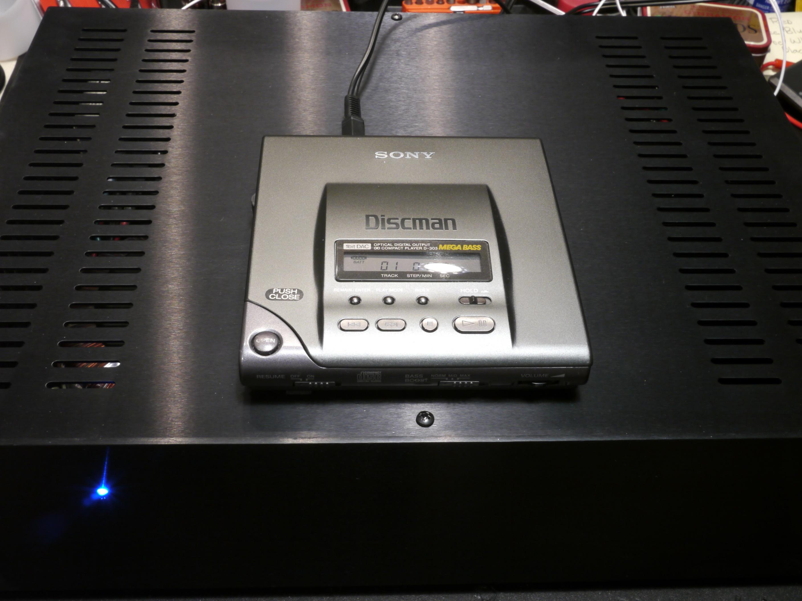

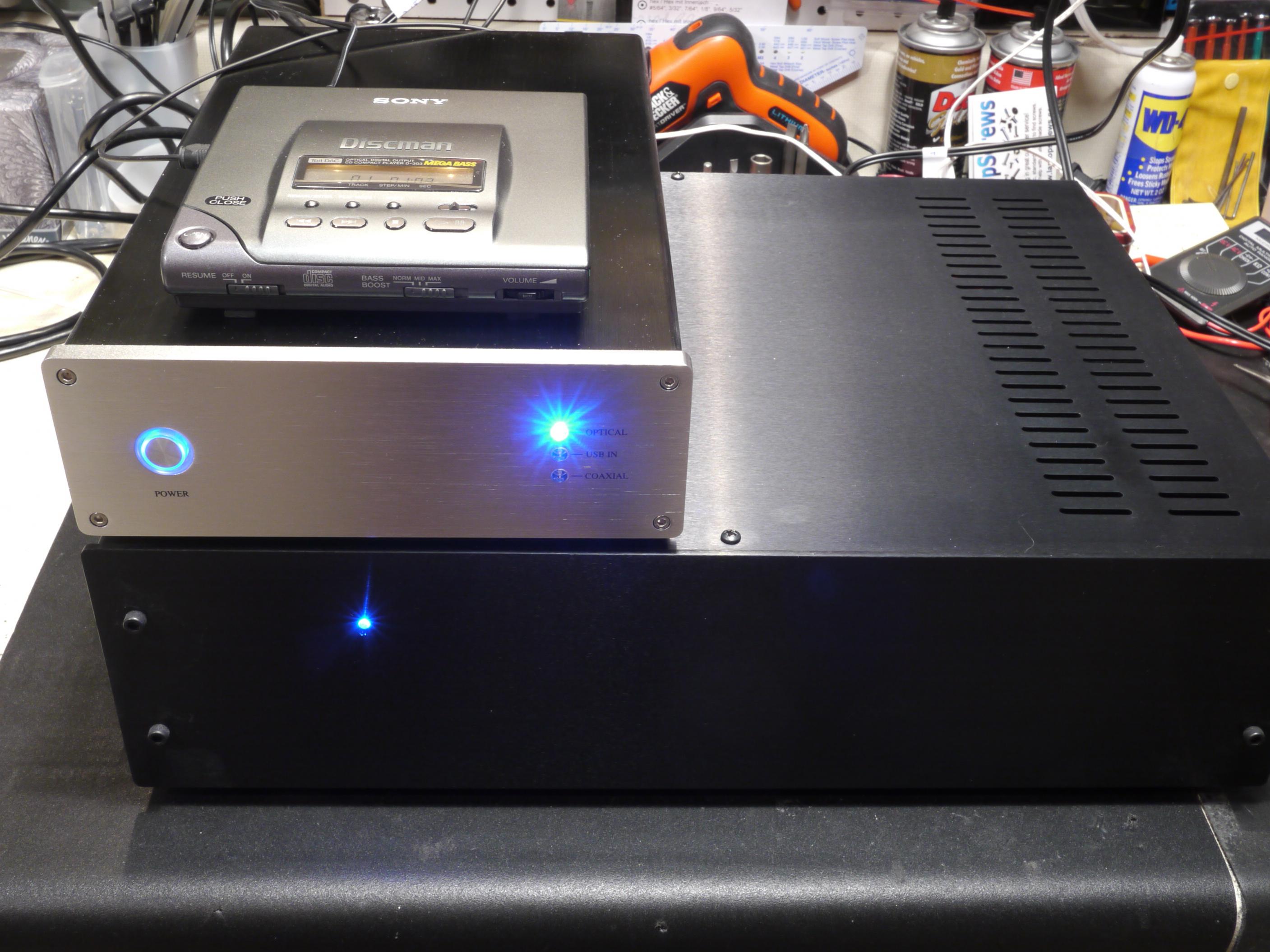

Hi all - Finalizing my build and wanted to include a few more pictures. The final wiring was to bring the power LED out to the front panel. Done! Now with the amp completed I can finally see it with the case close. Rather bland, but overall it will work nicely. I'm satisfied. 😀

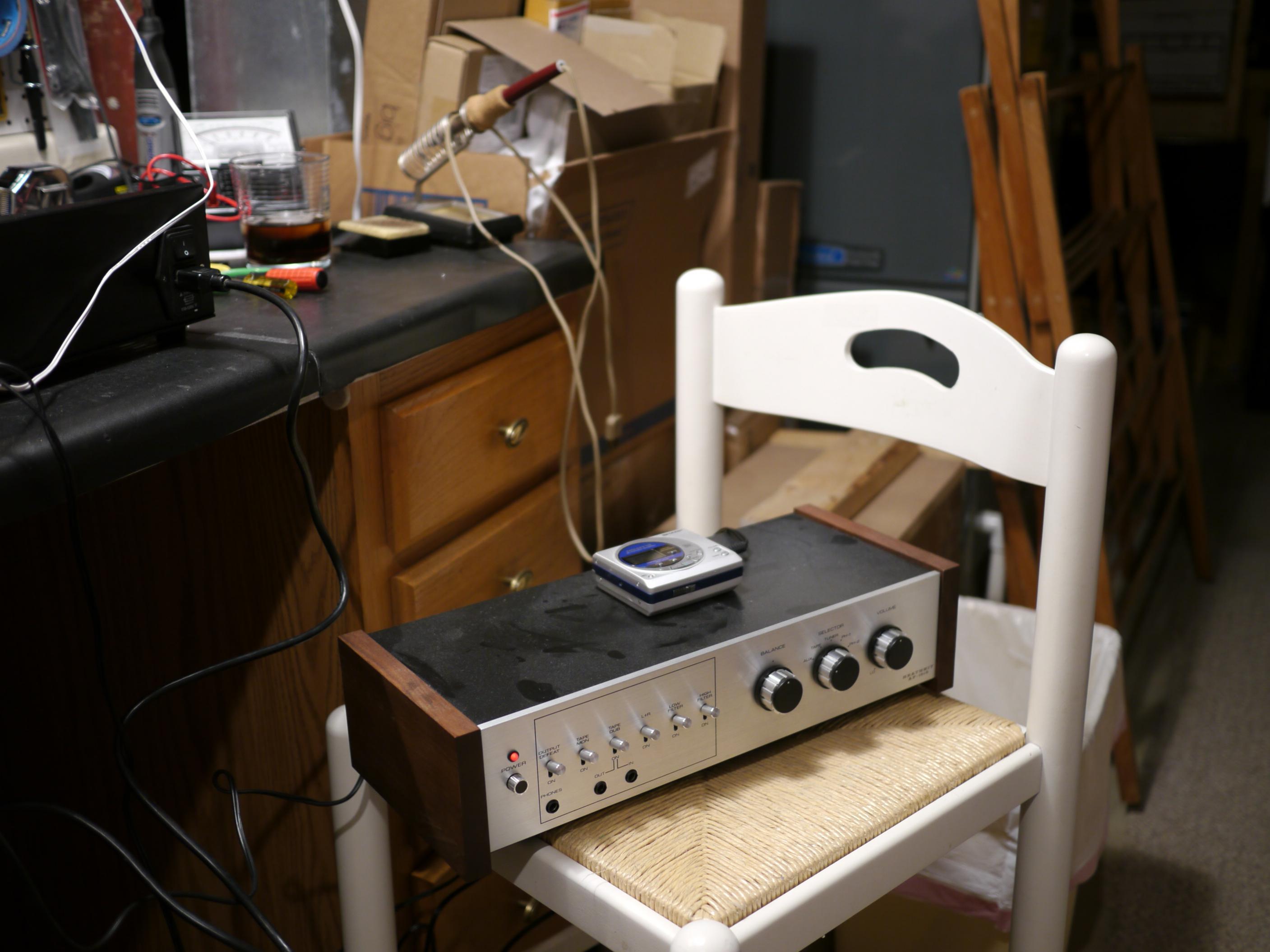

I did more testing the past couple of days and today I hooked up a new DAC unit I've built. I used the optical out of my aging Sony D-303 portable CD player. Not any critical listening per se, but wanted to hear a digital signal as the source input. I'm very happy with the sound. And I'm even happier that I can't audibly hear any ground loop hum. Even with several external pre-amps and sources I've tested with it, the amp is dead silent.

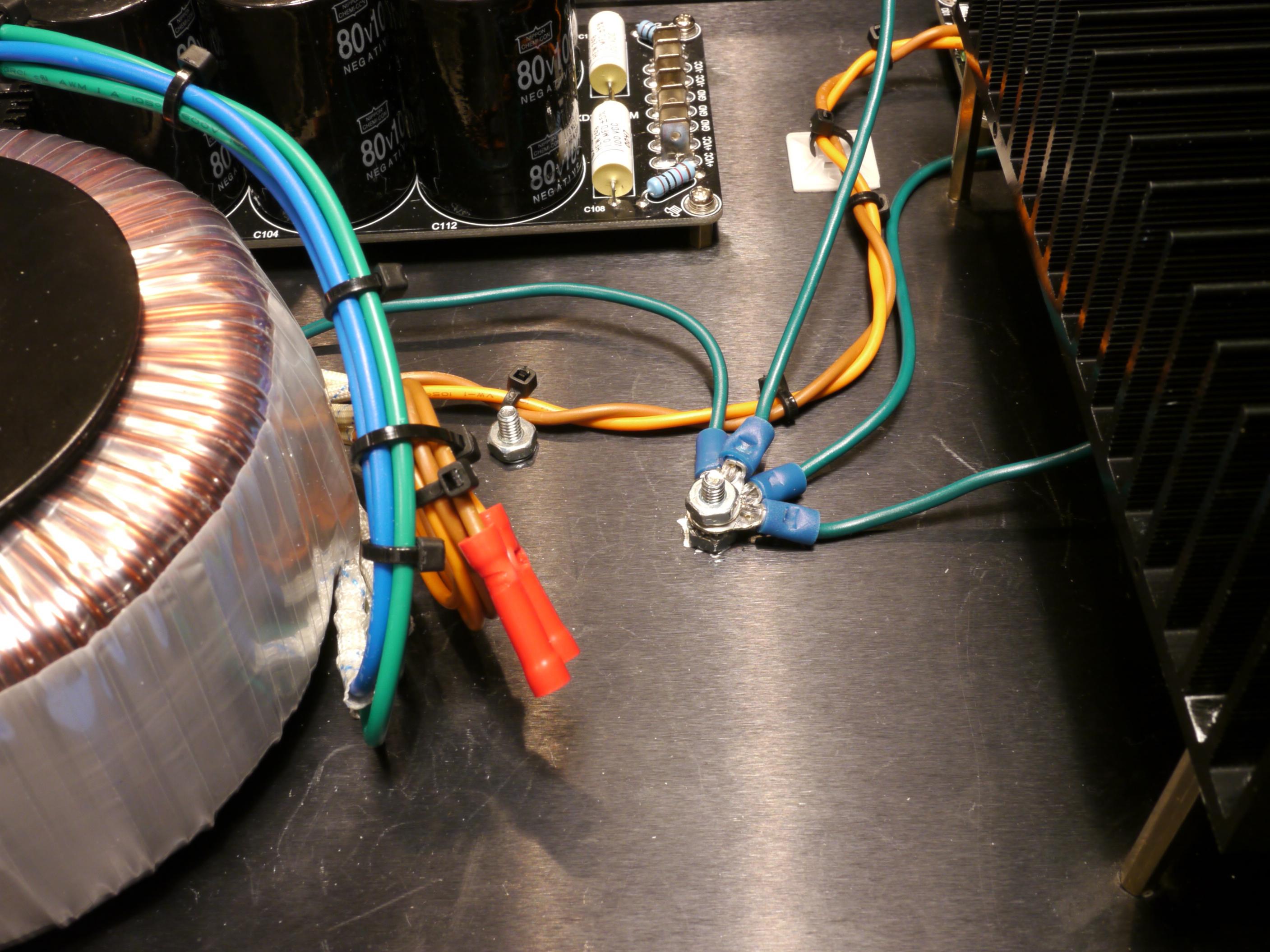

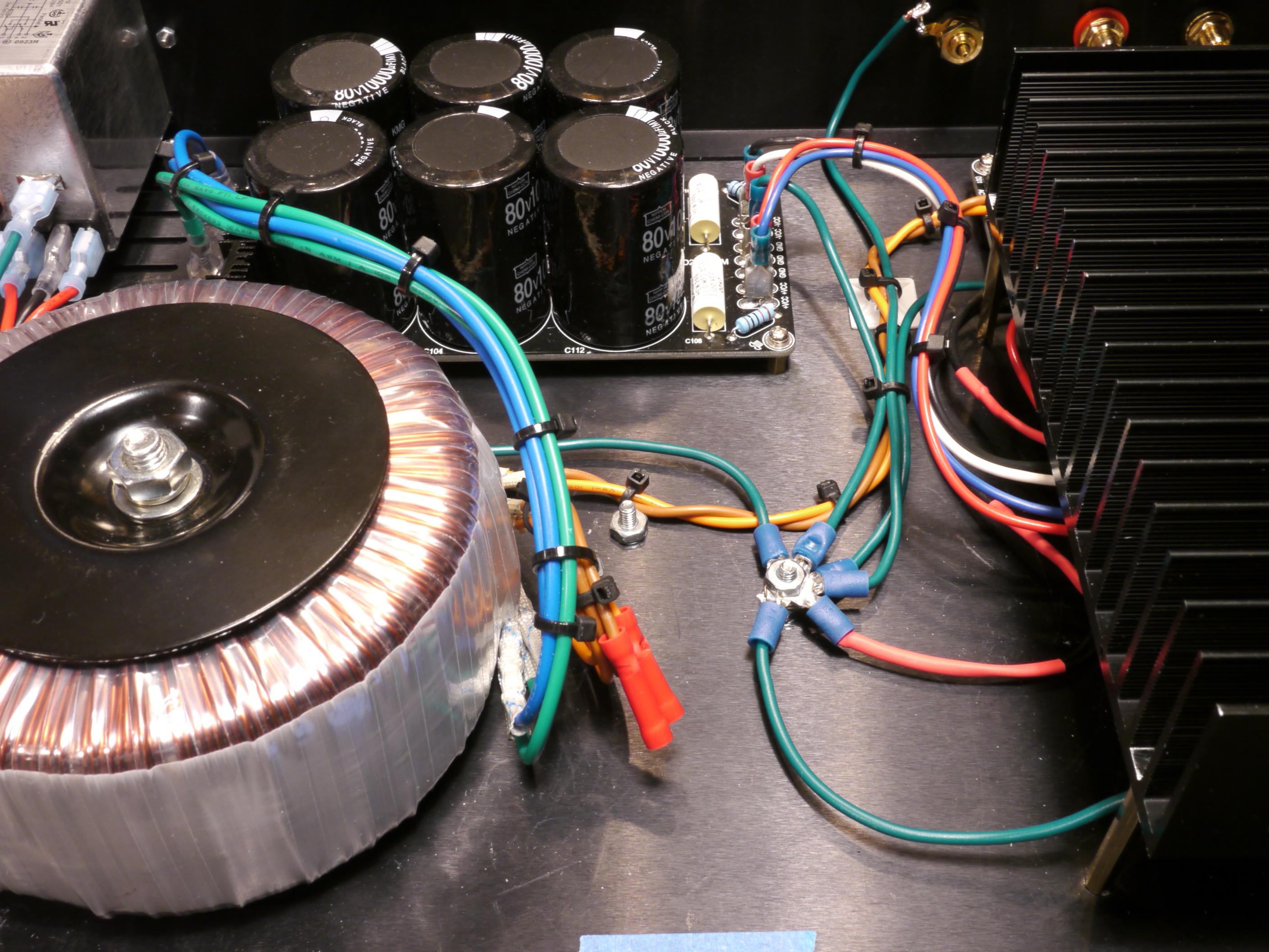

I later discovered I had a ground loop hum. Not sure how I missed that. 😀 It turned out to be how I had wired up the RCA inputs and how they were grounded. I re-did the wiring using both leads from the RCAs to the amp input connectors. I ended up using some standard unshielded, twisted pair from a CAT5 cable. This virtually eliminated all hum. Good results.
Redjr,
One of the green wire connections to the Main Audio Ground mounted to the chassis floor looks to me to be a link to the Mains PE.
That is wrong.
Change it.

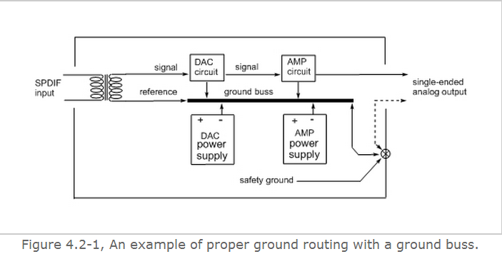

Question...
(1) At some point in the design and layout do all 'grounds' come together - either through a star reference point, star of stars, or buss arrangement - as Dave Davenport illustrates in his excellent article here? Is that a true statement? While his article covers the topic in a much broader sense, he does discuss grounding strategy within a single component.
And I quote,
"4.1 - Grounding Rules
Here are some rules to help you plan your grounding structure. The first four rules are from what we learned about interconnecting equipment.
Rule 1: Each of the following must be connected to the system star ground by one and only one route.
All signal references
All power commons
Shields of non-galvanically isolated single-ended inputs and outputs
Safety ground and chassis. The safety ground and chassis should be thought of as a single entity.
The connection may be direct, or indirect through a star-of-stars or buss. This is expanded upon below.
The safety ground and chassis may be connected to the system star ground through a Safety Loop Breaker Circuit.
The “one and only one” part of this rule precludes ground loops. There is no excuse for a ground loop within a single component....

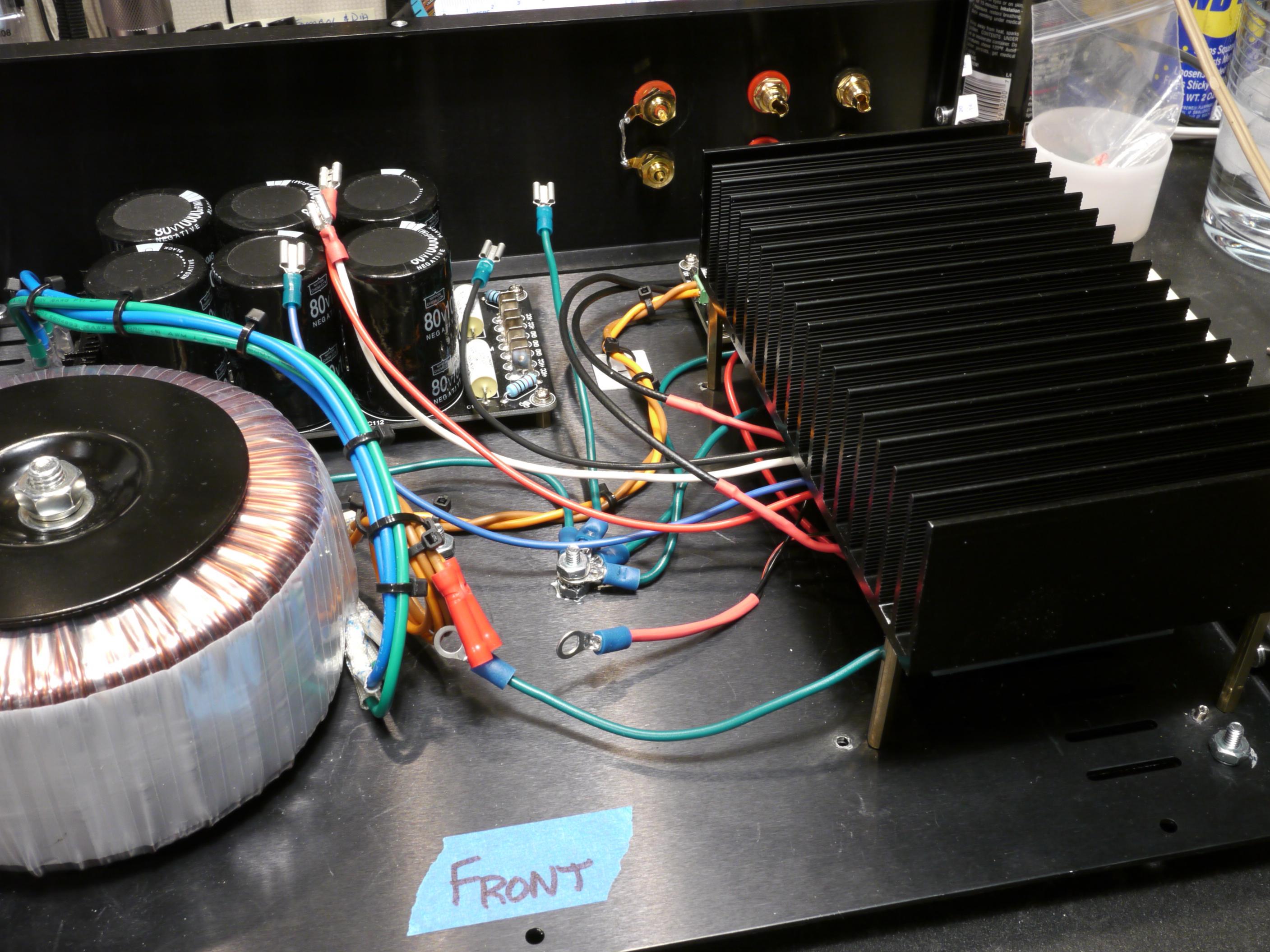

I have reworked my grounding strategy to help better isolate my PSU ground and audio signal ground. I'm assuming, because some terminology is loosely used, and Dave often refers to 'system ground'. Is this the ground path between the PSU, amp and other modules that may be inter-connected inside a chassis, and then tied to the star ground at a single point? My audio signal ground from input to the speaker out remains isolated on the amp PCB and speaker protection PCB. They are only connected to the star ground at a single point. I have virtually eliminated all detectable hum that I can noticeably hear, or see without using equipment. I did not employ a Safety Loop Breaker Circuit.
I have included a pic of one of Dave's illustration and believe my grounding topology supports this method.
The problem that appears to show in the pic is that the chassis to PE connection is mixed in with all the other returns forming the Main Audio Ground (MAG).
There is nothing wrong with locating the MAG on the chassis.
That is wrong.
It is the long PE to Chassis connection !
I see the Chassis to PE connection as a SAFETY connection and by my reckoning it should be a permanent fixing at the mains input socket. For lowest impedance it must be a short wire. It should not have any other connection tied to it, otherwise there is temptation to dismantle the "permanent" connection that is mandatory.
There is nothing wrong with locating the MAG on the chassis. It is the long PE to Chassis connection !
Ok. I understand what you're saying now. You are correct, there is a long green lead from the IEC connector (PE) to my star point. That's an easy fix. I can simply tie it to the chassis using a much shorter lead. Problem solved!
If you had a shorter length to the PE can you still connect your return points to the same point? My understanding of what I read in the grounding article is that you could as long as your safety earth to chassis point was secured under its own dedicated nut on the stud. I think part of the issue is that all of your ground points share the same securing nut. It is a safety issue, but should function the same?
I used a similar ground scheme in my amp. All my pcbs have star ground on board and one reference from each board to the chassis. These two references are connected to the ground stud above the dedicated PE connection. My PE ground is a third of the length of my other ground references. This is the method recommended by Peter Daniel. I have not looked at your pcbs but would hope they have a similar on board star ground.
