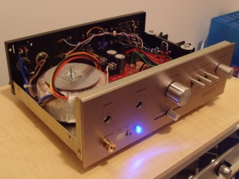

I put together one of the lm1875 amplifiers using your PCBs. I have gone with the basic setup to get things going and plan to add zobel etc. later.
Currently on each amplifier PCB I have the lm1875 chip, 22kohm on R2 and 1kohm on R3, and 22k on R4 for feedback, with 2x 0.1uf and 2x 47uf decoupling caps, that is all. I have jumpered C1, C2 and R6.
My DC at output is the same as at input! Power supply is fine, and signals pass via a 50kohm pot.
Do you have any advice on why the output voltage would be the same as the input?? Would I have blown the chips?
Also, there is a buzzing sound near AC in the chassis, could be the transformer. Any input would be appreciated, thanks!
Ahh nevermind, I did blow the chips! Lucky I bought a few extras...
Amplifier sounds beautiful even when breaking in. Using a 120VA 18v toroid which idles at 20.8 (as specified by manufacturer) this is ideal for my 6ohm speakers. The input is inaudible with volume turn down and barely audible at full volume! This is a very satisfying build.
Just a thought, bass is a bit thin, I increased the lower frequencies in foobar which is balancing the sound nicely, perhaps a slight increase in filter capacitance is in order, what thoughts on this?

I have exactly the same problem as swin1, DC on output is the same as the supply DC. Fully populated amp board except for jumpered R6. When I jumper R6 (input & output ground?) the DC on output disappears but there is NO output at all. Removing the optional components makes no difference. I think my only mistake was initially using a 25-0-25 toroid (now replaced with 18-0-18) which may have been too high a voltage and fried the chips? I have spare replacements on the way but I'm dying for answers in the meantime!
