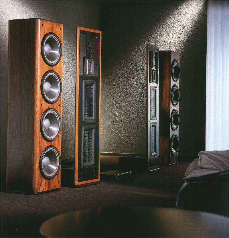

when it comes to the look of dipole baffle, I very much like this infinity model
