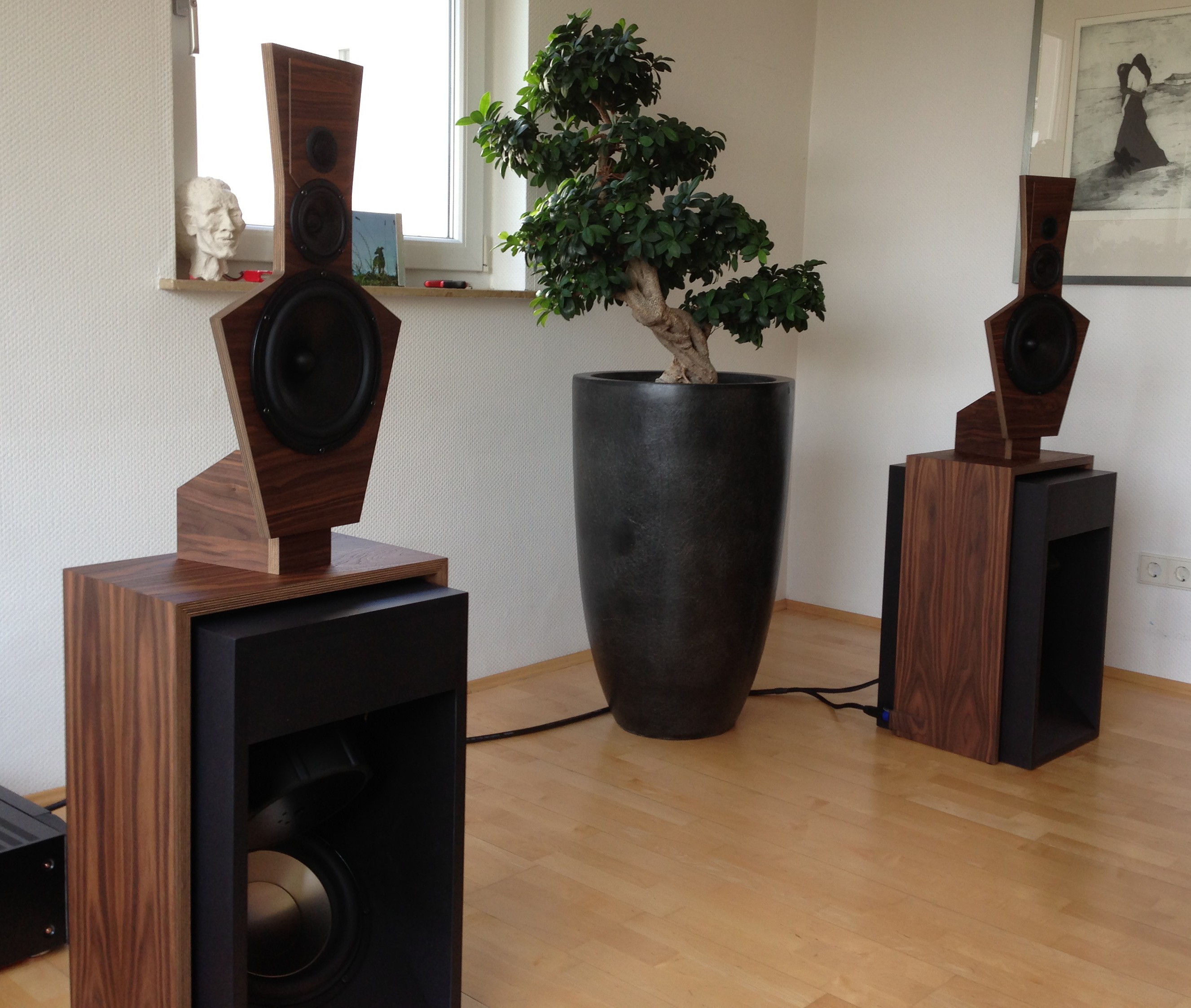

I am in the process of building the 2nd pair of LX521's in Singapore... certainly in the 5th-10th pair in the world I am hoping.
All parts are almost in hand...some caps and resistors yet to land in my hands here, but drivers and wood all sourced. Boards and plans in hand. Time and effort now required to get them done in the next 2 weeks I hope.
They have been built for a while now....
http://walaneh.com/LX521/
BEAUTIFUL .

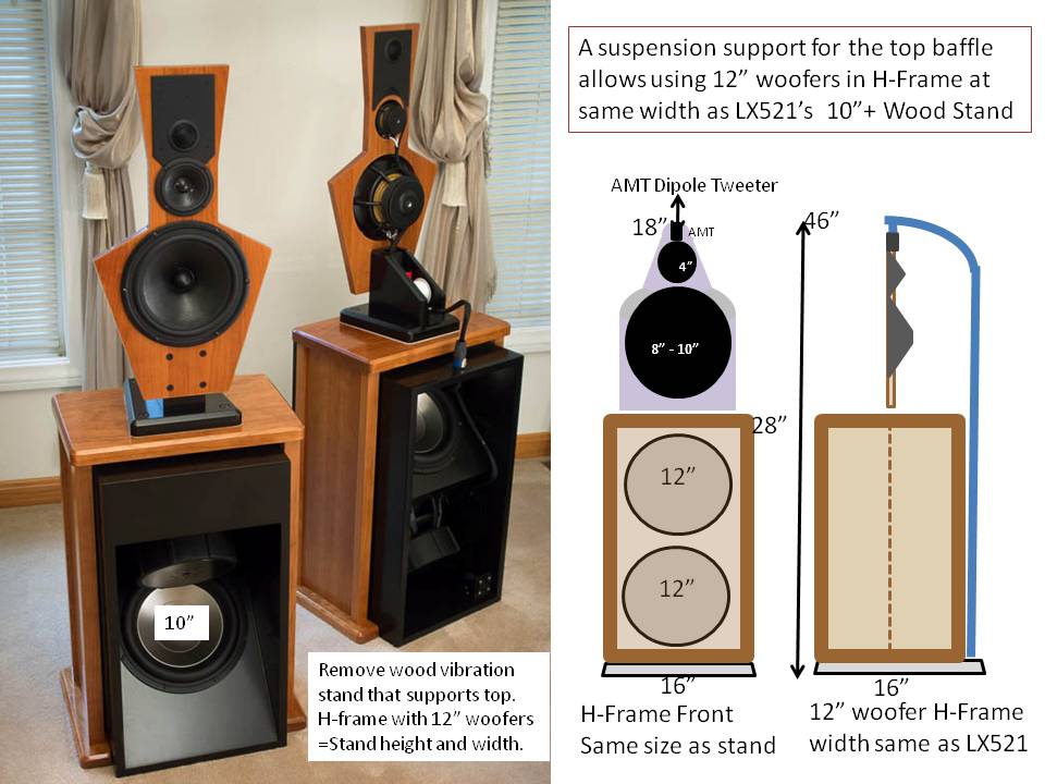

A few European dipole speakers engineers favor a rubber/spring shock mounted mid-tweet baffle, since it isolates vibrations. A variation of the LX521 that uses a suspended mid-tweet baffle in order to use 12" woofers in the same volume looks very efficient.
Is anyone evolving the LX521 to include a rubber/spring hung mid-tweet baffle?
The dipole world needs a modest cost AMT tweeter.

That's a really good-looking build! On the AMT there are some (relatively) reasonably priced units out there- it's not as if you need much bandwidth in this context. The BG Neo 3 shouldn't be underestimated in dipole configuration either. It sounds a bit less sparkly than some other tweeters but it is actually very good at presenting detail and a sense of space in a relaxed, unfussy way. For the bass end I would recommend the GR Research 12" drivers with the matching plate amps. Really outstanding sound and high output for a dipole bass system.
