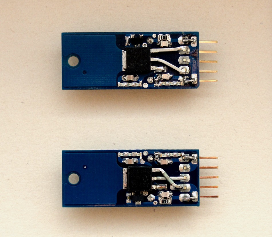

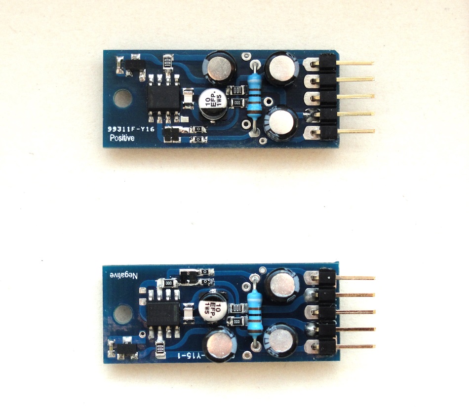

> With your permission, can i redesign it using SMD?
I am 10 days too late in replying (was not watching), but 6 months earlier with the SMD design.
(Jan knew about this since day 1.)
These first prototypes are now fully tested, and will be given to Jan Didden tomorrow. :)
There is also a simpler version (designed but not yet tested).
Same size PCB (14.5x36mm), using TO220 sized pass devices.
SO no soldering of the pass device onto PCB required (not for beginners).
Patrick
I should add that I took the liberty to change a few things to suit my own use.
So it is not identical to the published version from Walt and Jan.
Hope they wouldn't mind.
Amongst others :
Voltage reference and zener are replaced by Panasonic SMD LEDs (3 in series)
Higher resistor and lower capacitor values for RC filters (to allow this size)
JFET input opamp (15V version uses OPA1641).
2x 2SK209BL degenerated to 3mA as current source for V_ref and start-up bias
Pin-out's are 78xx / 79xx compatible, with (optional) additional pins for output and ground sense.
Patrick
I don't mind you soon the work;). I am sure yours would be better option, regardless. Thank you for providing it. I may still may do a higher voltage version using opamp Jack suggested. Been looking at other options, but nothing jumps out. Really want to try it on a rIAA stage.
We did it for ourselves, for fun, for the challenge. And I posted just now only to show you how we did it.
It was not too easy to fit everything in this footprint, and still have a large (unstuffed) pad at the back for heat sinking.
We have no plans to sell them if that was what you were suggesting.
It is not our intellectual property.
I did promise Jan an article for Linear Audio Vol. 7 on these though.
Maybe he'll give away free PCBs with the book ?
Patrick
