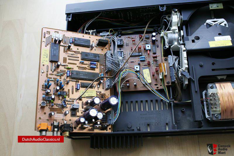

The Mission PCM2 is based on a Philips CD670, not a CD371 or any of the other models you listed tiefbassuebertr. Gliddofglood, give me a PM if you want me to email you the CD670's service manual.
Andy's comments are right on topic, this is the first thing I would check as well. The servo board is located right in the middle of the player, largely obscured by the mainboard which sits above it. My blog has a post about the PCM2, see the link under my post.

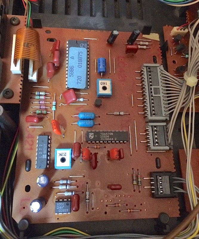

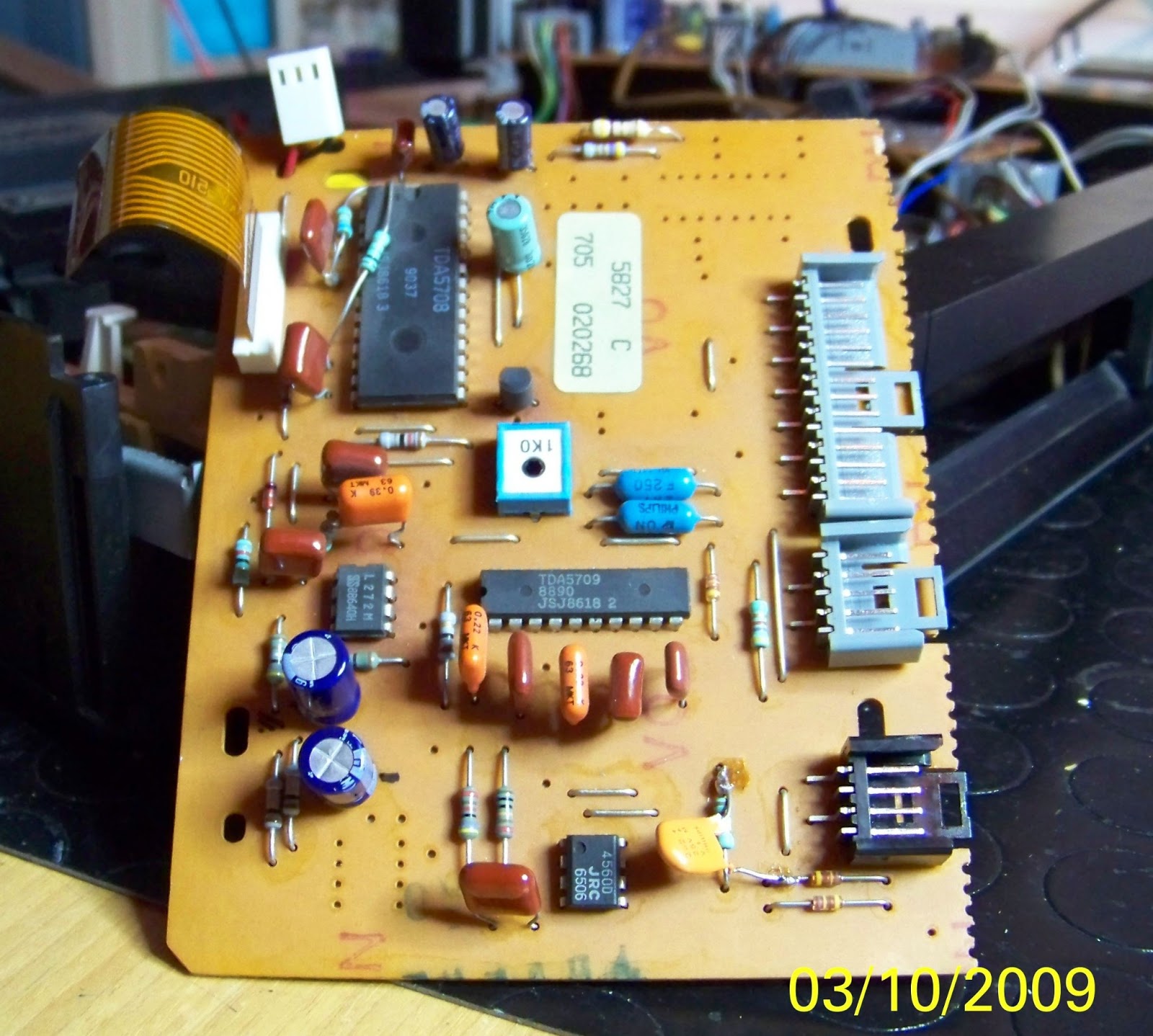

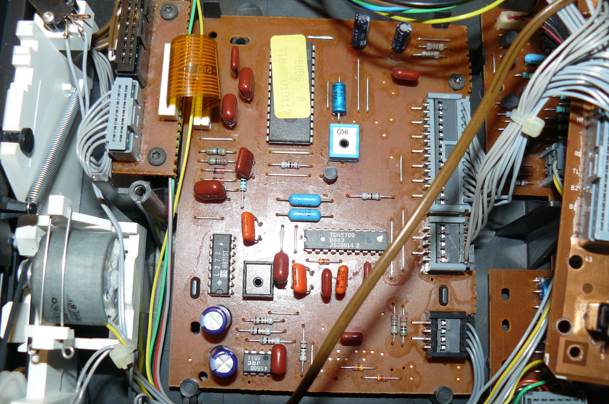

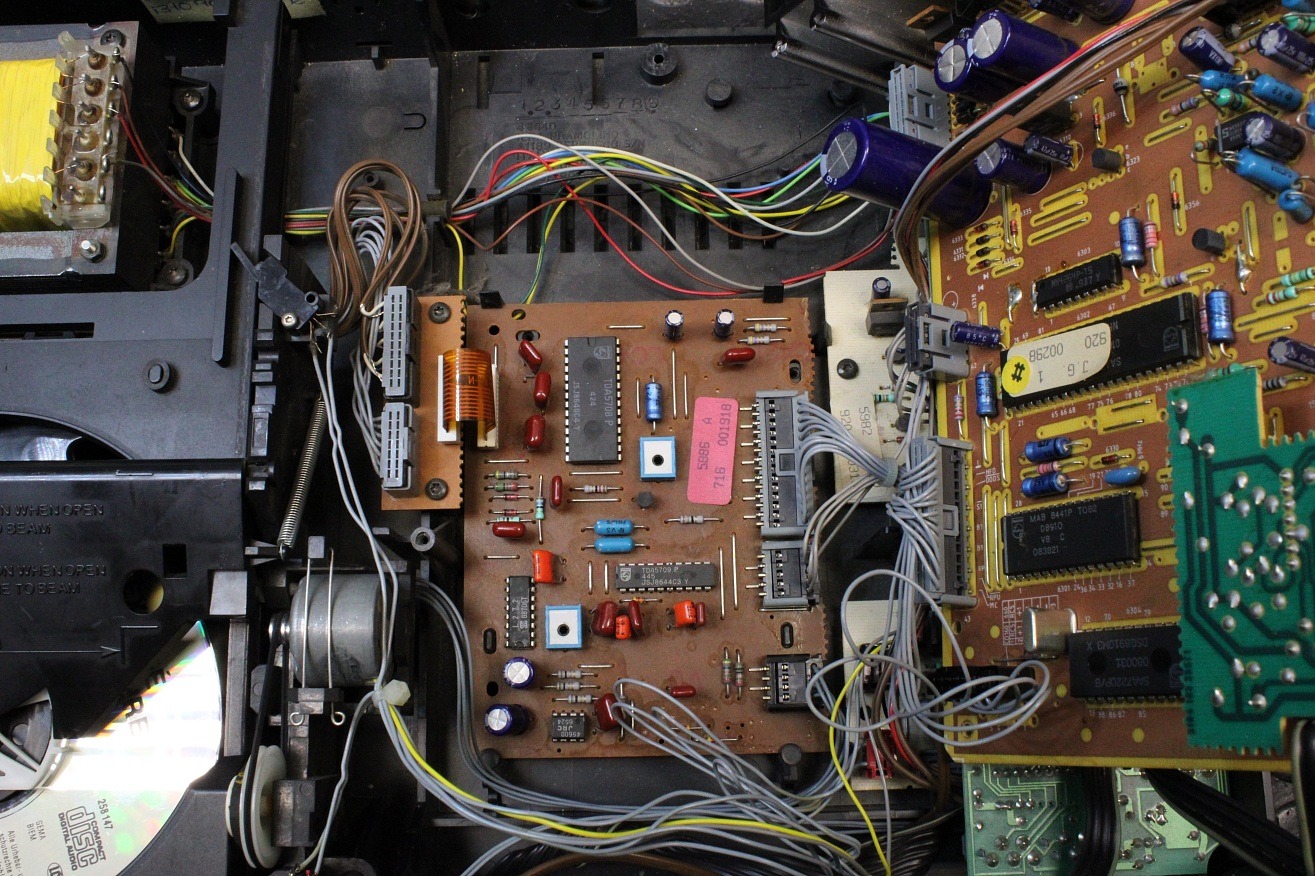

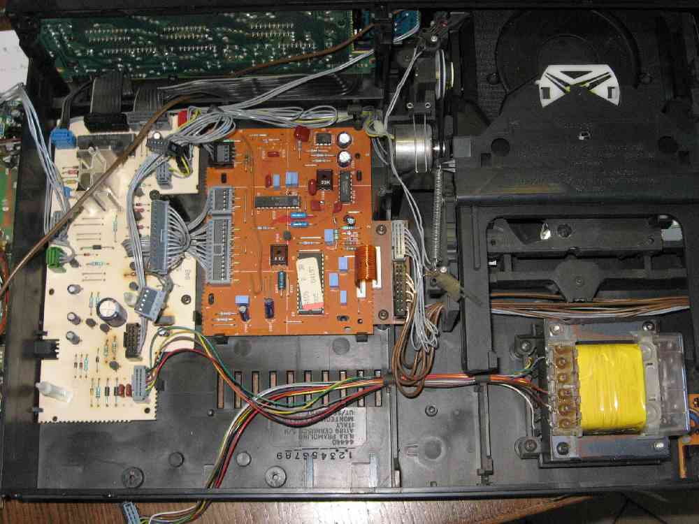

Main problem for buying a Philips as spare part reservoir ist the fact, that both Mission PCM-II and Philips CD670 uses different servo boards (and thus different CDM versions) - go to the attachments and check out labeled sticker on the TDA5708.The Mission PCM2 is based on a Philips CD670, not a CD371 or any of the other models you listed tiefbassuebertr. Gliddofglood, give me a PM if you want me to email you the CD670's service manual.
Question for me is, what service manual I need from Philips concerning the obviously most used servo boards "5886" and "6105"
According image No 6+8 under
http://www.lampizator.eu/lampizator...undig CD-9000 cd player with tube output.html
Grundig CD9000 use also the servo board 5886, but for the CDM-2/29.
But Philips service-manual "CDM-2" mentioned only the servo board versions 5725, 5768, 5826 and 5827.
Maybe there are various supplements.
Thanks for any advice.
P.S.: here was the PCM-II envelope replaced by a metal version - check out the images
