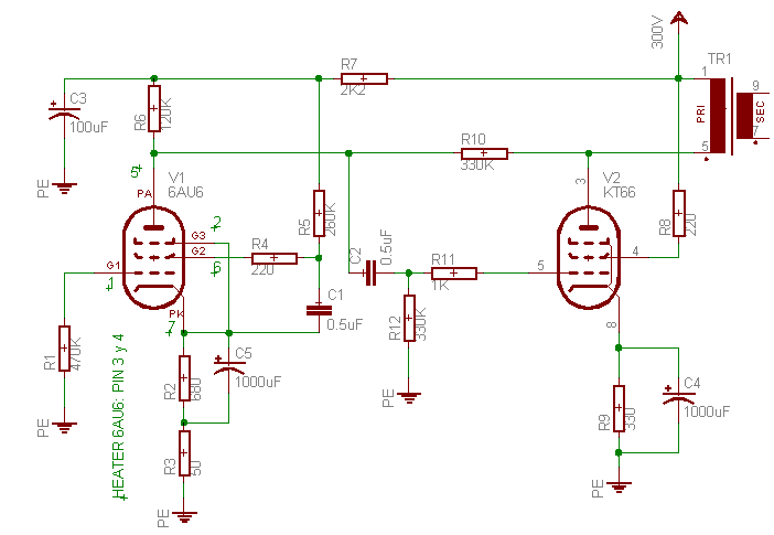

I tried various amounts of gNFB. 20db(v) gave a very solid statey sound that wasn't any better than the Big Box SS amp I was using for comparison. That lasted for a few minutes before I got that out of there. 12db(v) was a little better, but not by much. 4 db(v) added the necessary clean-up, and definitely helped woofer damping. With a good, low distortion open loop front end, which I have, and decent OPTs, you don't need a whole bunch of gNFB since there's nothing grossly wrong that you need to cover up.
Any suggestion about the values of Rk, Rg2 and Rp for a clean input at 1 volt?
Dropping C5 will lower input sensitivity, and as a bonus increase the effective resistance of the driver tube which increases its effectiveness as a V-I converter.

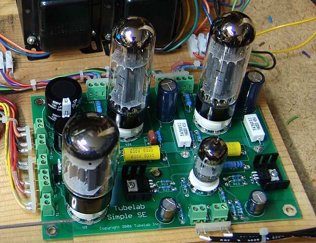

How about this one, instead of some old dusty curcuit - should be possible with KT66
http://www.tubelab.com/SimpleSE.htm
Yes, the KT66 power tube works fine in the Tubelab SSE. I use the new Russian production Genalex KT66 in
mine and am very pleased with it. The SSE can also be operated with 6L6, KT88 and EL34 power tubes by
using suitable cathode bias resistors.

Ah, but time does allow some of us to be able to learn things like basic SPICE simulation.
I put the circuit into LTspice and saw that open loop, the amp as presented has extremely poor frequency response, with a severe roll-off of high frequencies. Add the negative feedback and the high frequency response is restored. So, rather than being a somewhat linear amplifier that has been made better by adding loop NFB, it relies on NFB for flat frequency response.
Wouldn't it be better to design a basic pentode SE KT66 (or 6L6) circuit that performs passably well, and then add the NFB to make it perform better?
Or is the drooping open loop frequency response intentional, and necessary for proper closed loop operation of the circuit?
PS - Tubelab SSE and SE use a triode first stage, not pentode.
KT66 in tetrode (post 1) is not very linear, more than subtle correction is necessary.
