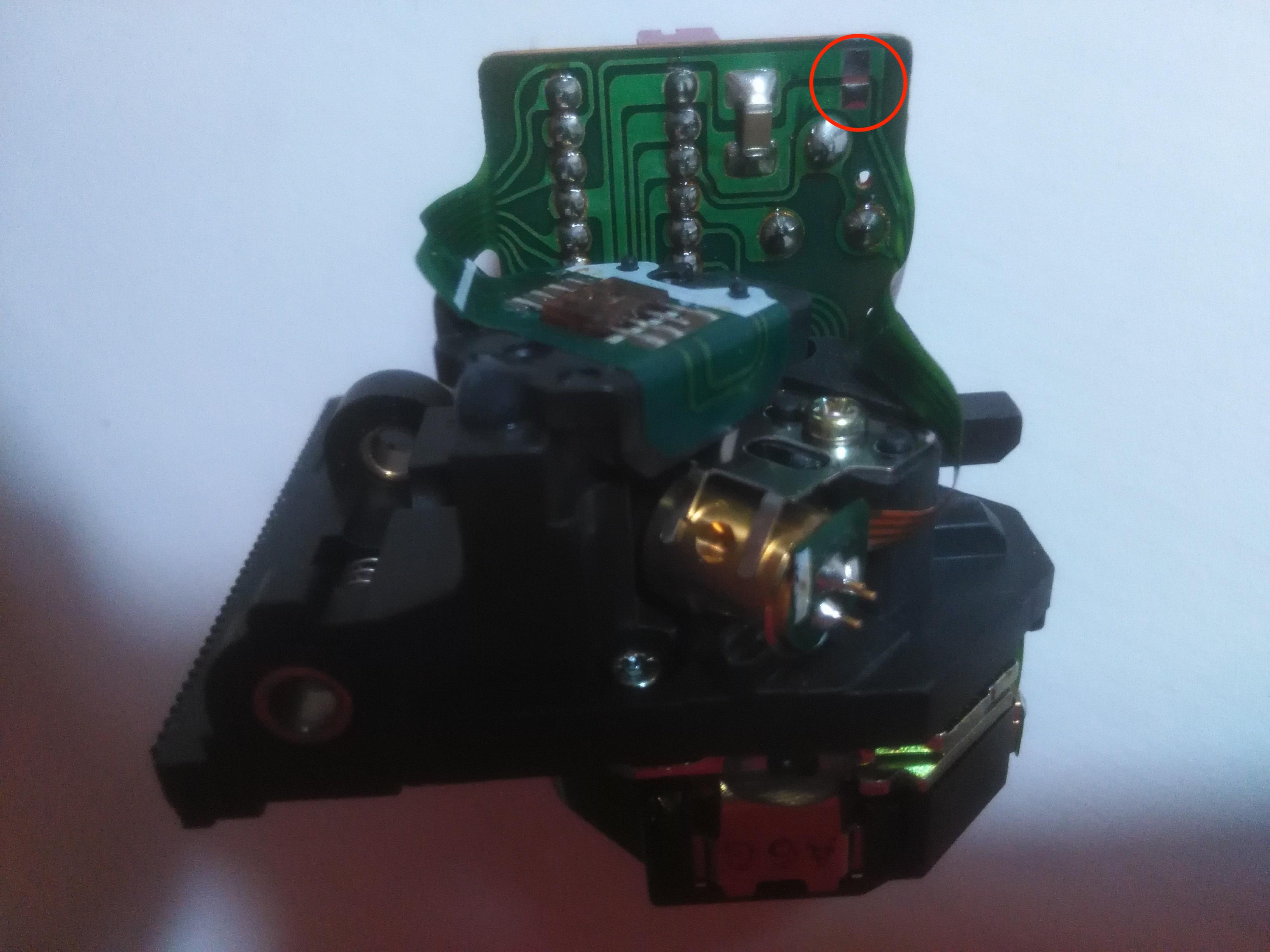

I looked for the red light in complete darkness and, yes, I can see a tiny red spot blinking with the old laser unit, but NOT with the new ones.
Regarding the anti-static solder blob, I am attaching pictures of the old unit (left) and one of the new ones (right). I have circled the removed blob in both. I have checked the open-circuit with a multimeter.
While taking the pictures, I could notice that both units have slight differences, even they are both KSS-210A. Could the ones I bought be just lousy quality??? I got them from a german vendor through Amazon (12 euro). I saw another one from Sony (27 euro). Should I buy the latter??

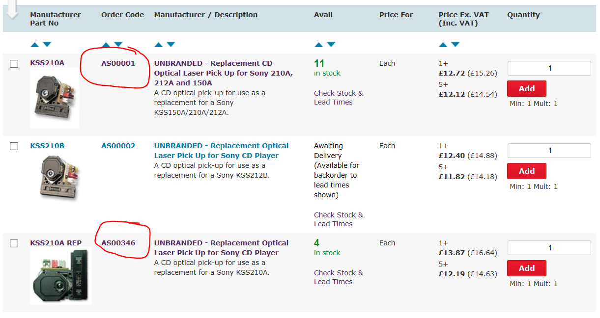

Certainly sounds like there is an issue with the replacements because the light should be visible no matter what other problems there may or may not be.
The 'Sony' you have seen is pretty much certain to be a generic replacement and not manufactured by Sony.
We used to order these by the dozen years ago and never had issues:
http://cpc.farnell.com/unbranded/kss210a/cd-pick-up-sony-210a-212a-150a/dp/AS00001?st=kss210
Check out official suppliers of spares in your country rather than looking on Amazon and Ebay.
http://cpc.farnell.com/search?st=kss210
