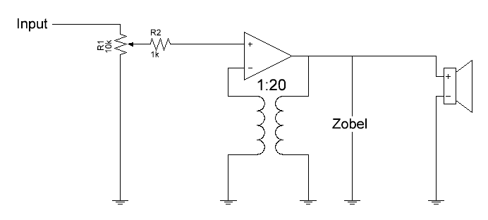

What about this? I cant find a real life version of this but I am unsure why it shouldnt work as long as we keep the phasing correct. Its a stepdown transformer that would help the amp perform at 20x gain. Yes its more expensive. Lets look past that.
Uriah
If that transformer doesn't get up to at least 4mhz, I suspect that you'll need to add some caps (probably RC's) that will work at least up to the highest pitch the amp may do.
There's open loop gain in that area, so it will take some care. For sure it will sound different. Just using a multi-turn cermet trimmer sounded better to me than a resistor on the negative input to ground leg of the gain voltage divider. This is a bit hard to explain, but I propose that it was the epic gain at that locale that has made resistor differences more noticeable.
Question: I notice that there's a little blue cermet trimmer on your LDR driver board. So, I wonder, ironically, if you've tried using that type of trimmer instead of the LDR??? It might not be as good as an LDR but it will probably beat a film resistor! 🙂 I tried the 10 turn 1k model at the radio shack; and I connected one of the outboard pins to wiper to use it for a variable resistor. Sounds great and the thing is adjustable. 🙂 That was. . . a bit easier. 😀
