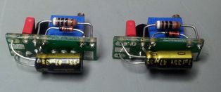

diyldr – AKA Uriah Dailey – has been teasing me for months with information on a newly developed LDR based mod for the well-known and highly regarded BrianGt amp from Chipamp.com. It simply replaces the input resistor and is quite easy to build and install.
The PCB measures just 23 x 8 mm and uses 7 components to create a tiny power supply on a tiny board with pads to attach to the LED legs of the LDR. The size of the unit allows the builder to install it in a variety of positions related to how the BGT amp is mounted. In these pictures short leads was the goal.
Here’s a link to an information page - https://picasaweb.google.com/udailey/ResistorReplacer. There are some more pictures of the modules I built as well as a hook-up template.

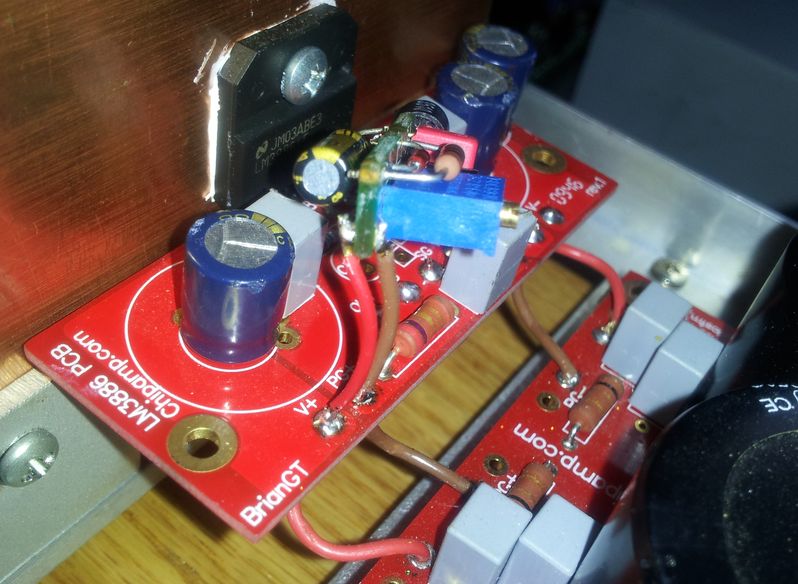

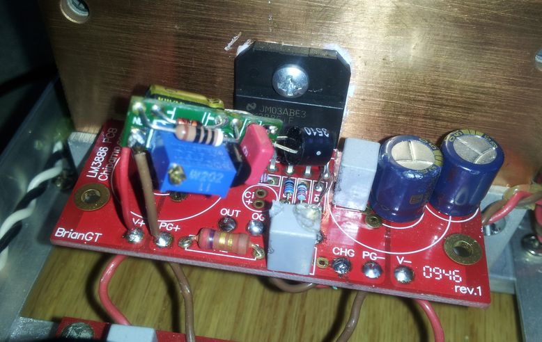

The BrianGTs sound like a completely different amp with Uriah’s new module. They have long been my second favorite, and if I had never built anything else I would have been quite satisfied with them as my system core. Only after hearing the MyRefs did I notice they were a little forward/pushy. On some jazz and pop music, that characteristic can be very enjoyable to my ears. IMHO, I hear the stock version of this amp to be in the same family as BP-150s as great devices for simple builds and high quality listening.
Initially I installed the RR in only one amp for A/B comparisons. The clarity and detail improvements were outstanding. As with the two Haflers, the modded BrianGT exhibited what initially sounded like a bit less low end, but with more time I understood it was actually better balanced and controlled. To investigate any SPL differences I used my Radio Shack level meter with the second track of the test CD. Both peaked at 84.
After installing the RR in the second BGT, all the promise of a new and improved presentation was realized. Just about all the elements – clarity, definition, depth, width and balance could be heard. One would not expect such a dramatic improvement (to my ears) from such a simple, elegant and easy to build modification. I still want to push the new setup with the LighterNote, but I’m currently in the process of re-calibrating it.

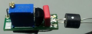

Bob, thanks for linking me to the thread and thanks for putting it up.
CanAm Man, LDRs just sound better than other resistors. Its not about varying the resistance its about replacing the resistor with an LDR. If you read the Lightspeed or Warpspeed or DCB1 or ZenMod's LDR B1 threads you will find a lot of folks who hear a sonic improvement with LDRs replacing potentiometers. I figured thats just a variable resistor so lets try replacing regular resistors with them. In my tests they sounded markedly better than any of the high end resistors I bought to compare them with. I put them in my BrianGT chipamp and the improvement was significant. I sent them to Bob to see if he heard the same thing and this thread is a summation of what he heard.
The schematic of the amp doesnt change at all. We still simply have a 1k resistance on the input. This time instead of a Dale or whatever, its an LDR. Silonex NSL32SR2.
I posted the schematic in my Picasa album that Bob linked to. Feel free to build one up and try it. If you decide to do that I will help you with any questions. Would love to hear your impressions.

This is an interesting use of LDRs, thanks for posting it. In passive attenuators such as the Lighspeed the LDRs are used to replace a potentiometer for the following reasons:
a. Potentiometers generally have poor tolerances.
b. High quality potentiometers cost a good amount of money.
c. Potentiometers include moving parts that can oxidize over time causing connection issues, some people theorize this leads to a rectification effect.
In your use you are replacing a precision resistor that has none of the above issues, it's very interesting that you report an improvement in sound quality. Any thoughts on what characteristics of the LDRs make them sound better?
I hadn't run across the LM334 before, might have to buy a couple of those to play with some LDRs I have sitting around.

I received my resistor replacer kits from Uriah today - although I could have done them on some vero board, I went for the kits from Uriah because they are pretty neat and small. One of mine had to fit into a fairly tight space, so I thought it would be a good idea. Plus they cost buttons. 🙂
Anyway, I soldered them up, hooked them up to my bench supply and adjusted them to 680R. No problem with this, although the resistor/zener does get warm (@30V supply). I wasn't expecting much of a difference - I had kiwames in there from Peter Daniels premium 3875 kit. I'm surprised though, there is a positive difference. I think its down to slightly better resolution. Soundstage seems more defined and wider. I thought maybe the bass was a bit deeper too, but now Im not convinced on that.
Seems like a very well worth while experiment, I'm glad I did it - plus now I can vary that resistor over a wide enough range to change the gain, without having to think about buying fancy brands.

This resistor replacer can be used anywhere that 2.5V or less is across the resistive side and where the resistance is 40R-10k. Probably should really only be 40R-5k but depending on the precision needed you could go up to 10k and wobble around by about 5% on average. You have to determine if thats okay for your application.
